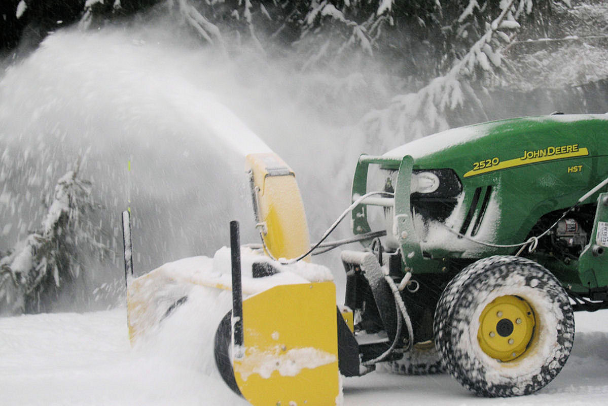

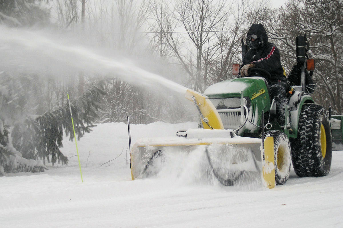

Since we have had very little snow this year, unlike the mid-Atlantic states, I finally got to use my new 54 inch blower on the 2520. Prior to this week, we had received no worthy snowfalls. I did have it out a few times, but there was very little snow. This time we got about 9 inches (average) and it was fabulous!
While I have nothing really to compare it to, it has been wide enough so far to clear a path for the 2520 and makes clearing trivial. I would not enjoy clearing my drive with a plow or FEL as we have a lot of landscaping rocks that border much of it. The blower and more than a few edge markers make it a no brainer. If you plan to keep it, I cannot imagine you will be unhappy.
One note, if you do get the blower, I strongly advise getting the remote spout kit. It really makes a difference in distance control and can reduce the problem of the wind.
A couple picture of it in action...
Enjoy, Ray
