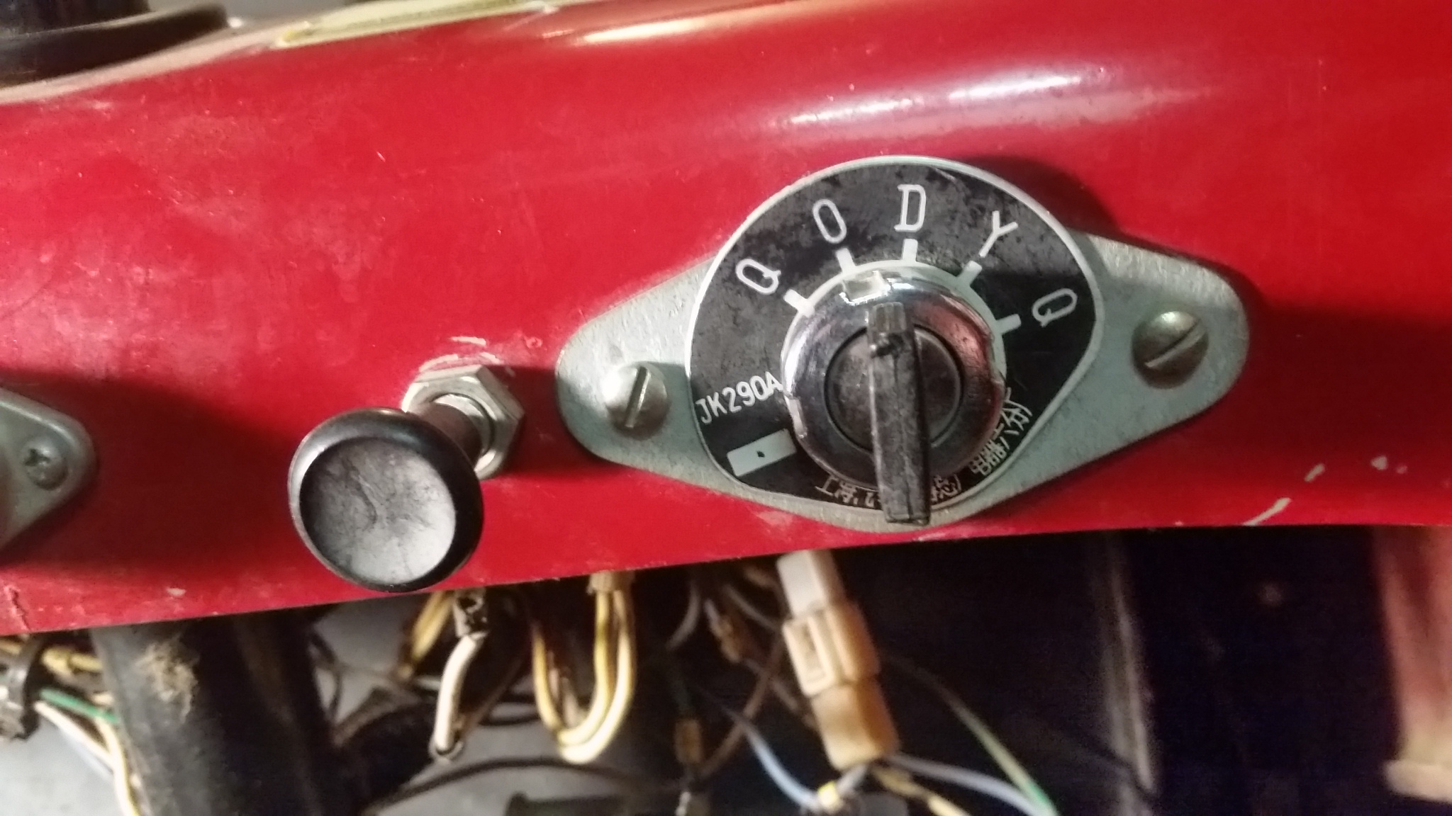

I have a 1987 Jinma 254 Tractor with the Y385 engine.
My ignition switch is working but I bought this second and would like to know what the characters mean on the switch bezel. I think it may be wrong.
See attached picture
Thanks

This is just a WAG but the "Q's" are in the right spot for the coil. The "O" is correct for off.
"Y" is for run/engine on, which leaves "D" for electrical on.

If it's like mine, Q is start, O is off, D is run and Y is pre-heat. You can start with or without pre-heat which is why there are two Q's.

Thank you Quicksandfarmer for providing the answer the OP was looking for.
