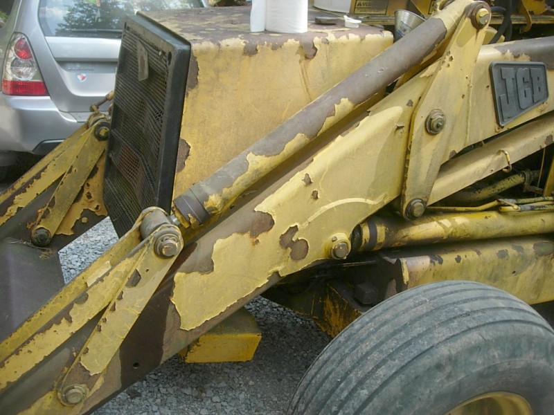

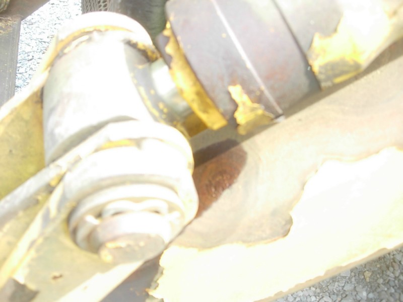

Here's two pictures. ONE of the cylinders that control the dump of my front loader bucket has just been discovered leaking.
On the first picture, you see what appears to be a shadow below the hinge and in fact, that's oil.
The last time I had one done (at JCB dealer) it was the cylinder for the dipperstick (it was the middle one, not sure if dipperstic cylinder would be correct name)
Regardless.... they repacked it and charged me about $800. I pretty much needed to change my undies when they gave me that bill.
So...how tough are they to do? I have EASY access to this one since it's right there. I'm thinking it has to be worth any cost to buy the spanner wrench and have at it, no?
If there's agreement that I can do this at home, my next question would be, should I do BOTH of them at once to get it done, presuming they are the same age or since the other one doesn't seem to be leaking, leave it be?
Any tricks to the trade on doing these? Just unscrew the end and "pull out" (as though I think that is actually going to be easy to do)
How about any tricks on putting the rod back in?
With the economy as it is...the VERY large surprise I got the last time I had this done, I'm willing to spend an afternoon full of sweat & oil/grease if it's doable by a home owner.
Though I'm not a mechanic per se, I'm very mechanically inclined and probably have any tool I'd need for this except for the large wrench.
Any thoughts would be appreciated.
Oh... just thought of this... any chance to do this ON the machine or should I remove entire cylinder first? (they're just so dang heavy)

The first thing to consider is to keep everything clean. I would use some Dawn detergent to clean all the oil/grease off the rod end, and have plenty of clean rags to lay things on. Although a hydraulic shop will have more knowledge in inspecting and measuring things, and might have on hand, the rebuild kits, but that is not to say that a mechanically inclined person can not do the job. I think several people have rebuilt rather large cylinders. You can do at last some of it while still mounted, such as taking of the end cap, and use a come along to pull the cylinder. Some people have used air pressure, but be very careful about this as it could come out as a missile.You could also use the hydraulics to force the cylinder rod out, but it might get messy, if you know what I mean. Perhaps two gal of fluid all over the place. You might see if the hydraulic guy might want some off time work to help you to remove and replace. I would read up on all the post about rebuilding cylinders. Good luck

I have only done one large cyl, but numerous smaller ones. As stated by
others, the hardest part is the unscrewing...the gland and the piston nut.
What I would do is loosen the gland nut ON THE TRACTOR. Most of us do
not have a big enough vise/workbench to hold the cyl well. When loose,
I would try to pull the rod out, leaving the cylinder on the FEL. Capture the
oil with a hose and bucket. If you can not pull the rod out manually, you
can use a come-along, as suggested. I have used air successfully, but as
JJ states, it is dramatic, so BE SAFE.
When you get the rod out, the piston nut is usually staked and VERY tight.
I have successfully used a rod through the cross tube and a truck or tractor
parked on it to secure it. You will need big wrenches, for sure. To get the
rod back in, sometimes you need a "slot filler" to get the sealing rings over
any grooves near the end of the cylinder. Sometime the new seals are hard
to get on the piston. Boiling them in water first may help with that. Save
yourself $750.

All of the above advice is excellent. You also need to remove the 2 hydraulic lines going to the cylinder to keep it from pulling a vacuum. You won't be able to pull it out with them hooked up. Once you get the rod out of the cylinder, Pin it back to the tractor where the top of the cylinder is pinned. Use that for a vise to hold the rod.
Once you get the rod out of the cylinder, look at the piston seals closely. If it has the chevron type (looks like a "v") seals, there are usually 2 stacks, one pointed in each direction. This is very important for the cylinder to work right.

Depending on the shop, $800 might not be a bad price. I know of shops that charge that much, but they re-machine the entire cylinder assembly. Does a homeowner need that kind of quality? No way.
Anyhow, sure a machine owner with some mechanical ability can do this. I would go invest in a good quality 3' pipe wrench, not some Harbor freight pos. Do not, absolutely do not boil seals. Most are rated for 212 degrees max. You can heat them, but do not boil them. Always heat them in some kind of fluid, oil or water.
Probably the first thing you want to do is extend the rods all the way out. Now, take your thumb and index finger and grab the rod. Keep your minds out of the gutter now because I'm being serious. Run your hand slowly up and down the rod feeling for anything not perfectly smooth. If you have a beat up rod, no sense in putting a seal in it. And, if they are sister cylinders, absolutely rebuild them both. It's kinda like having bald tires on your car and one goes flat. The other one still holds air but do you just get one? There's more theory behind it, but that's the simplest way to put it.
