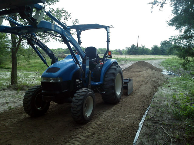

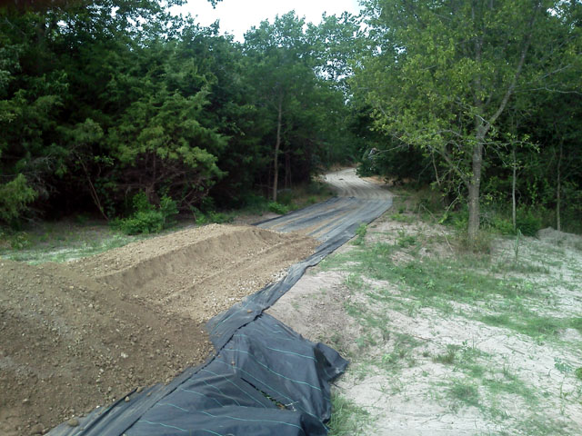

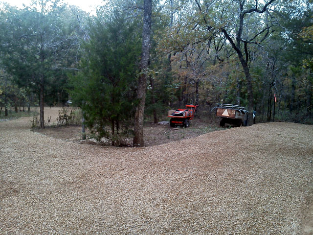

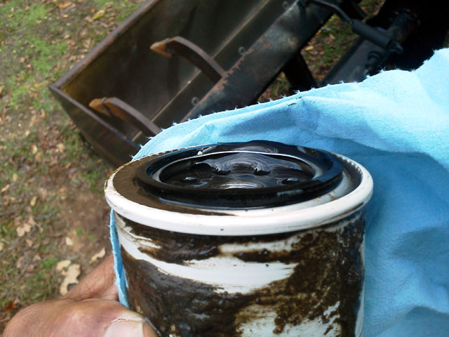

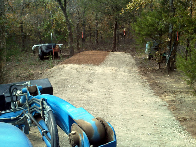

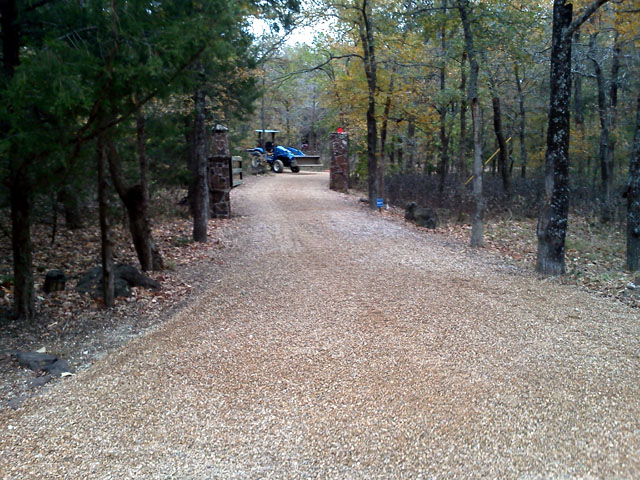

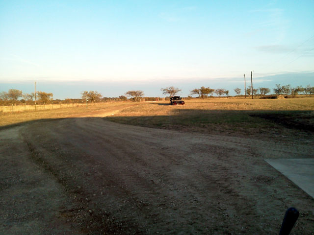

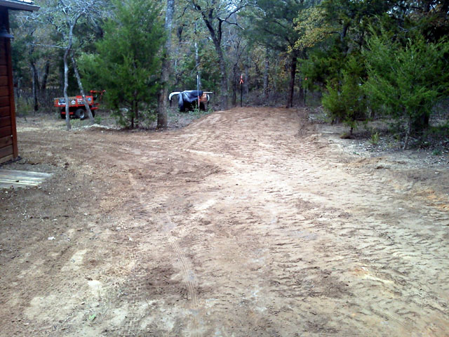

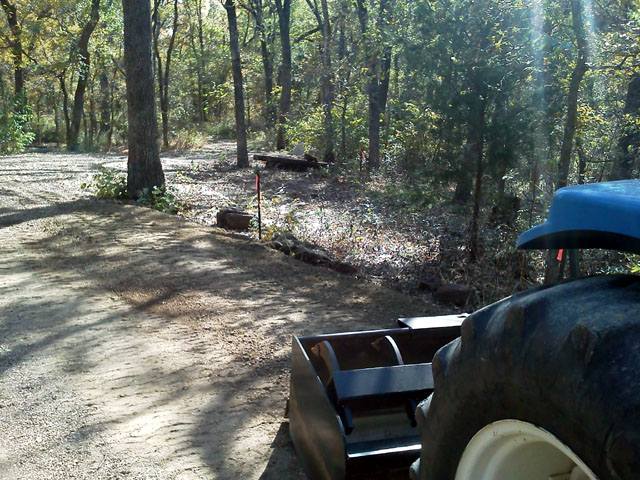

This is a first. Right after my tractor blew a hydrostatic hydraulic filter seal, the first thing I thought was...Jinman would appreciate this one! I guess the 29 degree start-up and then immediately backing off the trailer was just too much for it.

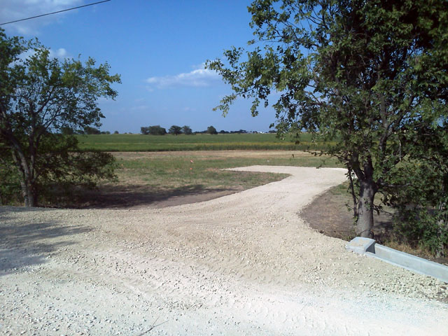

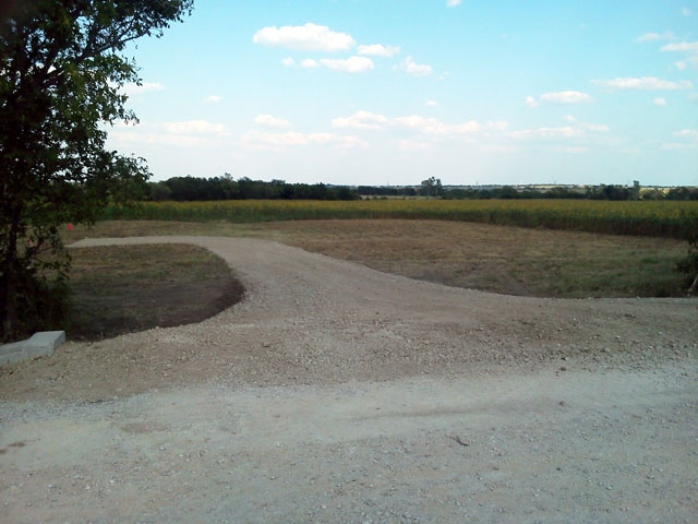

Worked on a new driveway, put in a couple of parking areas and widened the original driveway.
/ RDrancher's Photo Thread
#703

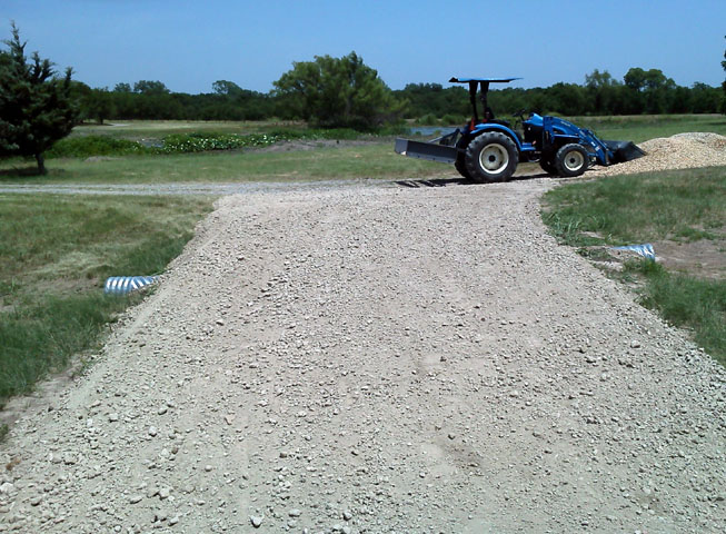

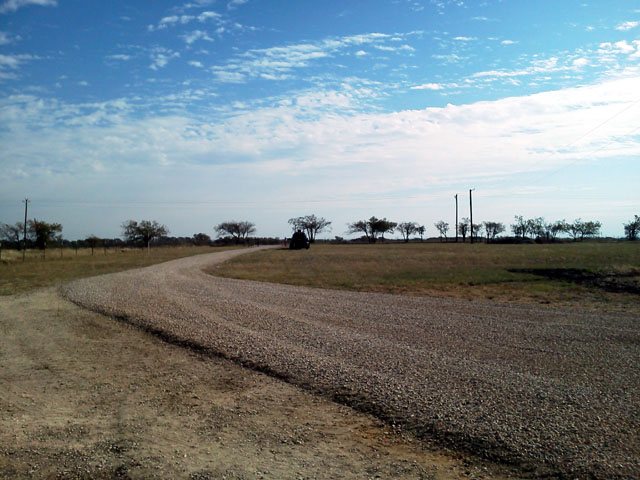

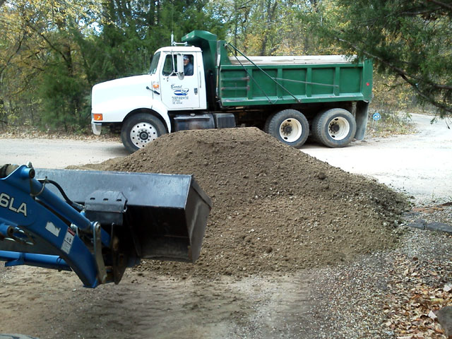

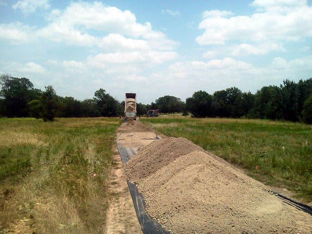

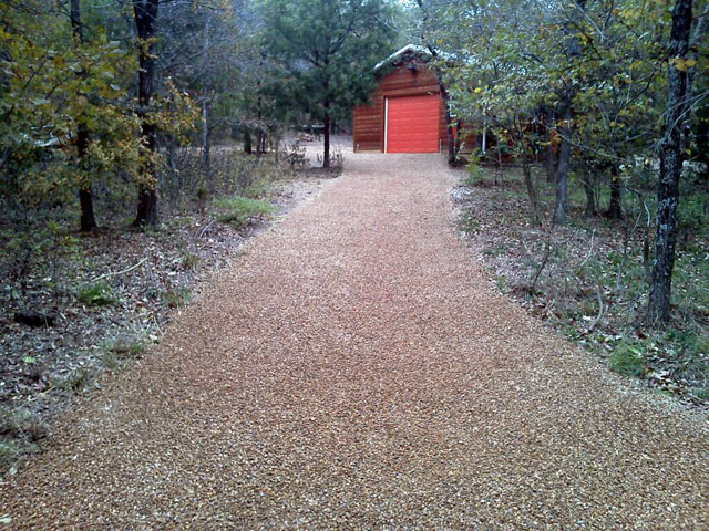

Access for the job was limited, so 10-wheelers only for material delivery. Luckily my suppliers yard is only twenty minutes away.

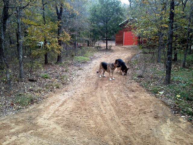

After I laid down the base, I topped the new areas with a brown/reddish peagravel to match the existing driveway and covered a few bare spots. Once the new material gets a bit of rain on it to wash off the pit slime, it'll be a perfect match.

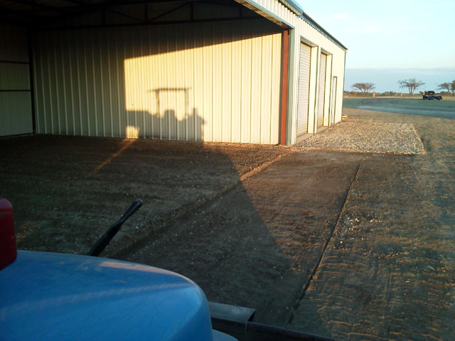

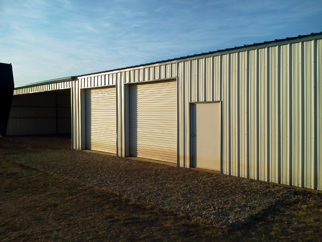

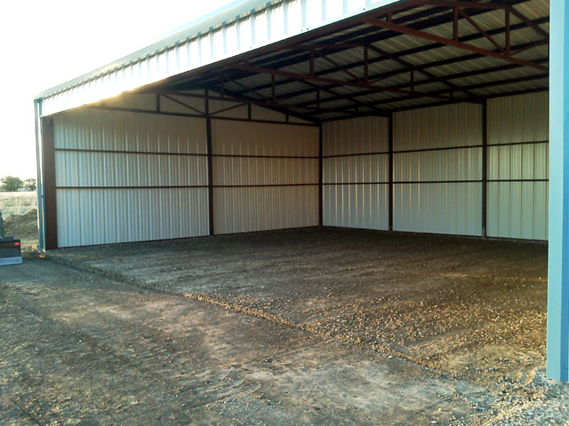

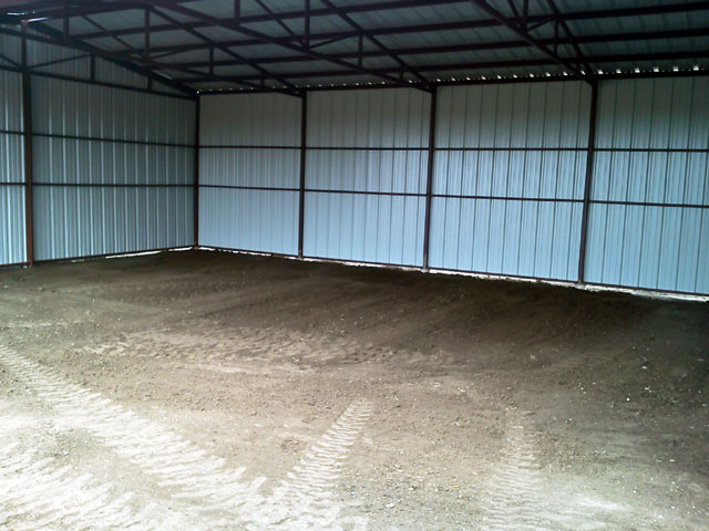

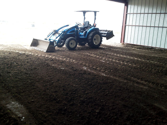

Here's a few photos from another job. I graded out the floor in this metal shop addition, placed concrete washout, then compacted and scraped it flat.
The homeowner used his tractor to scrape off a bunch of river rock and grass from the side of his existing driveway. My stepson pulled all of the grass out of the rock and did a nice job raking out this little approach.

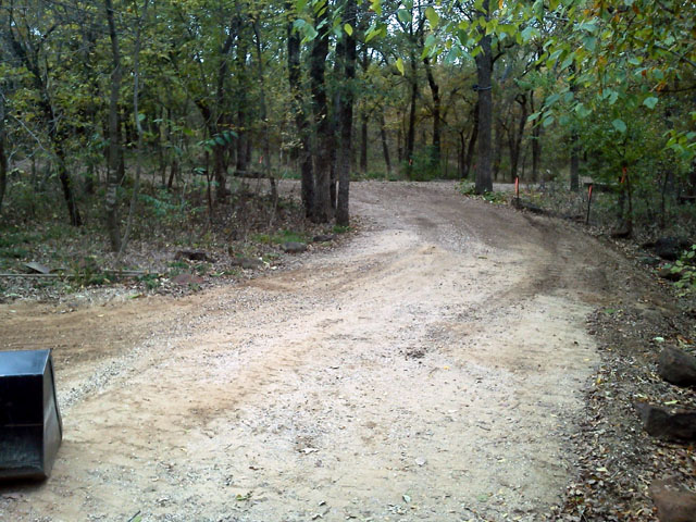

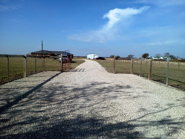

Same job. This driveway was covered with way too much river rock. Doing what river rock does...it was all over the place. The homeowner had me move the driveway over and widen it a bit at the concrete apron. I mixed some of the river rock in with a 6" thickness of concrete washout, wheel rolled it, then topped it all with 3/4"-minus limestone. No way to make the edges nice and straight on this one...too much excess river rock spread in the grass for that.
The homeowner will be spreading topsoil on the old driveway areas.

Run your PTO to help warm up your Hydraulic fluid.:cool::thumbsup:

Haha...I've been waiting for you to comment on that Murph. I've warmed up the tractor with the PTO running every morning since! :D

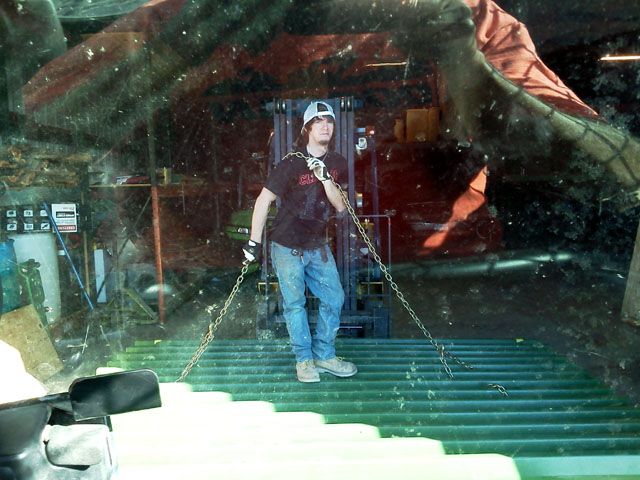

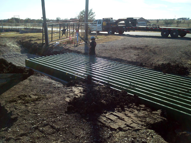

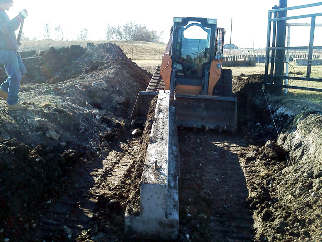

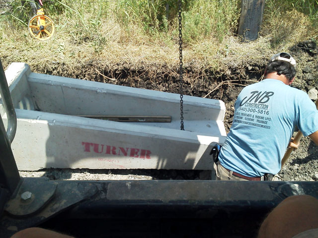

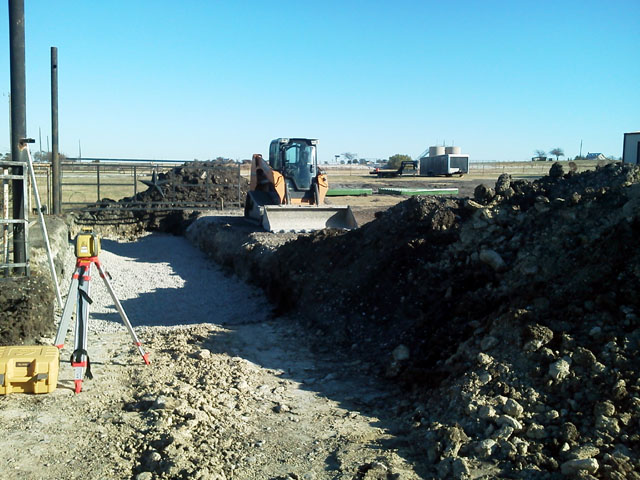

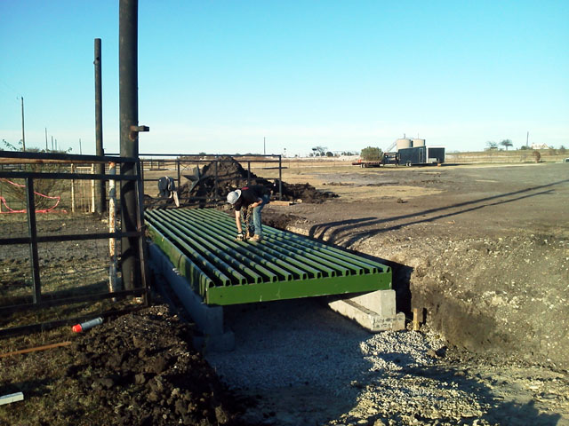

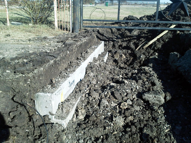

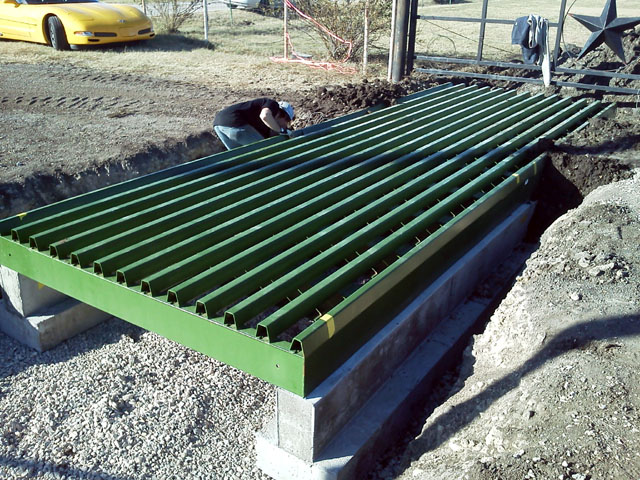

Here's a little change of pace. A local business purchased 34 feet of modular cattle guard, rented a backhoe, and had their guys try to put it in. After three days they got two 12 foot sections in, but they were 8 inches out of level and out of square too. There were several factors that led to the problems the guys were having. First, they tried to set the footers on black clay. And not their fault...but they were using a string level not realizing that the footers were slightly off on the top to bottom, side to side and bolt center measurements. To top it off...a couple of the footers were bulged in the middle. The grates had plenty of end to end adjustment built into them, but only 1/4 inch of play side to side. With the help of my stepson, we pulled the steel grates off, ranked out the footers and started over.

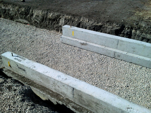

This area has plenty of black clay, but you'll find a yellowish rocky clay down a few feet that's a lot more stable. I found it only a couple of inches below the depth they had excavated on one end, but had to dig it down about five feet on the other end. Once I had the bottom of the trench packed in with a couple of feet of yellow clay, I placed 18 inches of 3/4-minus utility rock, set the grade and the first two footers.
W used a combination of the laser, string line and a healthy helping of good old "eyeball installed" to get everything set and lined up. Of course, we put the 10 footer between the 12's to make things look right.
I'll go out tomorrow to grade out the overburden. At some point in the future we'll get more gravel or sand in the center to fill it up a bit.

What does that actually do?
#715
Funny thing is...they bought the cattle guards to keep their dogs from getting out when the gates were open. Right after we finished...their Jack Russell walked across the grate. :laughing:
Most livestock will not walk across a cattle guard. They are afraid of slipping and breaking their legs. But some will walk across them as noted, and some will jump over them. I have never heard of trying to keep a dog in with a cattle guard. Let alone something as small and nimble as a Jack Russel terrier. I bet it would not work on a kitty cat either!:laughing:
