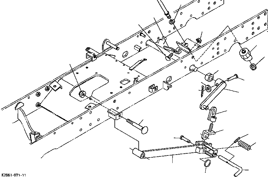

Just bought a bx2200. Adjusted so I can turn knob to top, but at 4, it cuts at 3 inches. From what I can tell, you shorten the front bracket to raise the front, but I cant for the life of me figure out where the rear adjusts. Am guessing it is the threaded rods on the rear hangers, but they do not have heads, so how do you turn them? Also, can one not use quotation marks and apostrophes when posting?
Thanks
David
/ RCK60B- 22BX Mower deck height adjustment problem #10
You take the rear hangers loose to turn
/ RCK60B- 22BX Mower deck height adjustment problem #11
Can you elaborate? I know next to nothing about Kubotas. Maybe, if it was green, I could figure it out. Take them loose from where?
Wouldn’t adjusting the rear (or front, for that matter), adjust the other some by default?
/ RCK60B- 22BX Mower deck height adjustment problem #12
Pull the spring loaded pin as if you are removing mower. This clears the threaded rod part, then turn to raise or lower.
Reinstall pin.
/ RCK60B- 22BX Mower deck height adjustment problem #13
Reinstall pin.
What exactly do I turn? The threaded rod? Is counterclockwise a longer cut.
