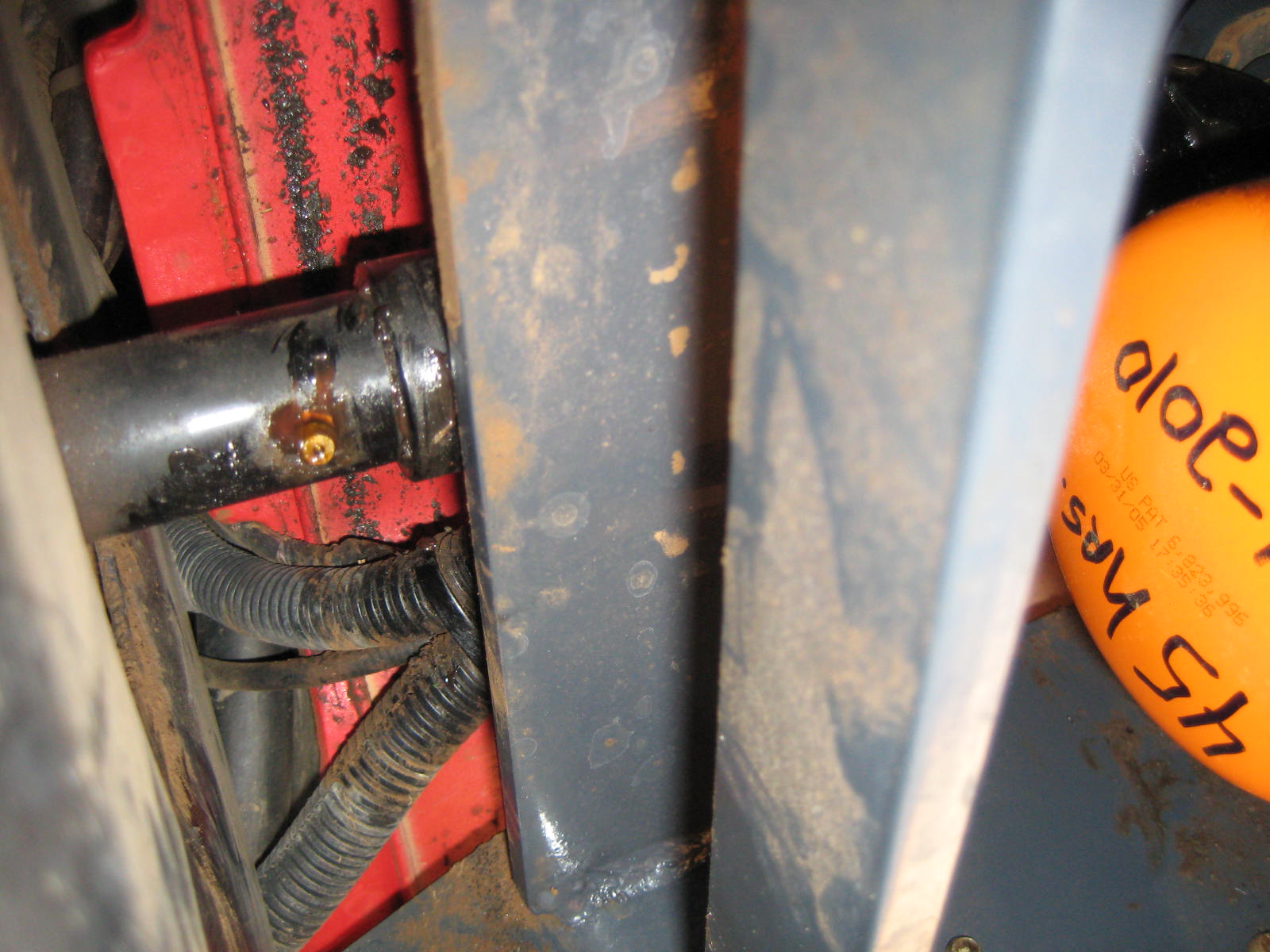

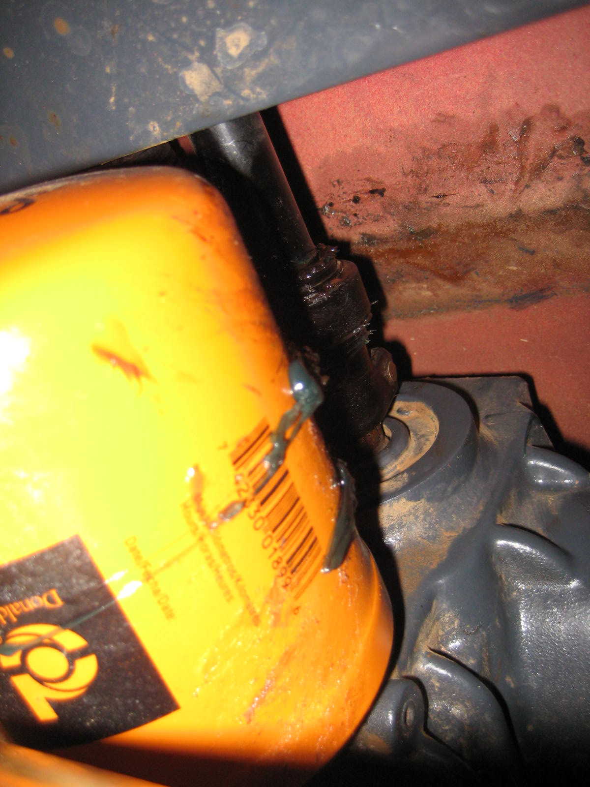

Honorbound, TYMinColton & Tom59, Thanks for the feedback. I gave 5 shots to my dry fittings before I saw any grease appear, which leads me to believe that 3 would have been enough. Of course, that back fitting got about 15 pumps before I managed to get some inside of it!
I believe I'll try to locate a 90 degree coupling for my grease gun end and that should help a good bit. Either that or change the actual fitting to a 90 degree and then whenever it stops it'd at least be pointing in the down direction! But, since I don't know whether they are metric thread or not (they probably are) I'm gonna go with the coupling fix first.
I took a couple of pictures. They are dark but show the general area of the fittings locations. For any TYM omners that haven't already discovered this problem area. My computer has been hanging up a bit tonight so it's running slower than usual. Bear with me and I'll see if'n I can get them uploaded.
Greg

Yikes, it is in a tough spot. I looked for the rear zerk in question on Sunday, but couldn't find. I think your original message was clear, I just didn't read it carefully. guess TYM assumes you'll grease it when you change your fluids (i.e. remove the hydraulic filter)? :thumbsup:
Thanks for the pics. A bunch of K2 owners will no doubt benefit from your "rattling noise".
All the best,
pete
