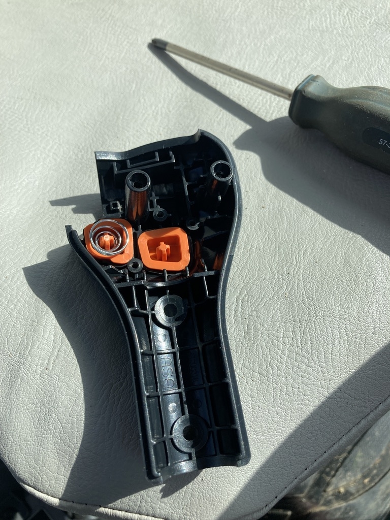

Just about to tick over 20 hours and I've been "tolerating" a rattle coming from the loader joystick. It only happens at a certain engine rpm/frequency and I only have to touch the handle to make it stop. I finally had enough and decided to take a little sniff to see if it was just something minor I could patch up myself:
Well look at that - missing a spring behind a third function button. What are the chances they can supply the spring alone?
   / Rattle from loader joystick - CK2620 #2
Surely you can find a compatible spring or two in your leisure time after you have that replaced under warranty?
I wouldn't expect them to sell that spring, but I would imagine it's an off the shelf component.
   / Rattle from loader joystick - CK2620 #3
Maybe your dealer has a mobile tech that can replace it on-site, or could provide you with the whole assembly, allowing you to avoid downtime?
I sent the picture to the dealer and reassembled it. We'll see what comes of it.
The purpose of the post was to inform those that may find themselves in the same situation (unlikely as it may be).
