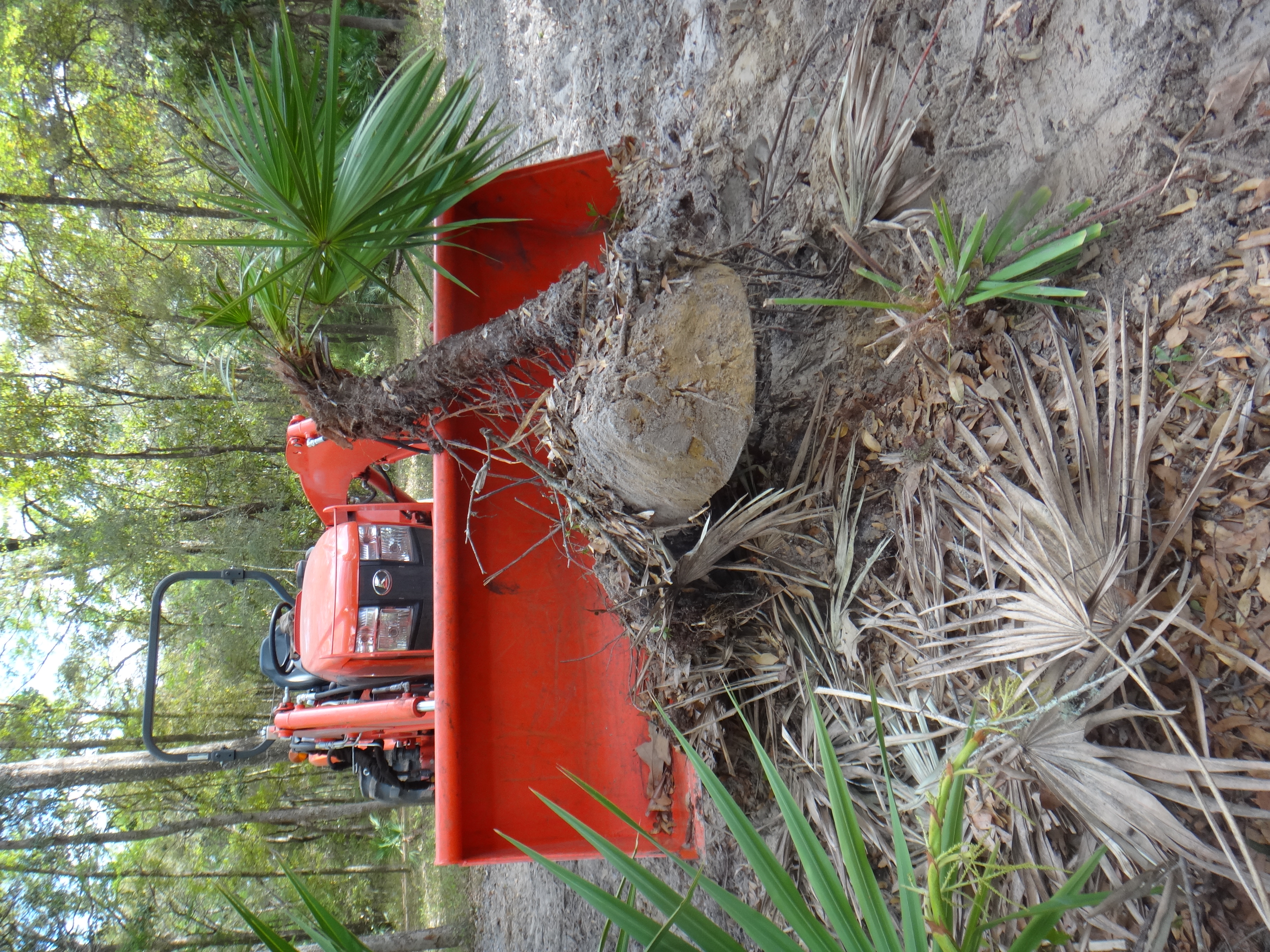

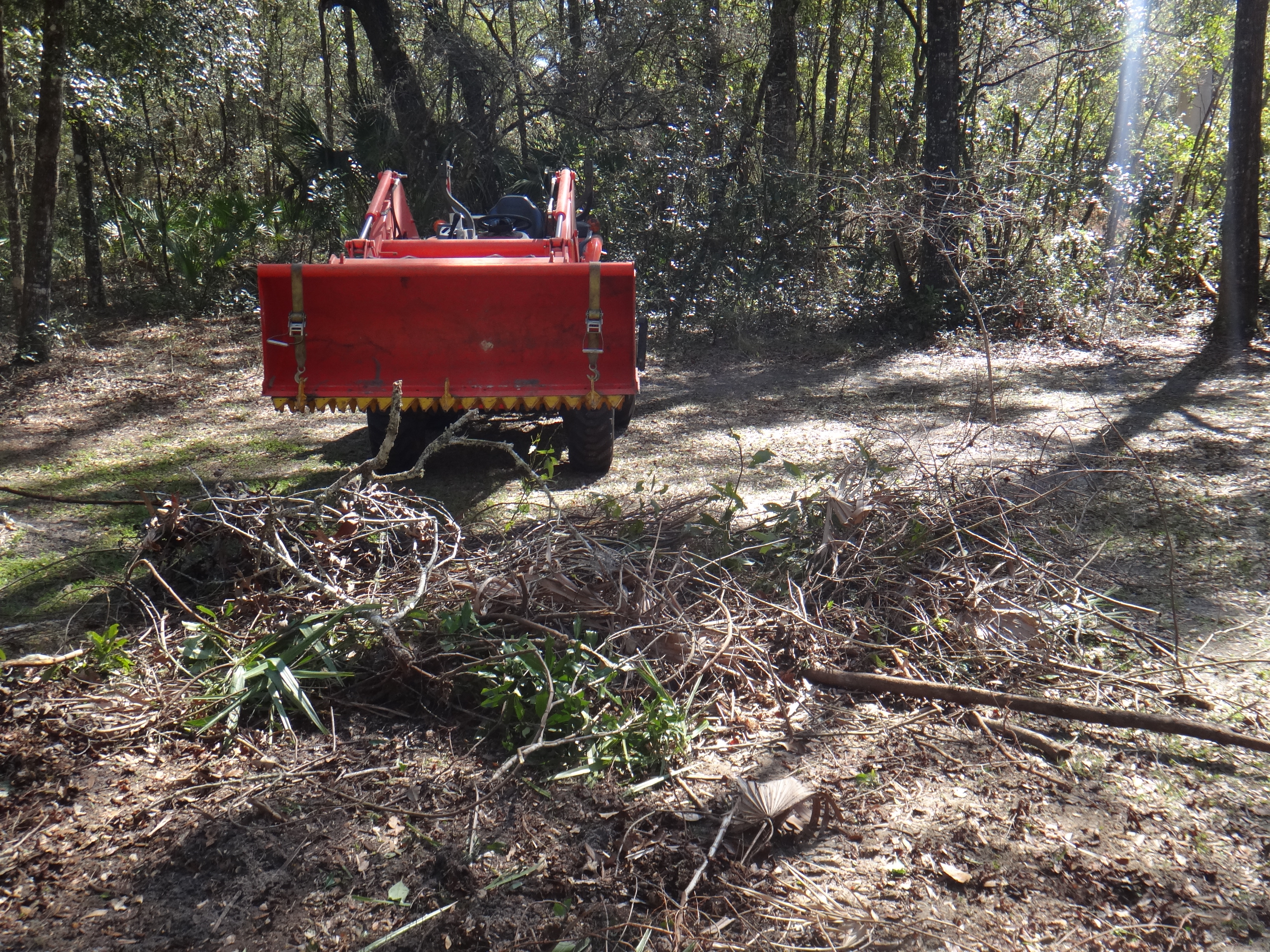

...Main use would be cleaning up after root raking...
By root raking, do you mean the grapple and digging kind for the FEL? I assume you don't mean a Landscape Rake that goes on the 3 point hitch, right?
I have all 3, a tooth bar, Ratchet Rake and a landscape rake. I mainly use the Ratchet Rake for "finishing" work. A tooth bar can be used like a poor man's rake, it's not the greatest but between the tooth bar and the heel of the bucket... you can smooth things out pretty good. The Landscape rake does an excellent job picking up sticks and leveling (somewhat).
If you are looking to get every little root twig and branch... a tooth bar will fall short. One thing I don't like about the Ratchet Rake, is that you can not use the bucket for much else. You might want to look into Piranha toothbar... that might be a better option.
/ Ratchet Rake or Bucket Tooth Bar #7
You cannot dig AT ALL with a Ratchet Rake attached to your bucket. Ratchet Rake is great for collecting and piling debris.

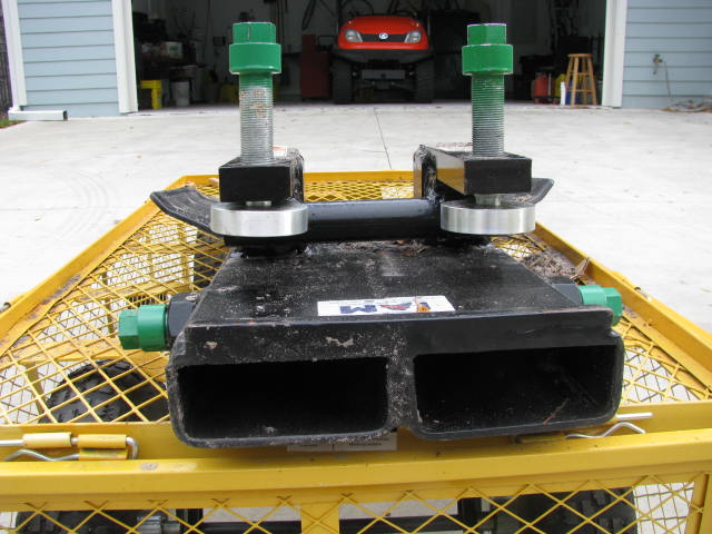

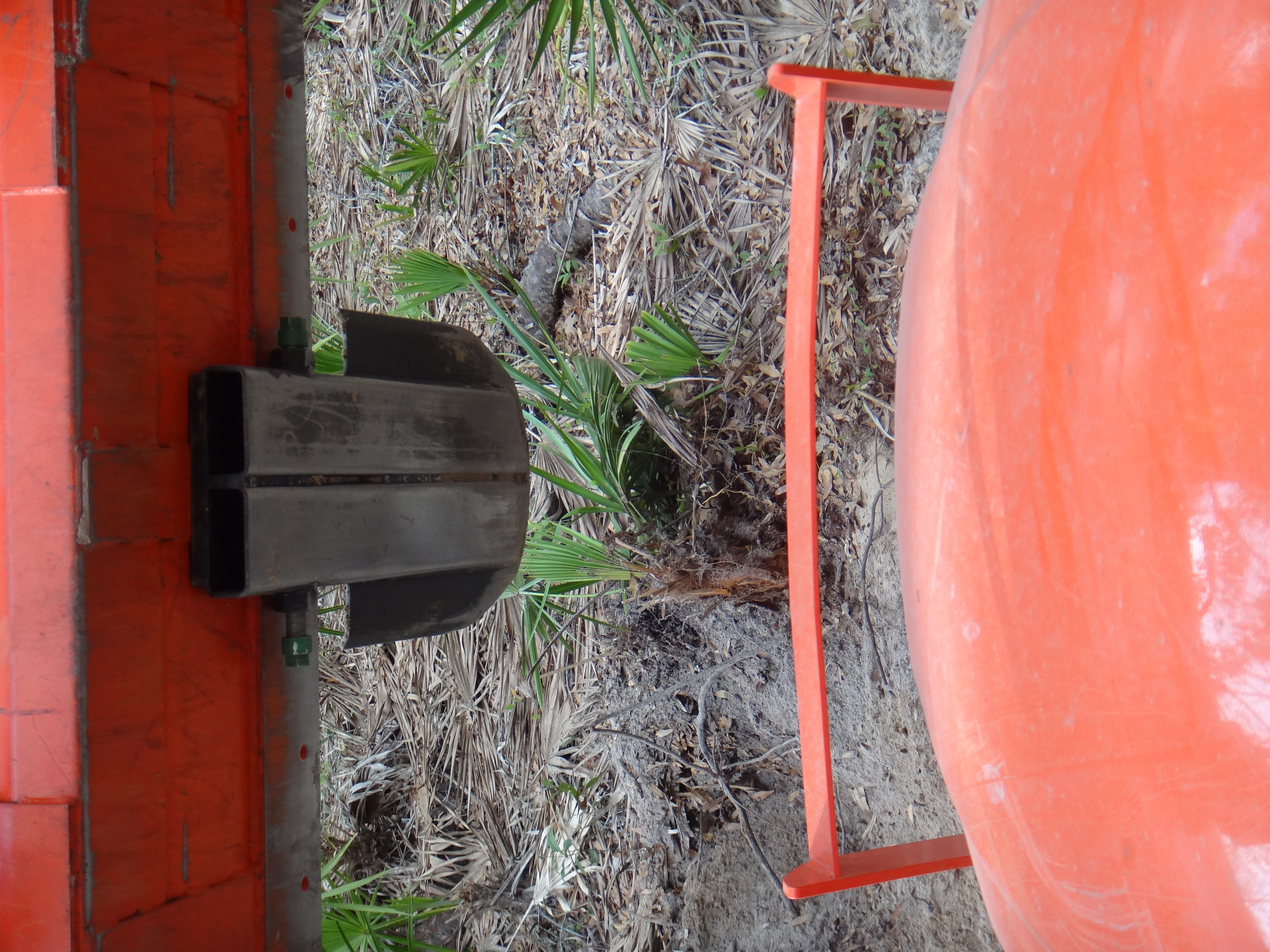

I do not know the object of digging in the clay on your property, but consider a Bucket Spade as well as a tooth bar. Bucket Spade will be the berries on a Mahindra 5570.

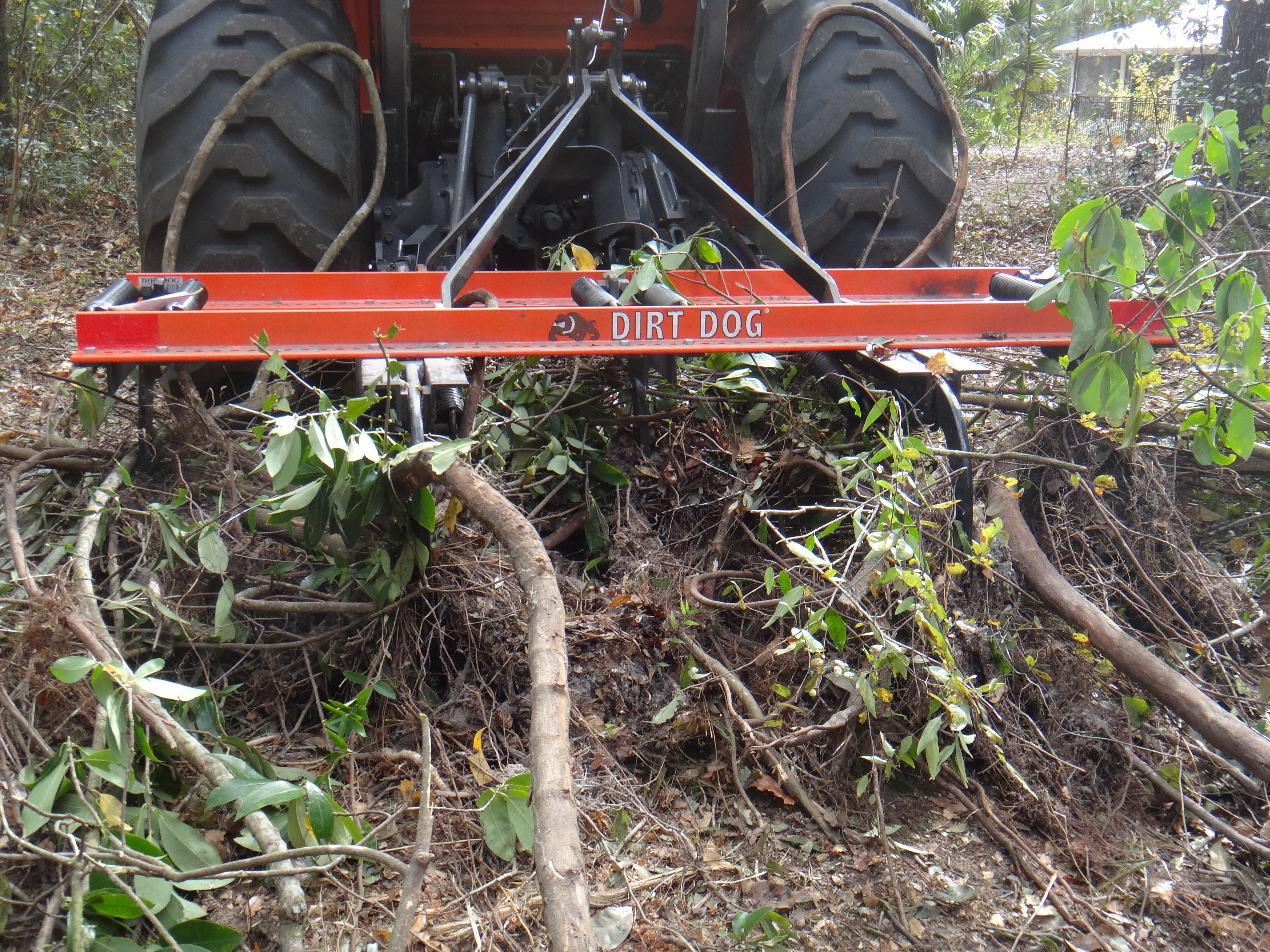

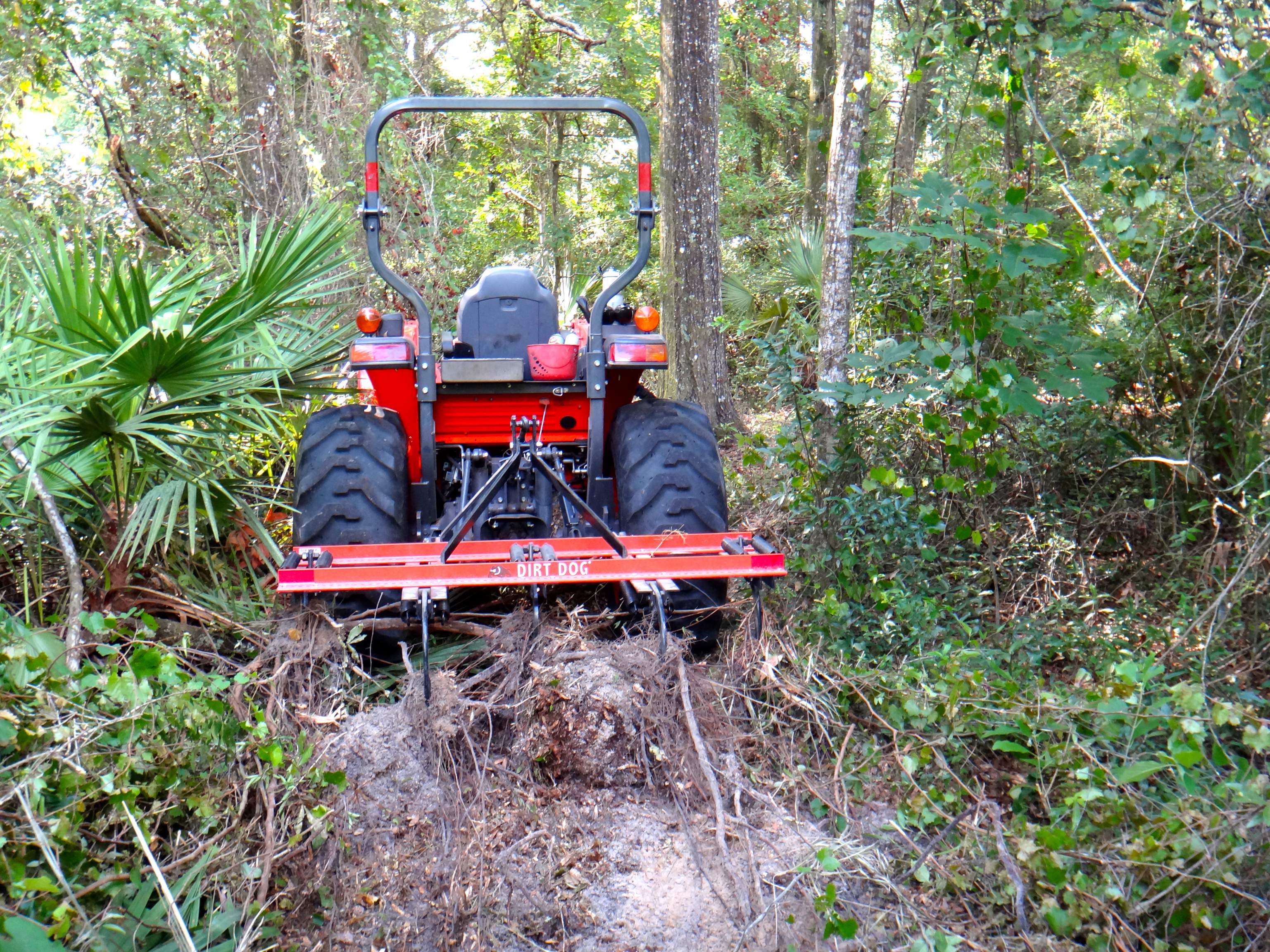

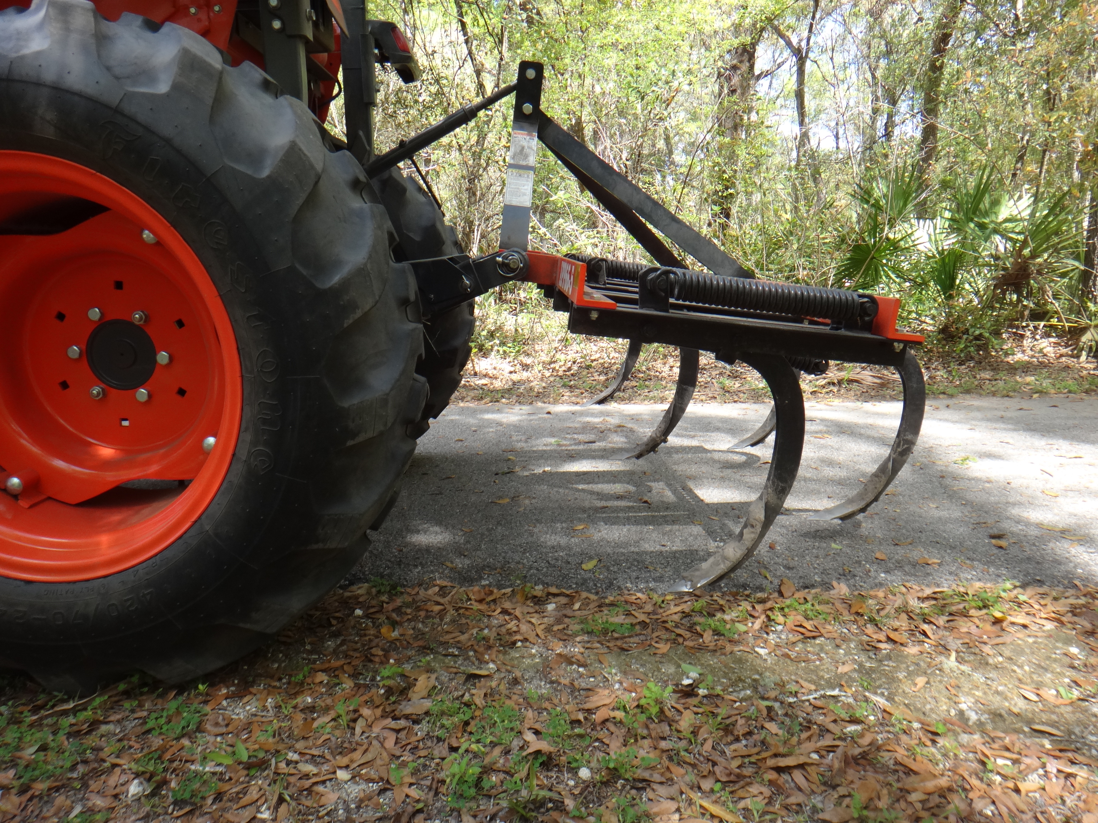

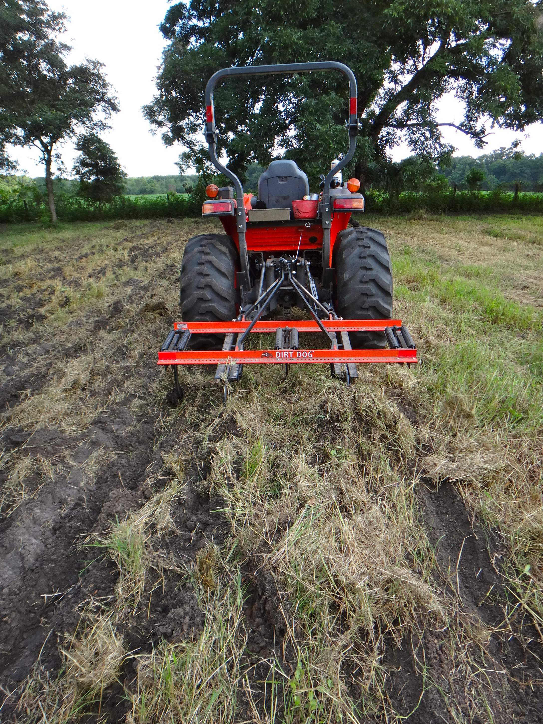

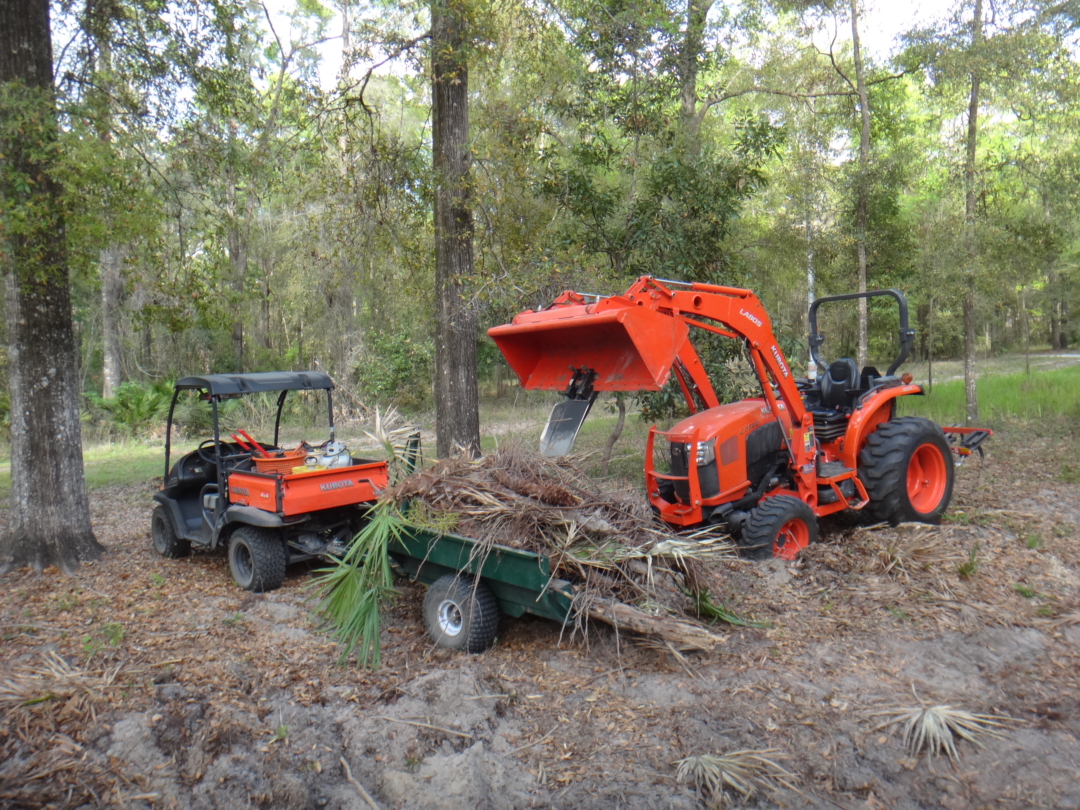

After considering your photo in Post #4, consider a Field Cultivar for removing subsurface vines, roots and corms.
BUCKET SPADE LINK: http://www.tractorbynet.com/forums/attachments/328798-bucket-spade-today-fel-bucket.html?highlight=
DIRT DOG APP LINK: http://www.tractorbynet.com/forums/attachments/339095-dirt-dog-all-purpose-plow.html?highlight=

I have both:
- I used the RR once and now it lives on my BB as an additional weight for my BB weight block (RR +110 lbs to 410 lbs = 520 lb weight block).
- My BXxpanded Piranha tooth bar lives on my FEL.
Do the math.
