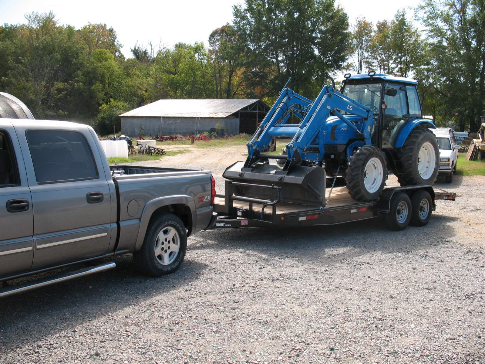

newtrailerpics003.jpgI have a 20 foot trailer with dove tail and 5 foot ramps. The angle is too steep when loading my B26, the backhoe drags into the dirt but still goes on the trailer ok. When putting on my Ferris zero turn at the selling dealer, the deck was hitting as it topped over the ramp. They just used the trailer jack and jacked up truck and front of trailer about 6" and it loaded perfectly. No need for additional ramps and the trailer jack is plenty strong to do the job, I think it is 10K rated.
I don't know exactly how high the dove tail is but it is much more than 14 as it strikes me about mid thigh

IMG_1135.jpgnewtrailerpics003.jpgMy 20 foot car hauler with 5 foot ramps still is too high for me to load my B26 TLB without the backhoe scraping the ground a bit, but it still loads ok. At home I just back up the trailer to a hill and that decreases my angle enough to not be a problem. When loading my new Ferris Zero turn mower at the dealer, the crossover angle from ramp to trailer was too much and the deck was hitting. Rather than find a hill etc to decrease the angle, they just jacked up the tongue using the 10K rated tongue jack. It was enough to just take the slack out of the springs to make the mower load. If in a situation again where I didn't have a hill etc to decrease the angle, I would just use the tongue jack. It does take a lot of cranking to do it, but no lifting or hauling of accessories needed.

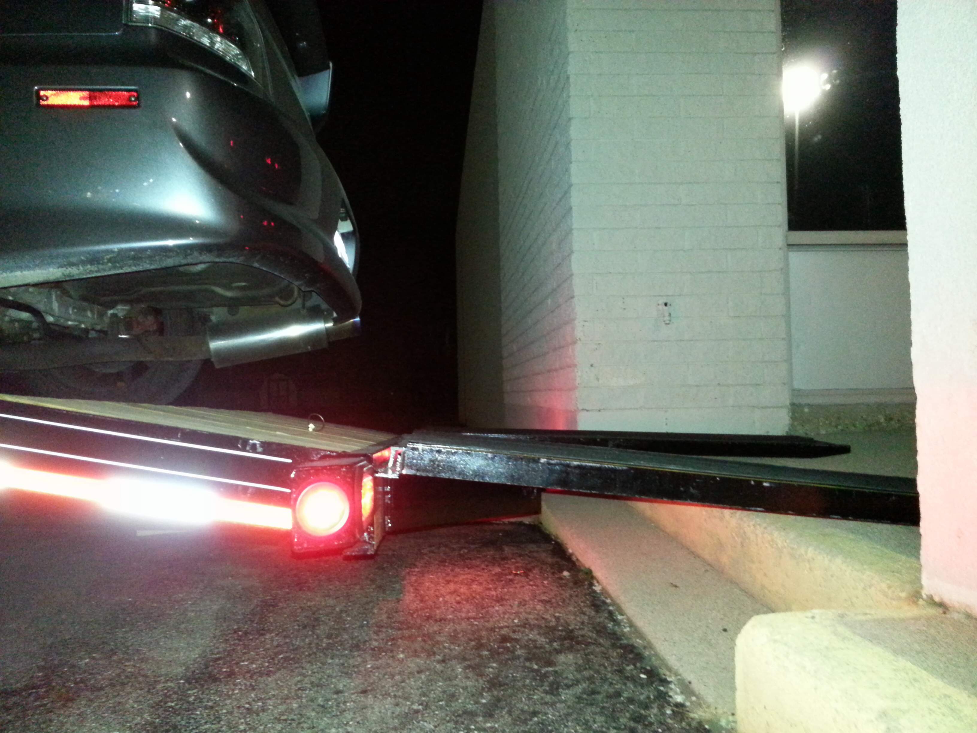

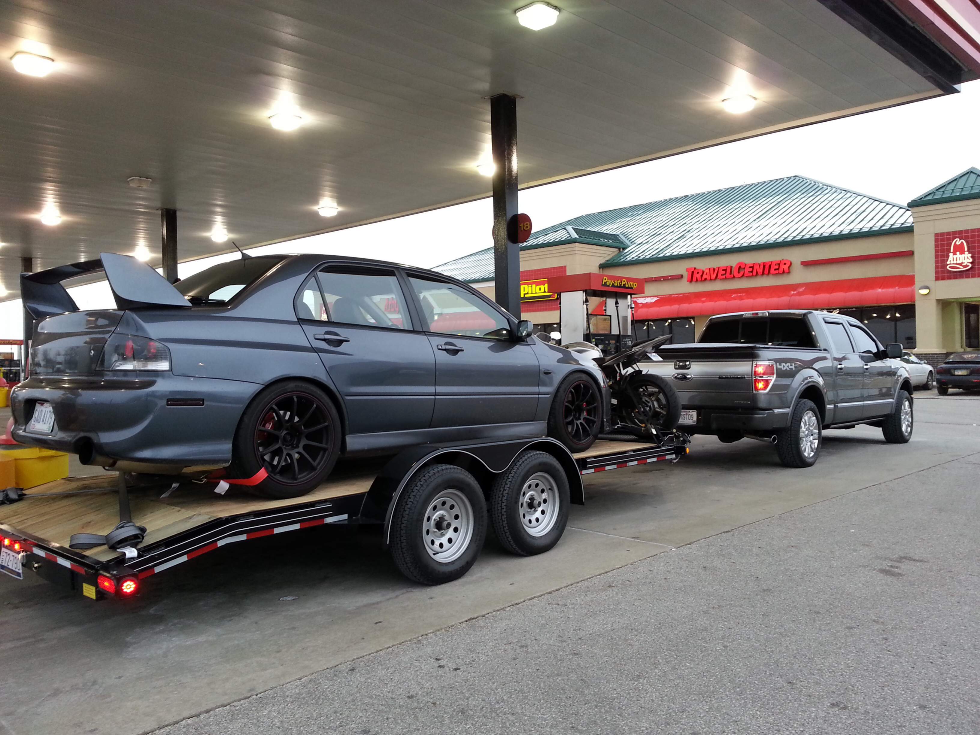

I picked up my sons car and bike in Ohio to bring home for winter storage. We had to find a shopping center front sidewalk to drive the car onto trailer. We tried sitting truck and trailer in a big dip so rear of trailer was as close to the ground it folded the tag under but the front of his car sits about 3" off the ground so it almost has to be flat. Loading the old Jeep Cherokee is no problem, or the BX1870. I think I also need longer ramps or the race ramps as stated.
