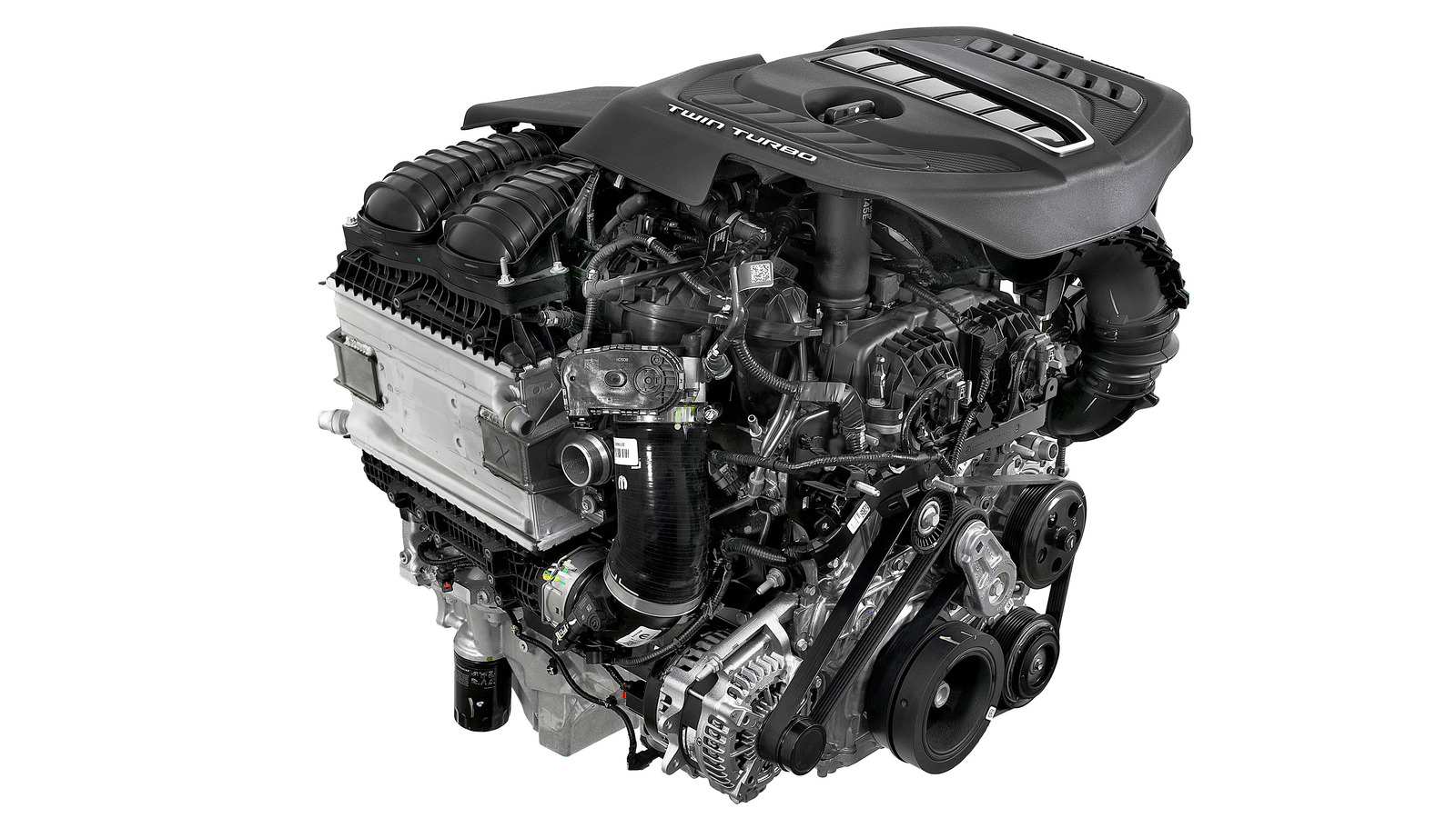

It's also the cheapest to build...you forgot that.
Didn’t forget it. Cheapest to build. One cylinder head vs 2, one exhaust manifold vs 2, less camshafts. , etc.
An I6 is also better vibration balanced than a v8.
Intake plumbing has room on a side, and not restricted within the “V”
Only real drawback compared to a V is the inline is longer, but that’s not a real issue in a full size truck.
I’m glad RAM is going to a turbo I6
   / Ram vs Dodge/Chrysler - how complete is the separation? #96
Cheapest to build. 1 cylinder head vs 2, one exhaust manifold vs 2, less camshafts. , etc.
More internal bearing surface with the V.
Don't need a long stroke to get the same power.
Can use more of the RPM band.
Cooling doesn't have the cavitation issues with a long block.
V motors are best served by a turbo supplying each bank, therefore they can be smaller and spin faster allowing for better low end torque.
