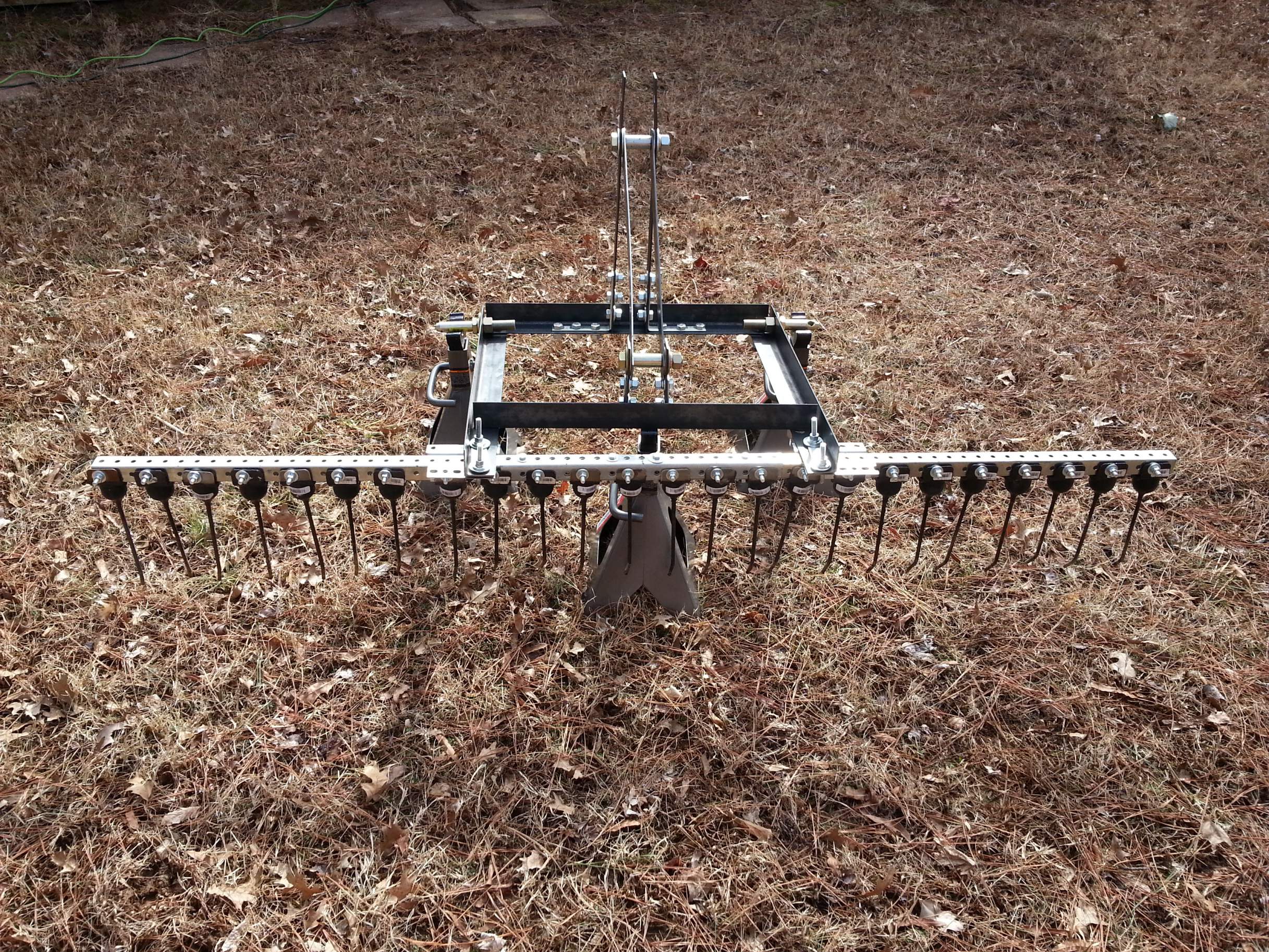

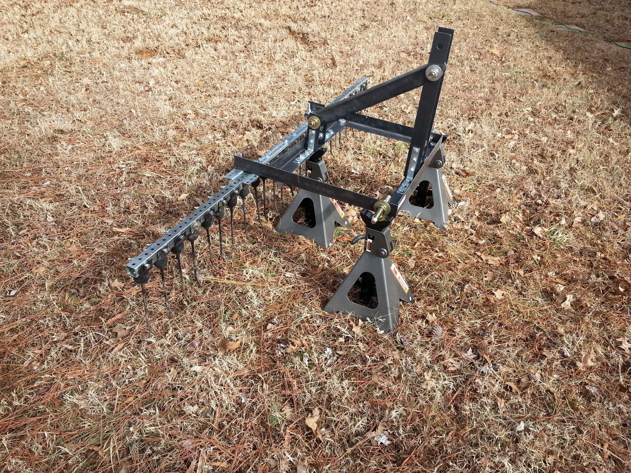

Pine needle rakes are the best thing since sliced bread imo. A definate advantage is that you can rake a wide swath quickly and one pass is all it takes for most large leaves and pine needles. Saves me a tremendous amount of time each year and allows me to actually make a profit using my x749 garden tractor with it.
This is the Lienbach PSR, my next one will be the new EA rake with easily replaced tines.

It seems the pine needle rake subject has come up multiple times this year. sixdogs and I always like to show off our builds. Mine is built with angle iron, perforated iron tube, hay rake teeth, nuts & bolts, and various sized bushings. All parts came from Lowes, Tractor Supply, and Rural King.
