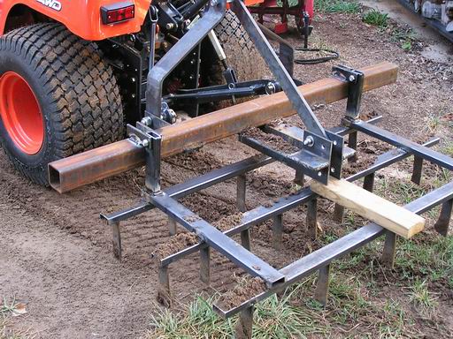

Here is a picture of my new 3 point trailer hitch attached 4' rake. It was a simple project (with welder, drill press, and chop saw), and I only spent $30 at TSC to buy the tines and bolts. The rest is scrap metal. It did a great job of pulling up the old grass clippings to expose the soil surface for overseeding. I just wish that I had built it years ago...

Now that is slick! almost eveyone has a receiver type hitch for their tractor and this is a lot simpler and cheaper to build than a tph type, I for one would be interested in a back view and some dimensions

The width is 51" with a 48" wide tine pattern every 2". The length is 18". The drill press and a pneumatic socket wrench took care of the holes and bolts. I believe the bolts are 3/8" x 1.5" with a flat washer on the tine side. If you build this design, just make sure your 3PH goes low enough. It works fine on one of my tractors, but on the other tractor, it does not always touch the ground on certain slopes. I compensated by traveling across the slope.

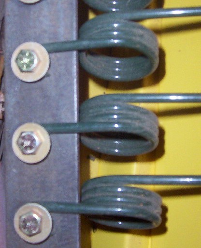

I attached a close up of the tine attachment details, this is the front of the rake.

/ Rake - $30 and 3 Hours #17
Keith:
Thats the same way I attached mine. I also ran a rod trough the center of the springs so they could not turn.

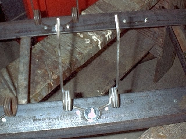

Here is how I attached a double tine for a dethatcher that I just built for another TBNer. Notice the 2 sheet metal hex drive screws. These were placed there to eliminate any twisting by the tines.

/ Rake - $30 and 3 Hours #19
Mad:
Seems like many have utilized tines for rakes/harrows. I ran a wooden rod through the tine spring loops to keep them from moving and/or loseing them.
