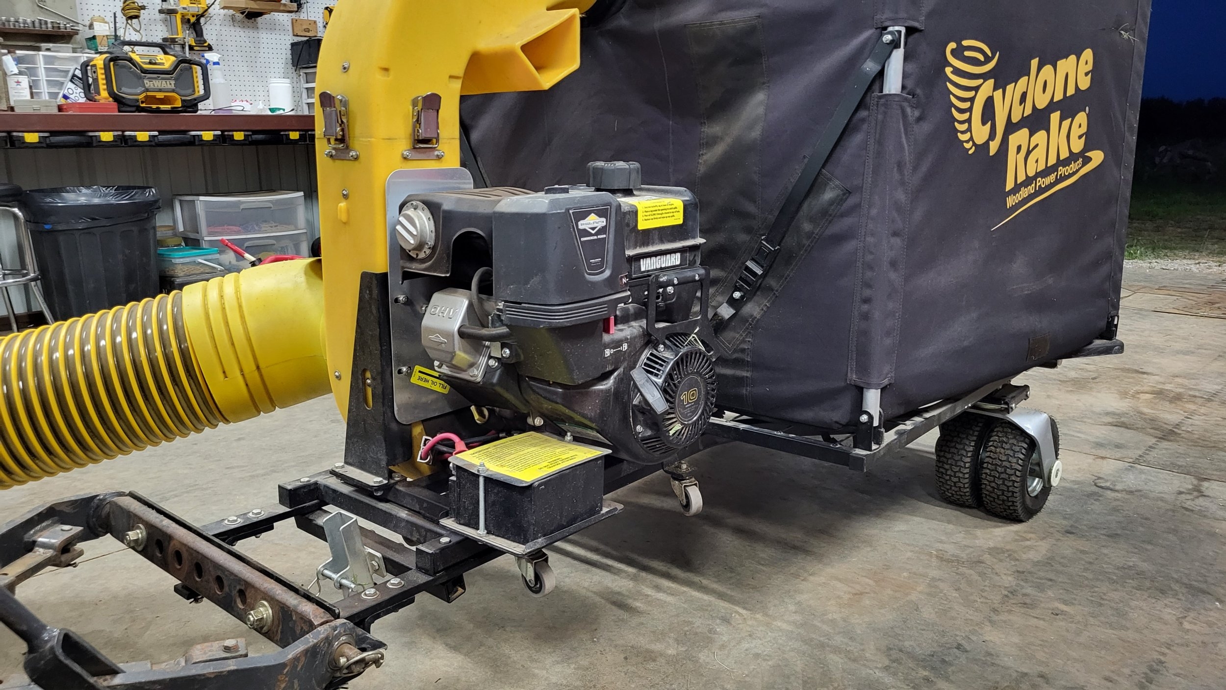

I bought a slightly used Cyclone Rake Z10. My main reason for using it is to collect grass clippings and spread them out on bare spots to help rebuild the soil and spread seeds. I was a little skeptical at first, but I must say I am quite impressed after using it for a few hours.
I had to make a custom bracket to connect to my BX mowing deck. The hitch pins to a piece of angle iron bolted to a 3 point hitch bar. The cut height was too high with the 3 point lowered to the level position for the cyclone rake, so I added some spacers to the lift arm which allows the deck to stay higher when the 3 point is at the level point.
I plan to make videos when time allows. If anyone has any questions let me know!

I did something similar with mine but set it up so everything pinned on so I can quickly take it off to use my trailer mover/drawbar. I have an independent lift, so no concerns about 3 point and deck height.

Video of it in action below... this thing is a real PITA to dump if it is 3/4 or more full of grass clippings. I found out the hard way. I left it all in the video so anyone searching about these in the future could see it.id like to have a lever like the Grasshopper dump hoppers, but I doubt I'll be using it often enough to justify the time and money involved in a rebuild of the Hopper assembly.
/ Cyclone Rake Bagger #4
It is really heavy to dump, especially with grass clippings. I try not to let mine get completely full before I dump it if I'm collecting anything but really dry leaves. Looking at the video, do you have the prop rod installed? If you prop it up before you drive forward, a lot of things will just slide out. I make long rows and then pile it up with the loader.
Of course, Cyclone Rake does sell the power lift if you want to spend $300. When I get a few years older, I may invest it the upgrade.

Okay, huge face palm moment. The lift arm was pinned in the down position by the previous owner. I glanced at it and thought it was a brace. Thanks Kenny!
I pinned the lift rod up and ran it for about an hour, filling up 3 times to the 3/4 ish level, much much easier and faster to dump. I removed the video and will get new footage and re-upload so I'm not misrepresenting the product.

I have an idea for a lift assist... I could disconnect the 3 point and hitch the vacuum directly to the tractor frame, then have a few bars stick out from the hopper frame and rest on the 3 point arms, so when 3 point is lifted it'll lift the hopper up.

I doubt the three point would raise it high enough. You have to get off anyway to open the collector, so why not just use the prop rod?

The first time I used it the grass was nice an green and lush. I filled the hopper about 3/4 maybe a little less, then full. Went to unload. Just to heavy to pickup and dump. Ended up raking the grass out till I could lift it. The second load which was about 1/2 full. Still couldn't lift it.
Well I fixed that problem. I got the power unloader unit. Simple to install and works great. Worth the $325.

I'm thinking that if I have the 3 point do the lifting I can fill it up more. The lift rod can still hold it, I just want the 3 point to do the main part of the heavy lifting instead of my back. Another idea I had was to simply add a rod sticking out that would increase leverage for hand lifting.
