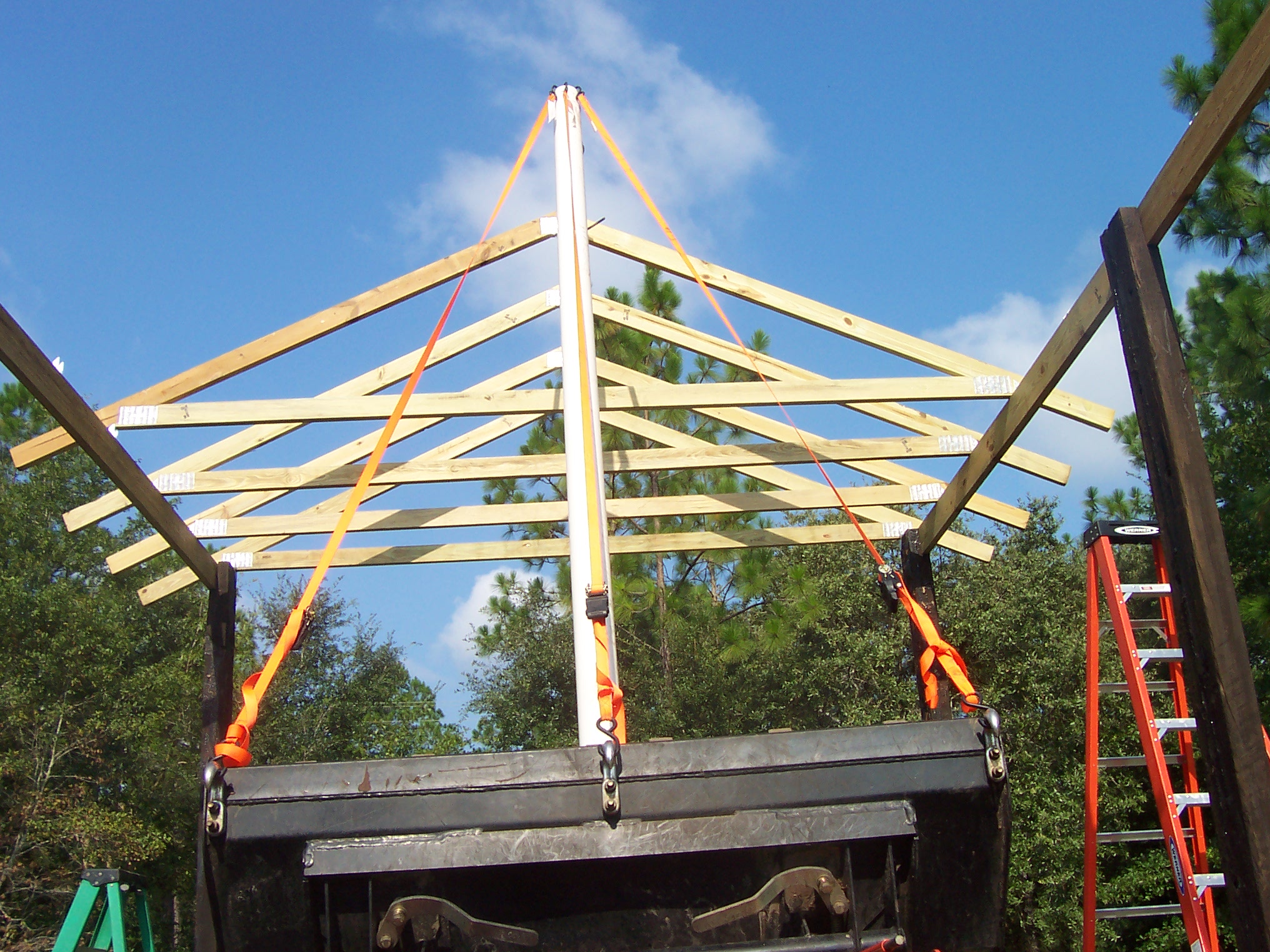

This is how I did it for 12 ft trusses . 4" pvc pipe over a single Paynes fork. Worked great
