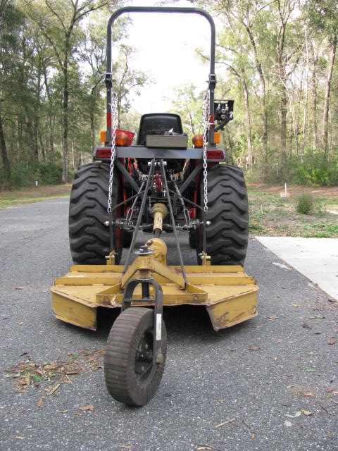

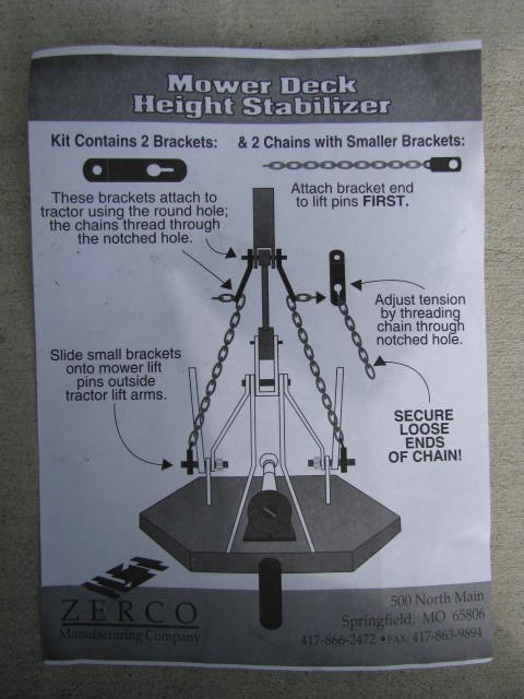

Thanks all. An offset drawbar sounds like what I need. I wonder if I could weld up something myself just to attach to existing drawbar.
Stroke control segments are nice. I have a slow cylinder leak and I depend on them to keep from scalping as the cylinder retracts. Fully extended, I am only as tall as the draw bar.
