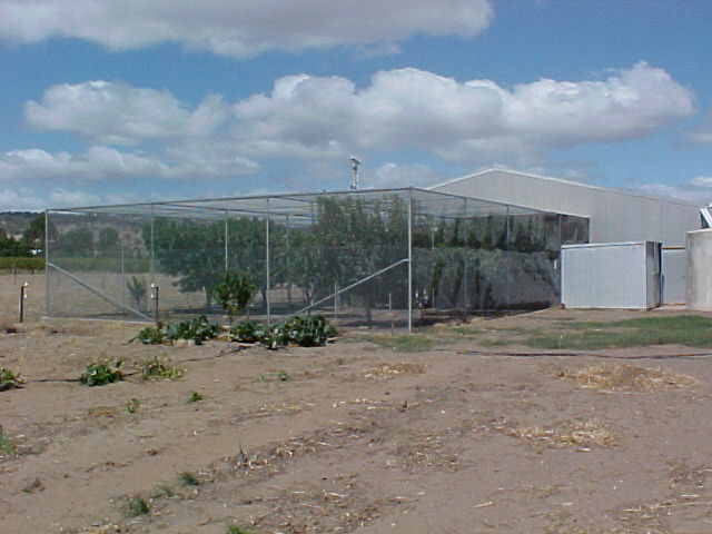

In South Australia I use winter rainfall for washing, bathing, drinking and garden irrigation, right through Summer and Autumn. (first pic)

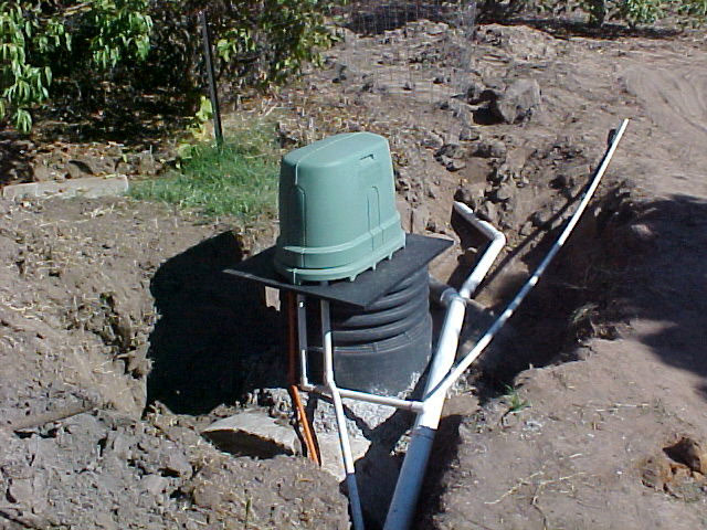

At a rental property I own the drainage trench fed with water from the bathroom, laundry and kitchen became blocked.
So I dug a hole with the backhoe and dropped in a secondhand 1600Litre (about 400 US gl) septic tank and finally also connected up the gutters to this tank.

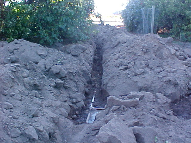

Tried an above ground pump but it wouldn't prime, so now have a large submersible sump pump sending the water (when it trips a float switch) to four wobbler sprinklers, which only require 10psi, watering four Walnut and one Mulberry tree. (pics two to five)
MVC-072F.JPGNot a good pic, but just shows one of two 5000gl concrete tanks on the right and behind the fruit trees in the chook run are two 5500gl poly tanks.
MVC-501F.JPGRental House - top of concrete septic tank just visible
MVC-502F.JPGCatchment from gutters not shown here - added later
MVC-524F.JPGSmall tee toward the back of this pic distributes the water to the trees
