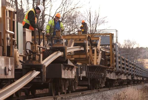

Railroad track would be a lot stronger than a railroad tie,,,:thumbsup:
/ Railroad Tie Support Weight #12
I doubt that. Railroad track is pretty floppy.
/ Railroad Tie Support Weight #13
the gap is only 6 feet,, people build woodsplitters out of rr track,, they are not the best, but, they are WAY more than 2,000 pounds,,,
/ Railroad Tie Support Weight #14
There’s a big difference a load bearing joist and the force involved in a wood splitter. And yea it’s probably strong enough to span 6’ but so is a lot of other easier obtained stuff.
Rails are made to span about 16-18 inches, between ties. :)
