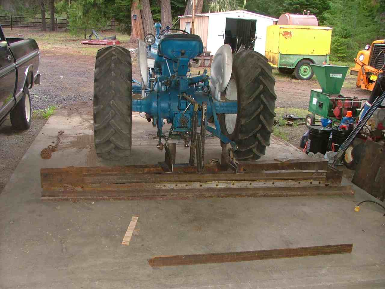

Here is mine. If you close you can see that there is a cutting edge off of some kind of grader bolted to the bottom edge. Don't know who made it it was given to me. Works great on my 3/4 miles of dirt road.
/ Railroad Iron Drag #7

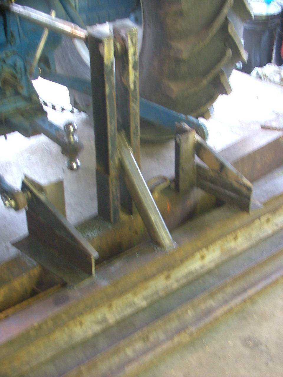

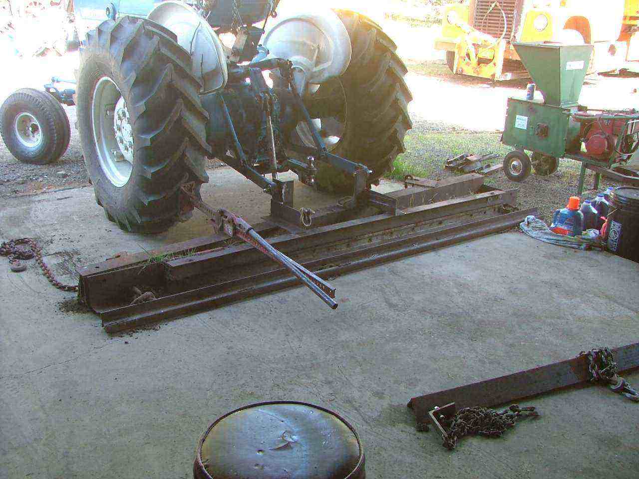

This is the one that I use to drag my road and fill the pot holes.
It was first built and pulled behind a truck, when I got the bigger tractor I changed it to a 3pt. The jack you see was being used to adjust the angle before the anchor points for the 3pt were welded on. The RR iron floats behind the thing to smooth out the ripples.

I built one similar, using the three point hitch. Made it nine feet wide and it works great to scrape the driveway. Still don't know how to post pics, sorry.
