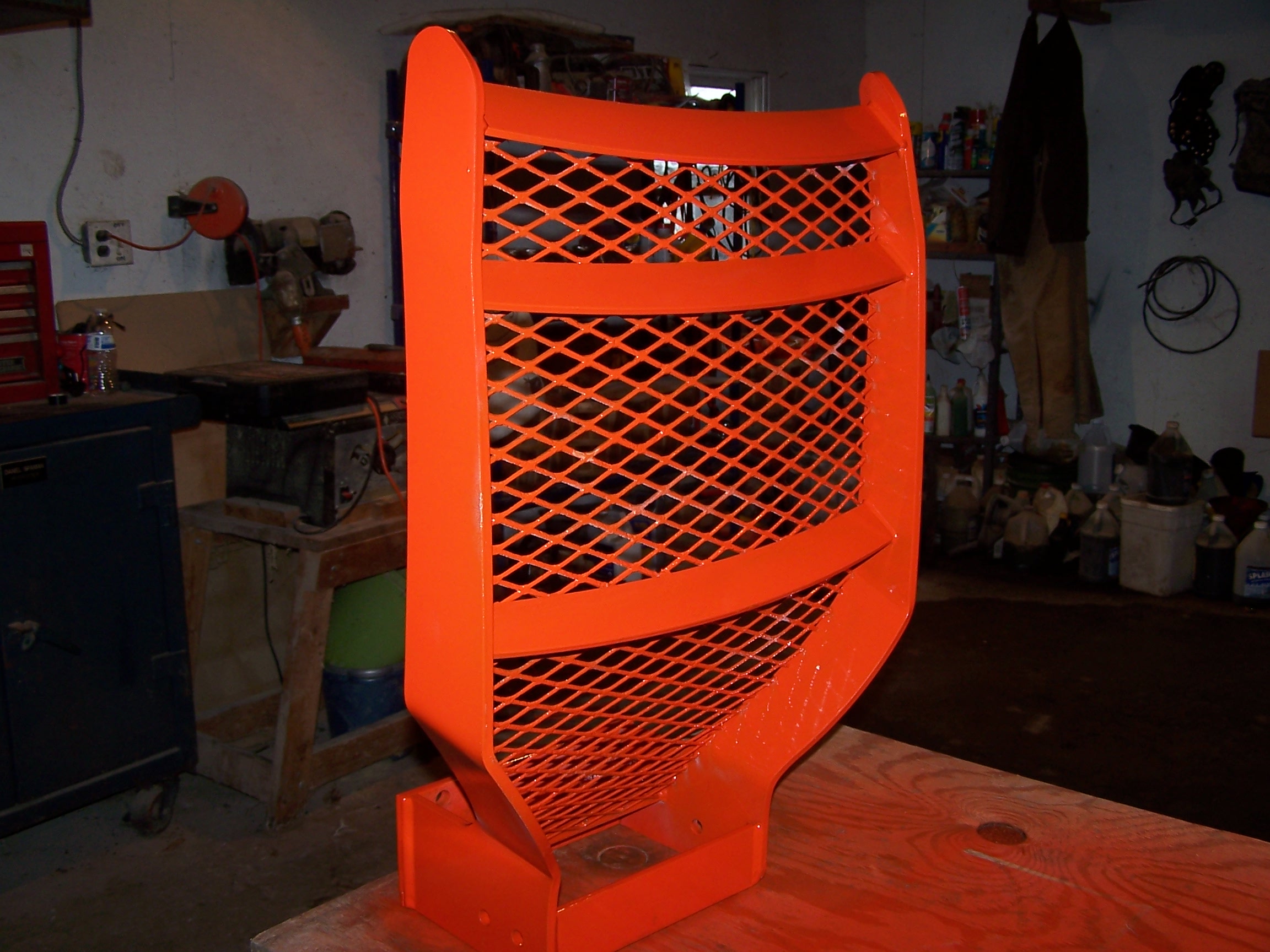

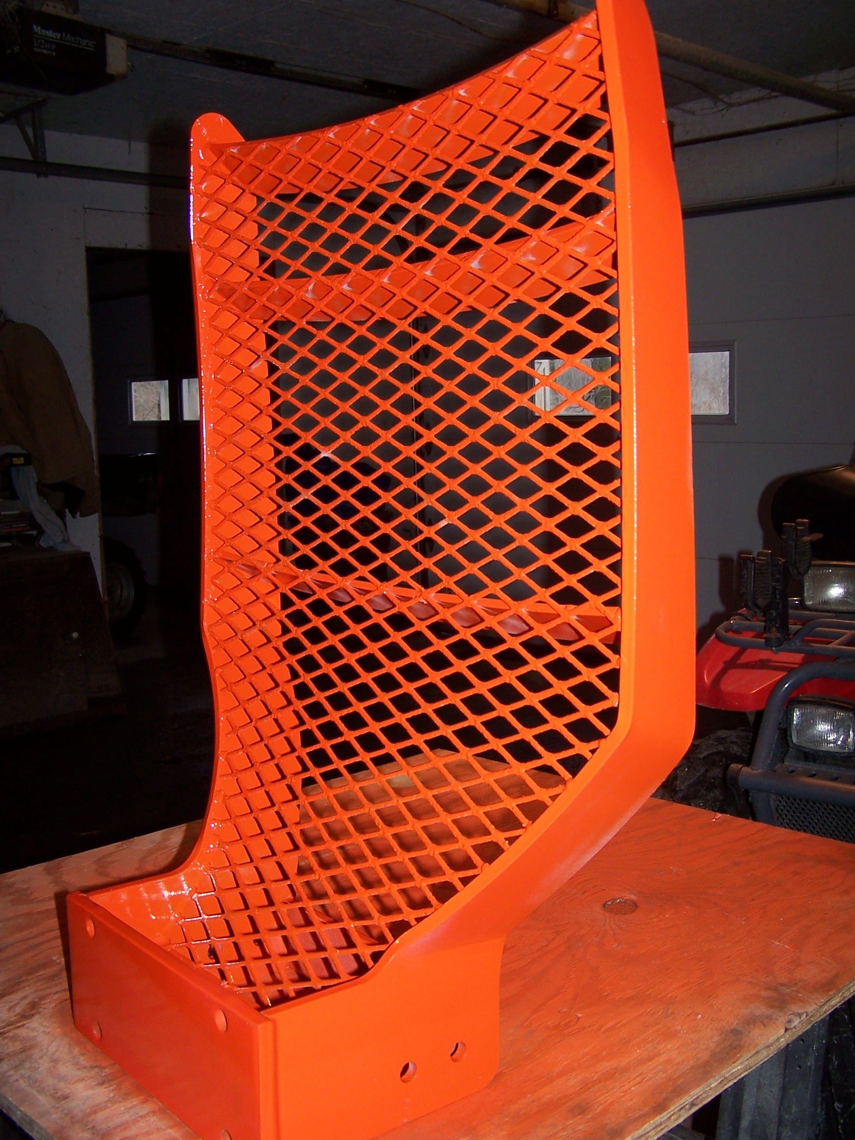

I don't abuse my tractor, but I use it. I built this one using the factory frame.
Nice. That is one serious brush guard. Good work!
