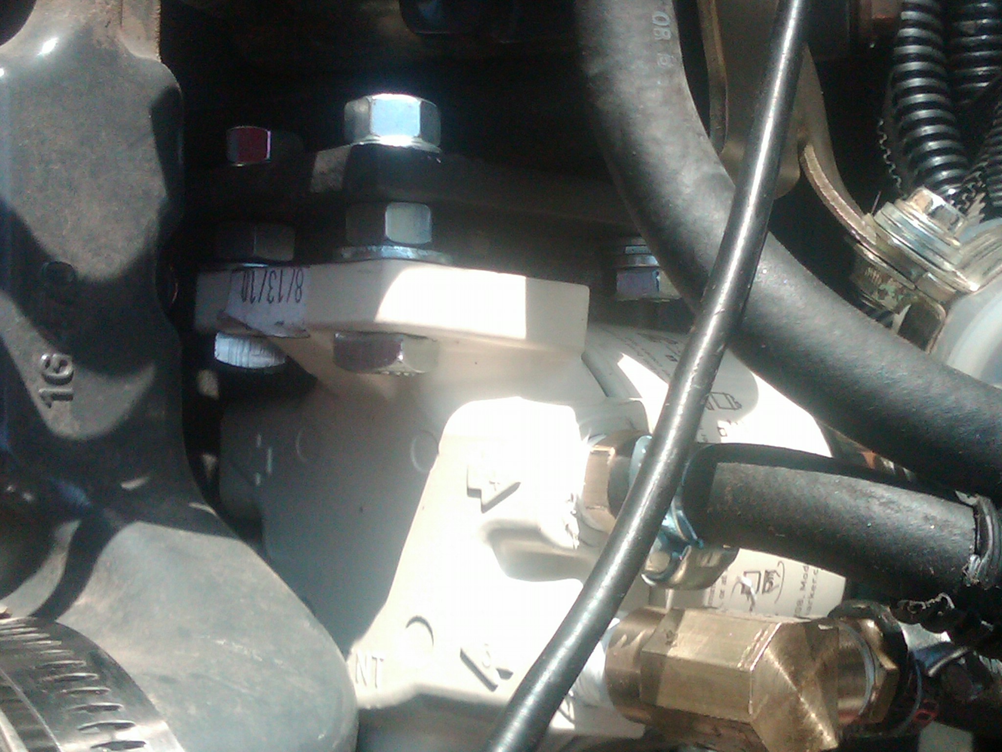

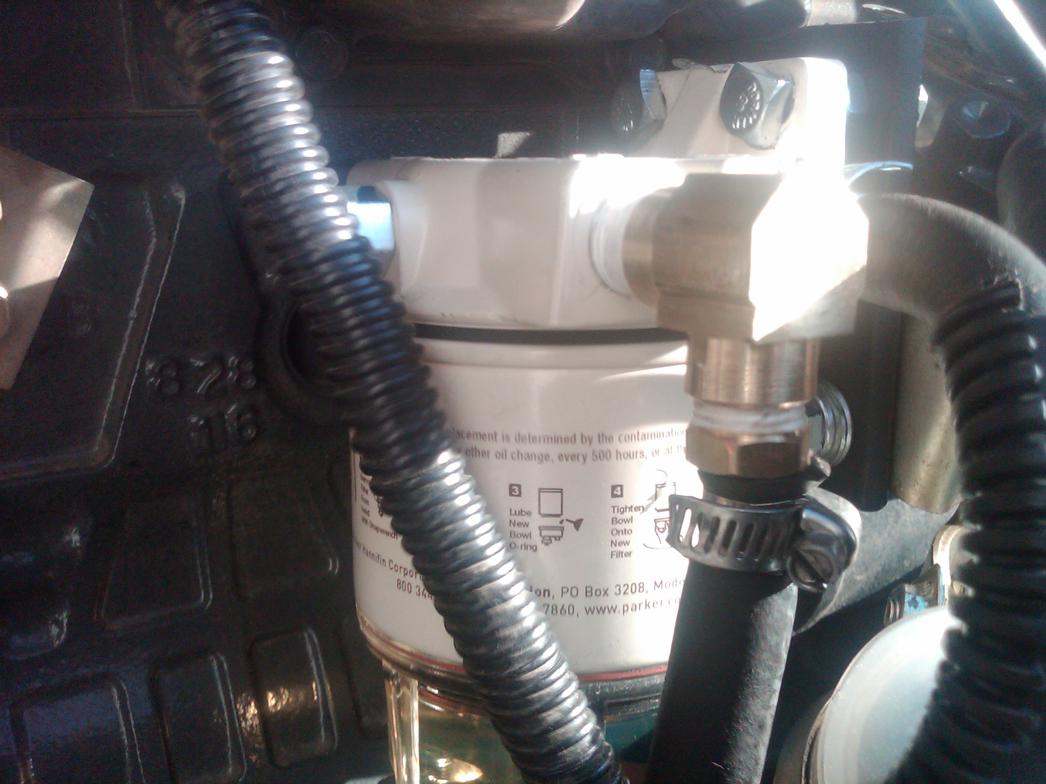

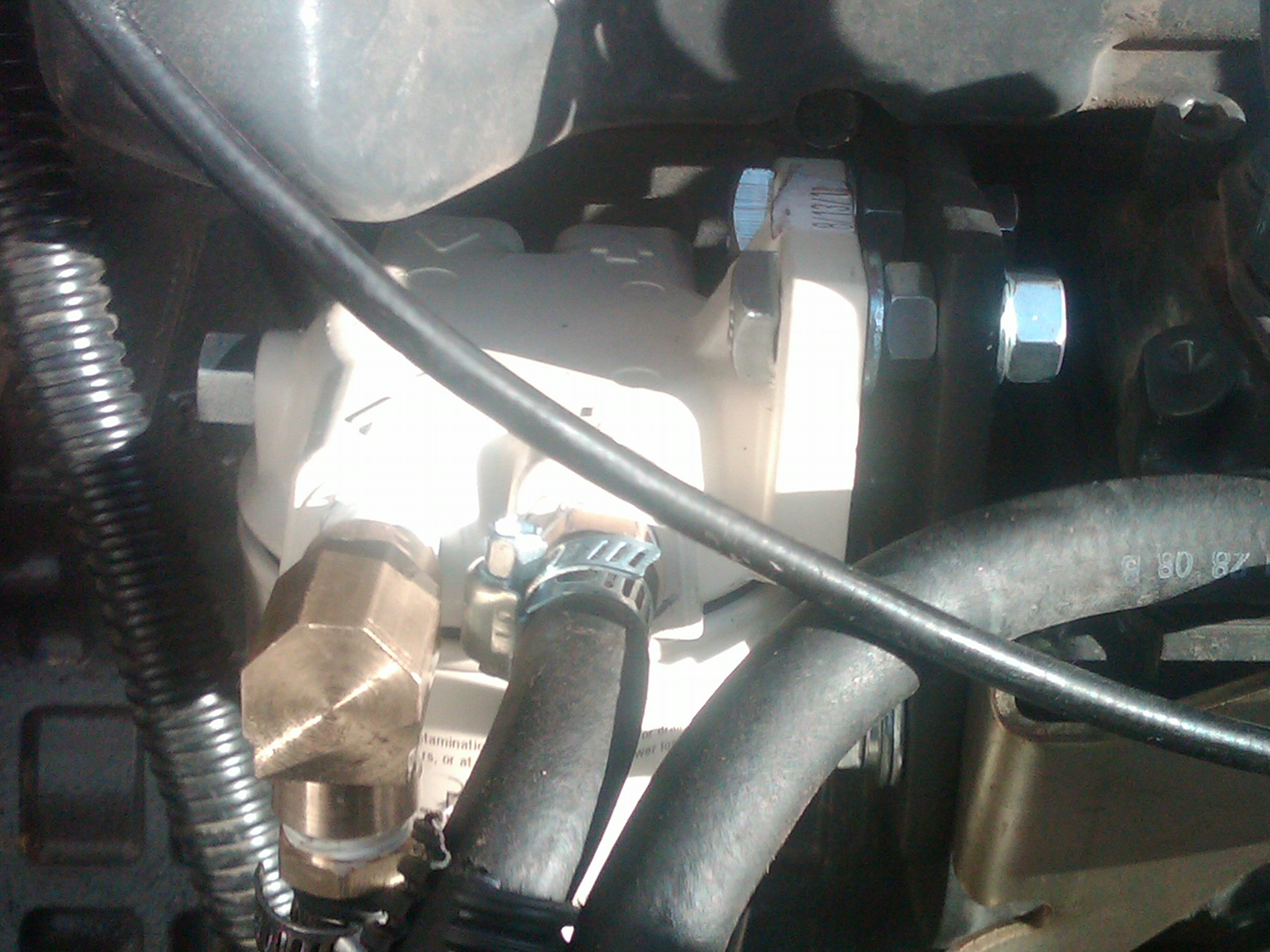

Well folks I finally for the bx24 back from the dealer, had to have 2 of the 4 steel lines from the loader control block replaced. That being finished I took the time to install the filter unit. I made up a small bracket and was abel to stuff it in the engine compartment just to the left of the injector pump and below the intake. I had to replace one of the metric bolts on the bracket (under the hood) that holds the fuel filter assy with a longer one to accomodate the bracket I made up for the racor. I wound up running two fuel lines from the racor back underneath the machine so I could pick up the suction side of the tank as well as the fuel pump side. I then ran all of these lines back up to the filter so I could have the filter running from the suction side. Although I have a few more rubber lines to look after and more hose clamps to keep tightend I think it turned out ok. I am going to post a few pics, all in all it was not that bad, the brass fittings almost cost more than the filter itself :(.

Thanks much for the pictures! I was thinking one might fit in that spot and am grateful that someone else went to the trouble to prove it.
Did you consider moving the fuel pump into the engine compartment instead of running the fuel lines to the pump and back?

Yeah i did want to relocate the pump would have made it easier however the machine is still under warranty and I didnt want to go to far with changing stuff.
As far as the fittings goes I found them at the local home depot in the plumbing isle i believe they are 1/4 threads
