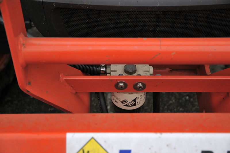

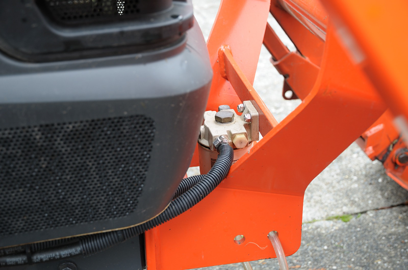

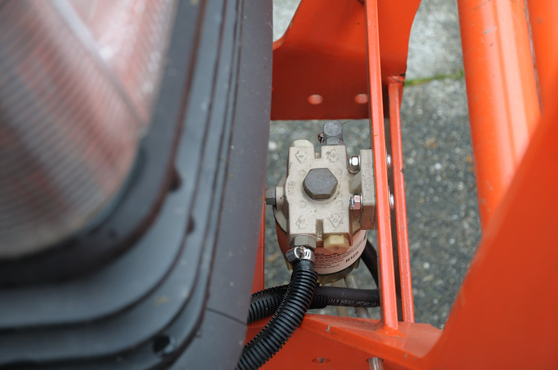

Here are three photos of my install. It's well protected and fairly easy to get to. I installed a hose on the water drain so I can drain into a container instead of dumping on the ground.
As for why you would want a water separator...there is most always water in fuel tanks and water and fuel injection components do not play well together. The filter bowl on tractor is small and one time when using it to run my generator for hours on end during a power outage...I saw the fuel filter bowl was 3/4 full of water. Luckily I caught it in time and I immediately installed a water separating Racor filter which has helped my peace of mind.

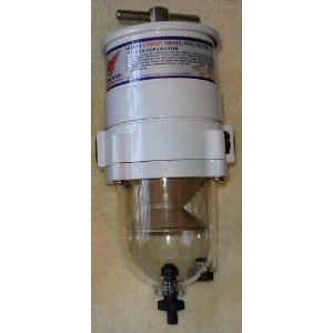

look at the RACOR web site which is now part of parker hydraulics to see them and I will add a picture here.
