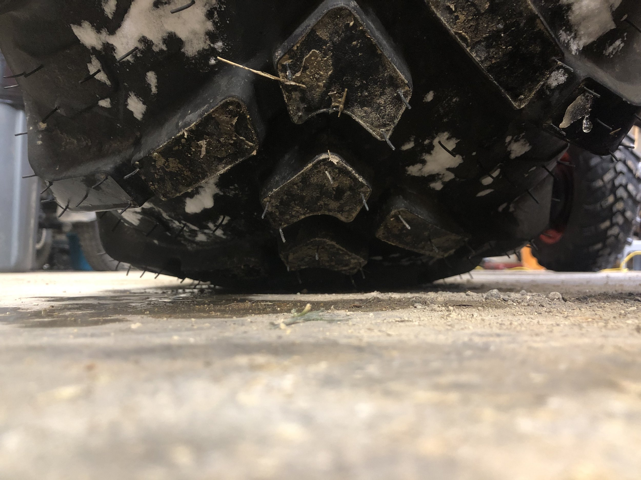

I got my tractor into my (heated :)) garage this morning for some quality play time...
I wanted to fiddle with the tire pressures... previously, I had set all tires to 35 psi ... found I could slip a 3/4+ furring strip under the edge of the tread... not good... I was riding just on the center of the tire... (pic is looking forward with the camera on the floor)
The only good thing about this is the fact that I only drove the tractor to the barn and back...
I went down to 18 psi and the edge of the tread is still off the concrete... I'm not sure if that's due to the 17 degree carcass (it's cold in the barn) or if I still need to lower the pressure... I'll probably wait till spring to mess with the tires in earnest...

Looking at your picture is that one of the newer R14 type tire?
My R1's on heavier tractors are set between 13-15 psi to get a good flat surface contact.

R14… yes…
unfortunately, my owners manual doesn’t list them on the “tires and recommended pressures” page… which is part of the reason I had to make such an extreme psi change today…
I’ve dealt with “high flotation/low psi” tires in the past (3 - 4 psi on an atv) but this is my first experience with loaded tires and FEL… pretty much been shooting in the dark…

When I got my new B2601 two years ago with my first R14s, I asked the salesman what psi I should run. "Twenty pounds, all around!" he said.
Not sure what the sidewall says, but it turns out that's about what my owner's manual says for R14s.
20 up front seems to work good for the loader—when they need air, there's much more of a sag with a full loader.
