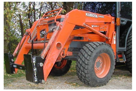

I changed mine (L4200) and was planning to alter the original bucket to go back on the skid steer mount…. But I got a 4n1 bucket and have never ever thought of using the small original bucket… I might get to it if this nice warm weather continues. I have the plate just need to do a little trimming and welding…
PS … you will not regret having an easy to remove/change bucket… & you should be able to get everything you need for under $600. KennyV.
