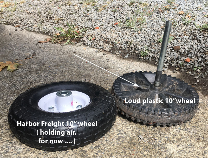

I have a 400ft gravel driveway.

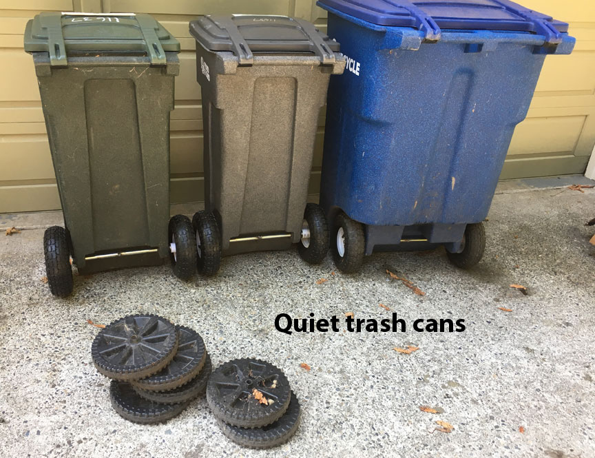

Part of the driveway goes past some neighbor houses and when we drag the trash bins (3 of them) up & down the driveway I often feel like it's noise the neighbors don't need to hear. When I'm getting the newspaper @ 6AM I like to drag one of the bins back to the house, but don't want to make the noise.
So I decided to change the hard plastic wheels to pneumatic. Harbor Freight had a sale on 10" wheels for $4.99 so for $30,,,, my bins are now quiet. And they seem to roll easier too (ball bearings). Now.... if these dang wheels will just hold air, it will all be good. Prob should fill them with slime NOW.
522329d1506031269-quieting-noisy-trash-bin-wheels-img_9819-jpg

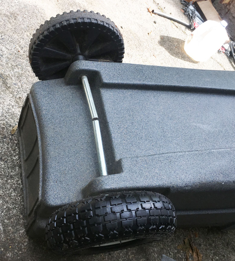

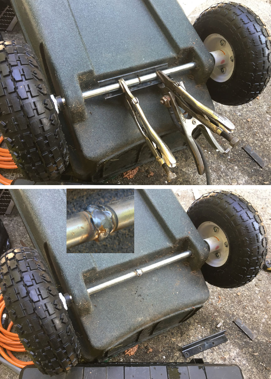

They're held on with metal caps. Which I could NOT get off.
I could cut them off with an angle grinder but then I'd have to go to the store & buy replacements.
522328d1506031269-quieting-noisy-trash-bin-wheels-img_9819-jpg
Decided to just cut the axle & re-weld. Fast & easy.
522327d1506031269-quieting-noisy-trash-bin-wheels-img_9819-jpg
522326d1506031269-quieting-noisy-trash-bin-wheels-img_9819-jpg

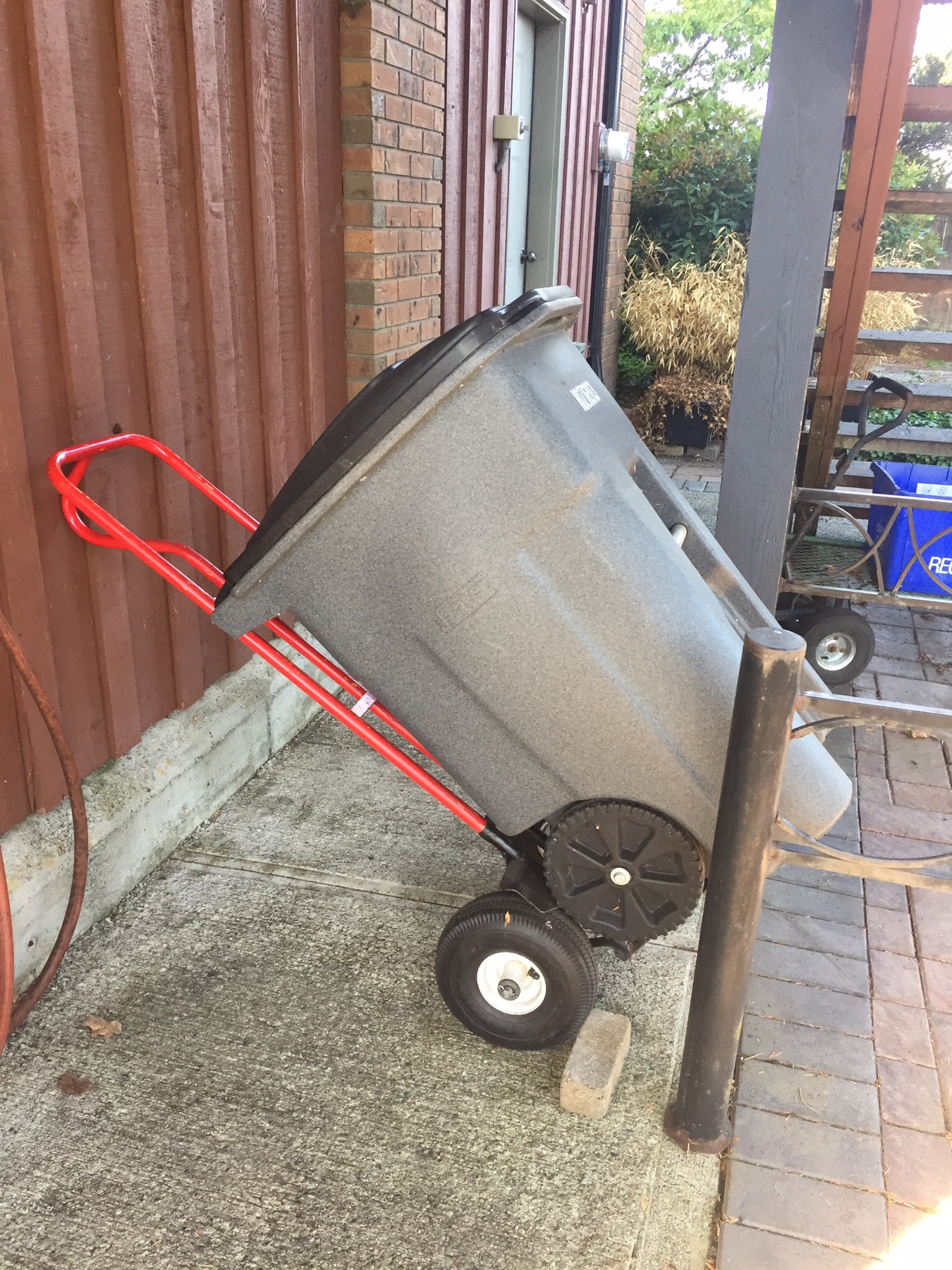

This would also work. Might be easier to maneuver with the extra length for leverage.
Terry
/ Quieting noisy trash bin wheels
Terry that's for me to do - but this is my girls' job.:thumbsup:
But I drag them back to the house (with the newspaper).
I was gonna build a 2" receiver-hitch carrier (with 3 carry hooks) but then decided they can walk once a week.
But I had to use the welder for something, so cut the axle & welded it back.
