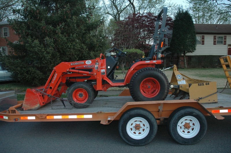

Here's my trailer,
[/IMG]
   / Quick trailer question #7
Yes, I have hauled my BX1850 over 500 miles on such a "small" trailer. I don't think you need a trailer with a 14k
capacity to haul a 2k tractor.
If its a well built 6X8 I would haul your BX1500 in a second.
Here's my trailer,
[/IMG]
I agree!
That's why I only have a 12K trailer for my 2K tractor!
