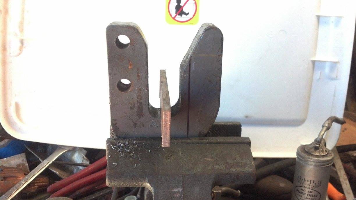

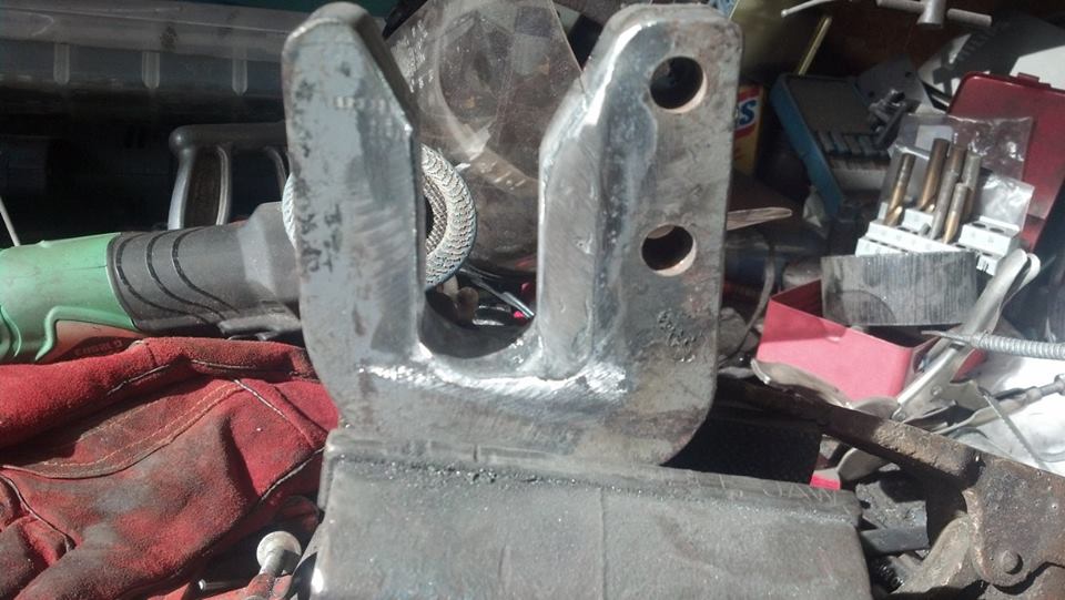

as much meat as that hook has on the implement side you could probably take a saw and remove a 3/8" slice out of the slot and still have all the strenth you need. If its too sloppy weld a piece of strap on the tractor side. The last HF hitch i bought i had to recut the slot and weld in a shim because the slot was wedge shaped and the pin wouldn't slide up and down. I wish I had moved my slot outward when i was doing the repair but didn't realise I needed too until I ran into the same issue your having.
   / Quick hitch top hook clearance issues #35
took my own advice and reworked my HF top hook,sliced out a little on the implement side and added a filler on the tractor side. Net gain was +~- 3/8" which was all any of my attachments needed.
