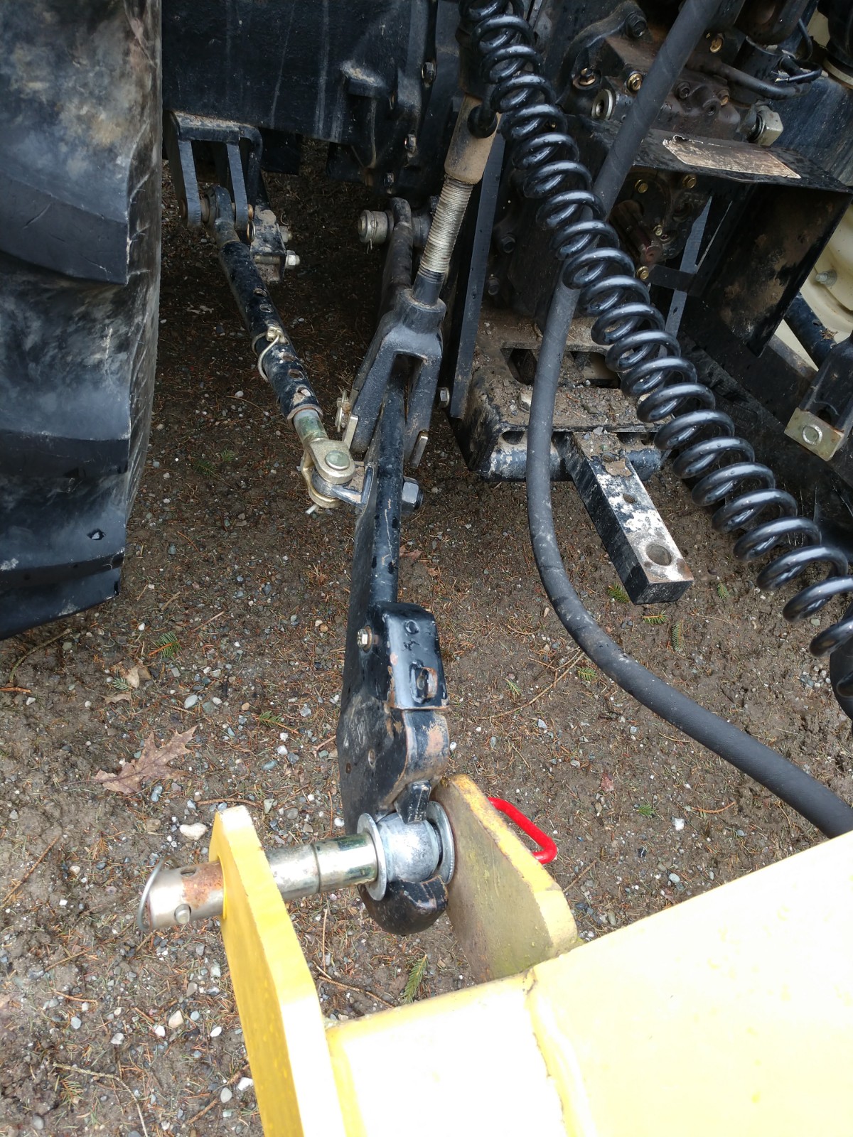

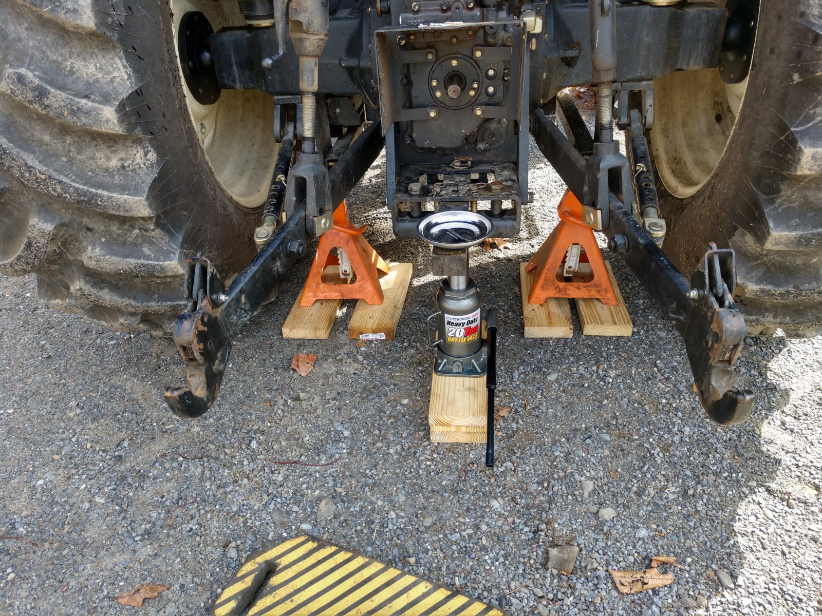

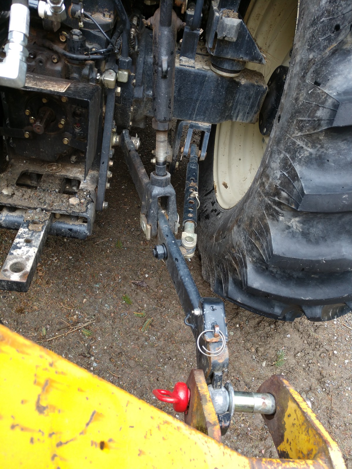

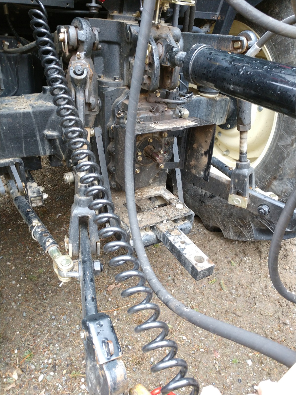

I would recommend going a different way;
adding ball hook ends to your lift arm.
Weld-on Ends | AGRISTORE USA
A member on this site also sells them,
this thread starting at post #32 goes on to show and talk about them;
https://www.tractorbynet.com/forums/kubota-buying-pricing/390265-quick-hitch-3-point-extendable-2.html
And this thread;
https://www.tractorbynet.com/forums/attachments/384881-3ph-lower-lift-arm-quick.html
These are mine, back up to the implement, lower the 3 point and back into it, lift just a bit (I have a lift button on the fender makes it even handier), hook up the top link and go..
