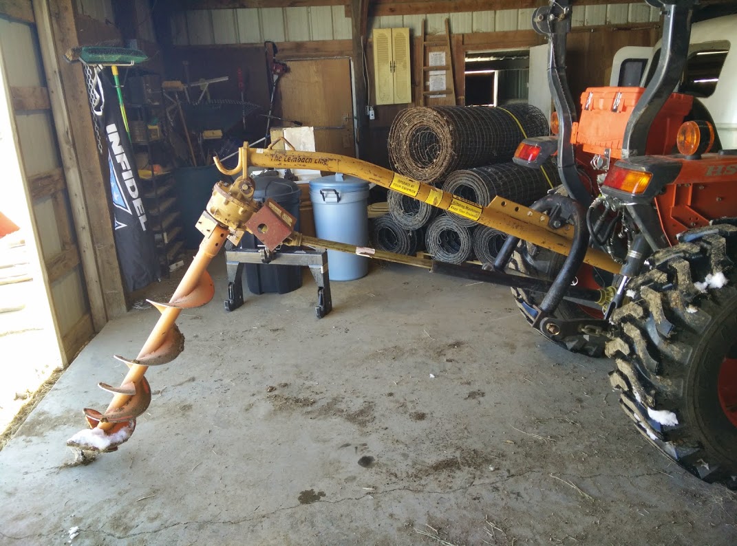

What I think you are referring to in the picture is the left side lower quick hitch attachment point. The drive line problems were solved by changing the top link travel. I also determined you can have down force pressure by raising the 3 point to max height and extending the top link. I can actually lift the rear tires of my tractor off the floor.
I did dig several holes to day and all went very well.

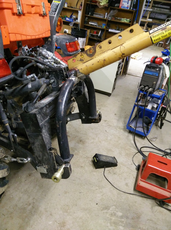

How long is your boom from the QH to the gearbox pin?

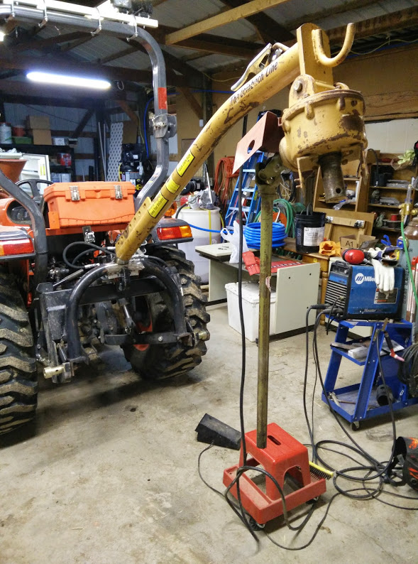

I chopped up my PHD this morning. Tacked the boom on the first time & found I didn't have quite enough height. Ground off the tack & got the height setup nice with the bottom of the augur a foot off the ground & the gearbox hitting the floor when it's down.
Now I'm looking at my PTO shaft being significantly to short, maybe a foot and a half.
I cut off about 8" of the boom & there's normally about 2' or so of boom between the arch & the top link hole, so it's not really surprising. I'm either looking at a 18"' PTO extension or trimming about 18" more off the boom. I figure at the moment I have at least an extra foot of height range if not more, so shortening the boom isn't going to kill me there. I haven't sorted out the PTO angles & interference yet, but it looks like it might be close to hitting at max height, which is another reason to look at a PTO shaft extension, it would eliminate any potential problems there I expect.

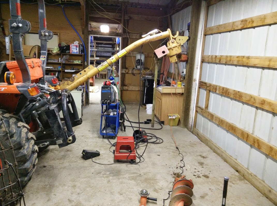

Before I started... It always drug on the ground, but I didn't get it setup right when I hooked it up to bury a chicken so it's lower than usual.
How it's sitting now when I came in for lunch & to think about it. The arch actually rests perfectly in the toplink hook, I just had to cut off the ears that formerly attached to the boom & grind down some of the braces a bit.
My boom is 4' from the gear box pin to the yoke where it is welded. Then there is an additional 8" from the weld to the front of the QH.

My boom is 4' from the gear box mount to the yoke where it is welded. Then from that point to the front of the QH is an additional 8"
Your hook up is some different than mine but the principal is the same. Another thing you might need to consider doing, with the 3 point hitch raised all the way up and the top link extended approximately 4", change the angle of the boom where it is tacked to the yoke down to the point of the auger point is 3 to 4 " off the floor. This will help the drive line clearance.
   / Quick hitch for a 3 point hole digger #36
Thanks, will probably just trim another foot or 2 off the boom then, think mine was at least 6'. I was setting the angle before I tacked stuff by dropping the 3pt all the way the running the toplink most of the way back. Wasn't paying too much attention to PTO anything at that point, just getting clearance so my augur wouldn't be dragging finally. I was actually planning on welding on some extensions to the arch before I saw this thread.

Here are some more tips for your set up. Some of this I had to learn the hard way.
1.After you have established your height... mark this position on the boom where it will be welded to the yoke.
2. Remove the gear box and lower the boom tip onto a flat table top
3.Make sure the the 3 point hitch is level to the tractor and the floor.
4.Place the boom end on a table, but the boom up to the yoke, and align the marks on the boom and the yoke.
5. Measure from the end of the boom to some point on the lower QH attachment point. This will square the boom to the tractor.
6. Look at the end of the boom that is setting on the table and be sure the end is setting flat on the table and IS NOT twisted. If this is not perfectly flat and level with the 3 point the auger will not hang plumb and your holes will not be straight down.
