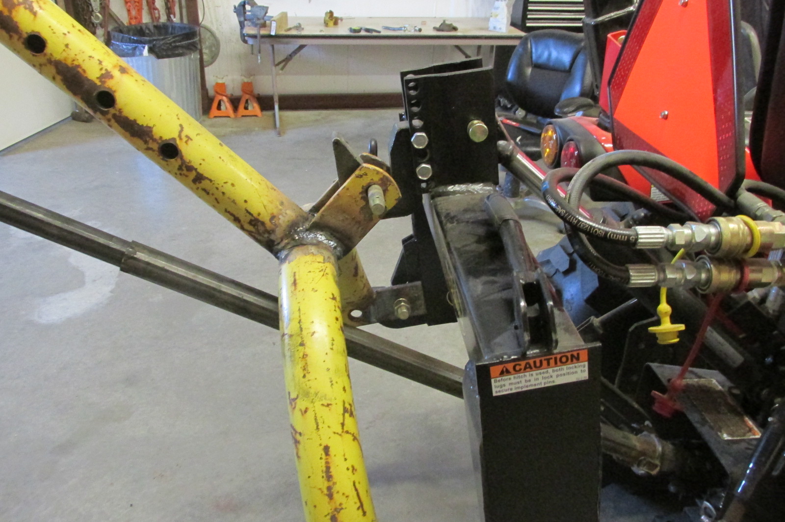

Brace as you describe will definitely strengthe it, but what about restricting access to hook up PTO? QH is hinderance itself without adding more to it. I was thinking flat stock drilled for the top pin then welded to the current pin clevis, running back to the last hole or farther and welded to the boom, then could put some cross braces on that at each end.
You won't down pressure just with the top link, the lift arms still pivot upwards on mine even with decent knob closed tight. It would require a second cylinder or fab a cylidner attaching point on the boom behind the arc then extend that up and forward so it can connect to the top link cylinder above the QH. You would have to remove the cylidner pin at the QH and connect it directly to the PHD boom so it pushes at a point behind the 3pt arms and lift arc.

I will take a look at your bracing method. Probably work better than my application.
You are correct in the fact that you are not able to have down pressure using the top link as the source. I tried it and like yours the draft arms pivot up even with the flow control valve closed. I have another idea that I will try today. Hopefully it will work. I will post the results if it works.

Your brace idea will be stronger, especially for lateral movement. Hang the gear box back on it, then tape string line where you are planning the brace and see if it is going to hinder room to get PTO on & off.

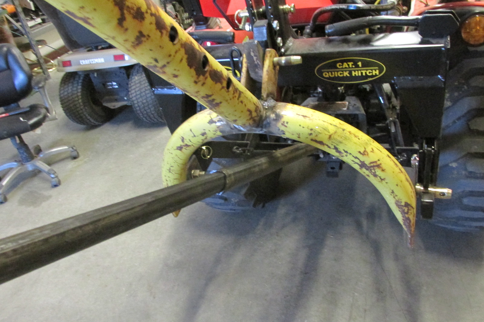

Run into some trouble with the drive line clearance. Have to work on that problem. All other problems have been corrected. Range of motion is accomplished with combination of the 3 point control and the hydraulic top link.

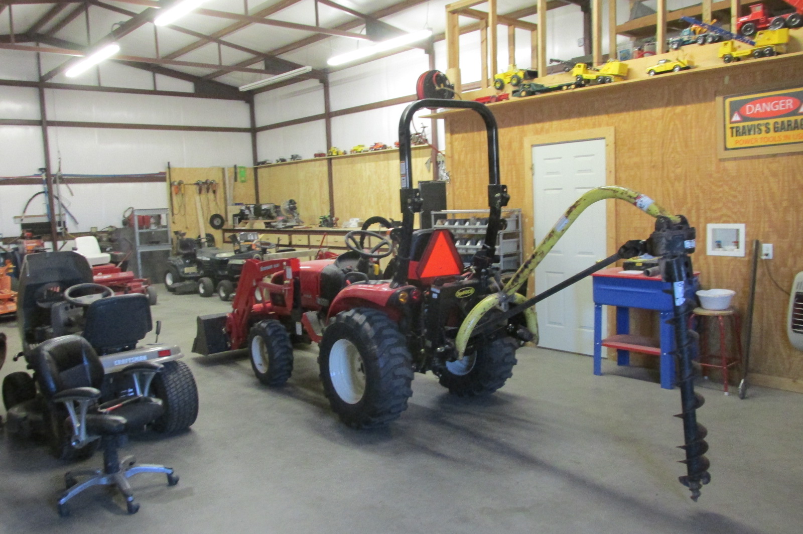

My project is successful. I have a 3 point hole digger that will hook up to a quick hitch.
In testing in the shop
1.Range of motion excellent.
2 Can lower the gear box to touch the floor
3.Raise gear box to 6 ft.
4.Drive line problems solved.
5. Will give it a dig test tomorrow.
6. Will try to get a video.
