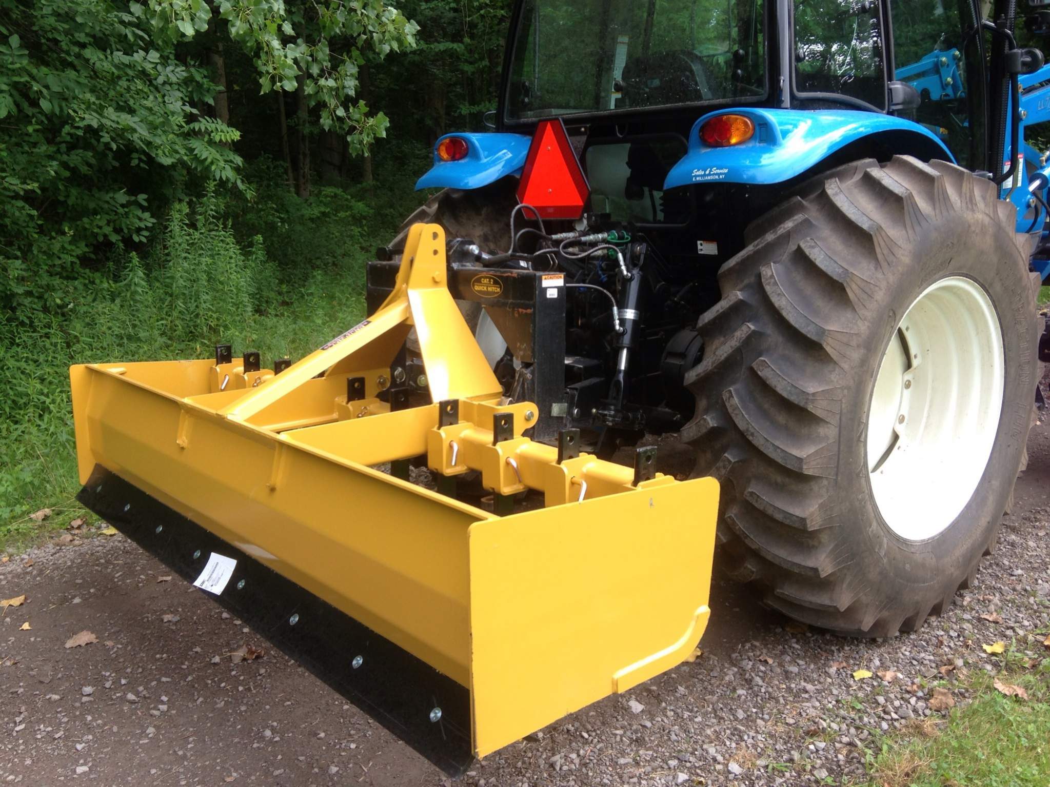

I have a Speeco class 2 QH, paid 199.00 at Blains. Land Pride makes one and I was quoted $650 so I went with the Speeco. Woods has a QH that is a rebranded Speeco, but at a premium price.
The hitch weighs 134 lbs and is rated for up to a 100 hp tractor.
