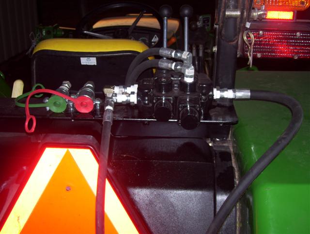

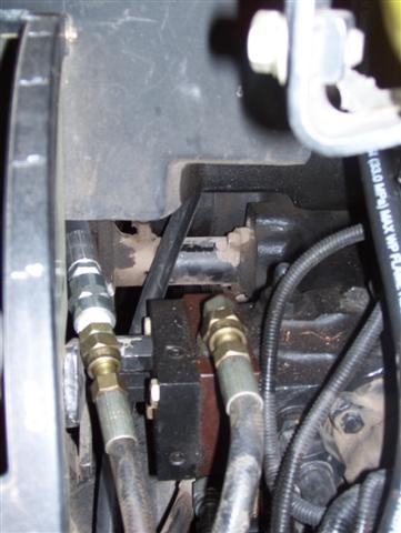

So far this is what I have. I purchased a 36" piece of 4x4x1/4" angle iron and cut out an area for the fuel cap and diesel tank. I'm debating if I should turn the valve towards the fender to move the handles away from the seat. Still have to get the fittings and hoses although I'm still unsure what size fittings are on the PB and Tank port on my FEL joystick.
A shot of the bracket and spool valve painted up.
Bracket and spool valve mounted.

The tough part is done. Nice job. I would put the hydraulic connectors directly onto the spool.

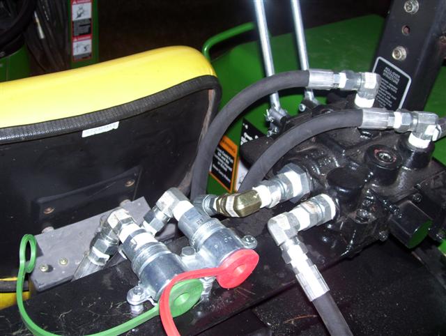

Quick question. I plan on mounting two of the couplings directly on the valve with some 90's. I'd like to run the other set to another location with the break-away's. Would 3/8" hose be sufficient? Currently the power beyond circuit from the loader, and loader hoses are 3/8". So, 3/8" would essentially be feeding this valve from the loader joystick power beyond circuit.
I would think 3/8" hose to feed the rear remotes would be sufficient correct? I would think if I increased these hoses to 1/2" I would reduce pressure.
Also, to those who mount these directly to the valve, do you worry about an implement coming un-hooked and tearing apart a hose? I'd like to have one set setup with the break-away mounting to prevent that. I would think it would tear the fittings right off the valve? The couplings I have are break-away units where they will hook up whether you release it, or push it straight in.
/ Quick Connect on tractor (mounting) #6
3/8" hose will be fine for the PB loop to the new valve since that's what's existing.
To feed the QD's you may only need 1/4" hose depending on what you are going to power, if the implement just has one cylinder then it will not need a lot of flow.
The breakaway QD's are not a bad idea.

How did you mount the couplings to your ROPS? I plan to mount 1 circuit directly to the valve, adn the other on the breakaway clamps with breakaway couplings.
Being a Kubota I guess it doesn't matter if you drill in the fender, but this is a John Deere. :) Just joking on that matter. I thought about that but for some reason decided against it, have no idea why. It would have been the easiest and not too late to do so. I wanted something I could remove later if sold without having any flaws I guess other than 2 holes in the ROPs.

I may just be paranoid. I suppose it's no worse than the loader hoses being right in front of me, or sitting right on top of the power beyond block. I got the couplings mounted today and not just need to plumb the in/out and power beyond ports.

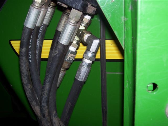

Well, this past Sunday I finally got around to completing this project, although not fully complete. I still need to finalize how I'm going to permanently strap the hoses and get a 90 for the In. I thought I had one, but didn't so I just hooked it up so I could at least get it work. I don't like the hose running over the fender so as soon as I get the 90 I'll clean that up and tie it in with the Out hose.
One thing I will say is that the break-away couplings are a great deal to have. It eliminates the need to hold the coupling to put the hose in. You just put the hose in and push it and it connects in easily. To remove you just pull the hose out.
