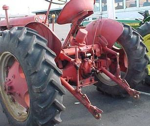

The only thing different in the european version (from ours) is that the arms have the hooks and not the holes. So no problems with attachments, as the arms & top link function just like ours, only ease of use. I've asked myself for years why we still continue with this system and have come up empty. Perhaps some of you may have the answer.
/ quick attach #12
Here is a picture showing the euro three point.
/ quick attach #15
Looks to me like if you just add Pats easy change type QA to the lower arms you have basically the same setup.
Not exactly, in that Pat's adds 4-6" to the length of the arms and consequently less adj in the top link. Wouldn't be cheaper to buy the arms?
