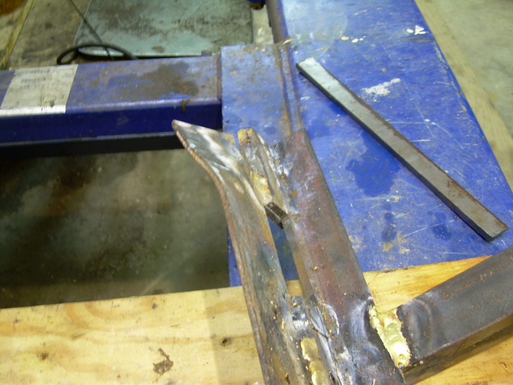

I took pictures of the top and bottom pieces. I picked up a brass rod today and did some brazing. So some of the welds are copper colored. This is OK, but I did not know it was brass and I don't know how to braze. It seems to work OK anyway. That stuff sure melts easier than steel and it is just as strong.
I used a piece of rebar for the inside lip on the top piece. See picture 007.
I made the bottom piece extra wide to support twisting loads and to protect the front plate on the PT. See picture 006. This is kinda hard to see. It is a flat plate welded to the angle iron.
I made the slots for the attachment locking dogs too wide on the bottom piece. I will probably have to weld something back in. I miss the MIG welding, but maybe with a little more practice the gas welding will go easier. It seems kinda slow, and you have to heat the part a lot.
Bob I know that you are still working on this and that you will check out the plate watching it as you curl it up and down but I thought that I would mention it just in case. If when you curl it down that lip on the outside might hit the lift arms and put undue stress on those ball ends. Also watch your hoses that they don't get pinched and cut a hole in them. I know you already thought of this but just a reminder.
Toy, I had not thought of that and the bottom plate got bent the first time I used it. I thought it got caught on the ground, but I can see that they were bent from hitting the arms. Thanks for catching that. I will cut them off next chance I get. I will check the hoses tomorrow, looks OK though. Strange the plate bent and broke, not the weld. My welds are not the best. I can see I need to use the next size up tip though according to the instructions I am using the correct tip now. Fortunately Jim of J and S Enterprises included the needed tip (#2.5). I got tired of waiting for the metal to heat up and finished the project with brazing. Brazing is a lot easier and just as strong.
I finished the assembly today and used it to pick up the front of the tractor and moved a good size log around. I think it will be strong enough, but I am going to put a strap across the top from the 2 inch receiver to the back of the top bracket and another one underneath the receiver to the bottom bracket forming a triangle. I ended up cutting the receiver shorter, and I could have cut it to take the place of the top strap. No big deal, maybe next time.
I have used all of my gas for the torch and am going on vacation for about 10 days, so that's all for now. I have attached some pictures. The first one is of the bent bottom plate.

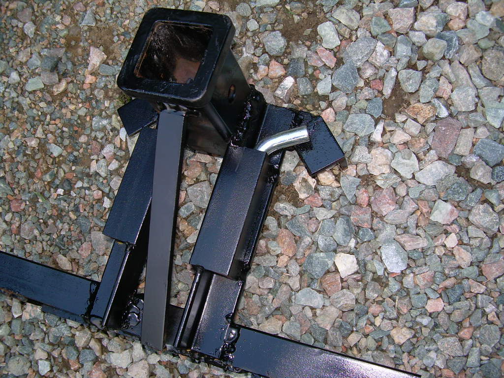

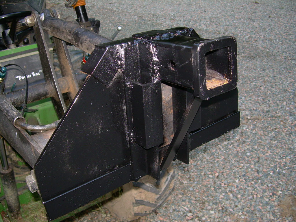

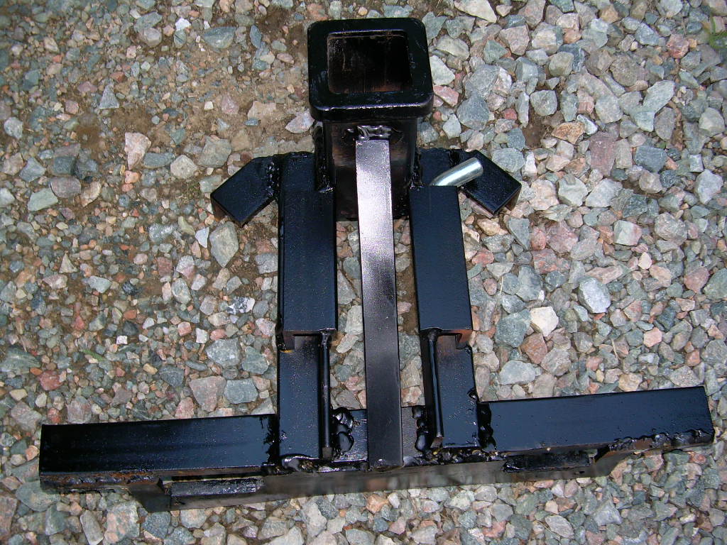

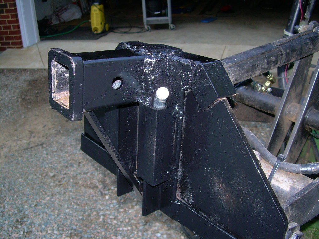

I finished painting the 2 inch receiver plate. I have attached pictures. Please note the holders for the pin. I have a pin in the left one, but there is also a holder on the right.
I still need to weight this and the other receiver plate.

/ Quick attach plate light, cheap and simple #19
Looks good, Bob. Now go out and beat the heck out of it to see how durable it is. :D
You getting more comfortable with that torch? ;)
#20
I like the torch now and can make a decent weld (better than my MIG welds) if I try hard.
I used the fire lifter with the attachment this week. I bent the fire lifter, but the 2 inch receiver held up well. I do need to demonstrate its strength. I feel it is pretty good since the angle iron uses the steel more efficiently than the flat plate of the PT quick attach plate. I will set up something soon, like lifting the rear of the PT.
