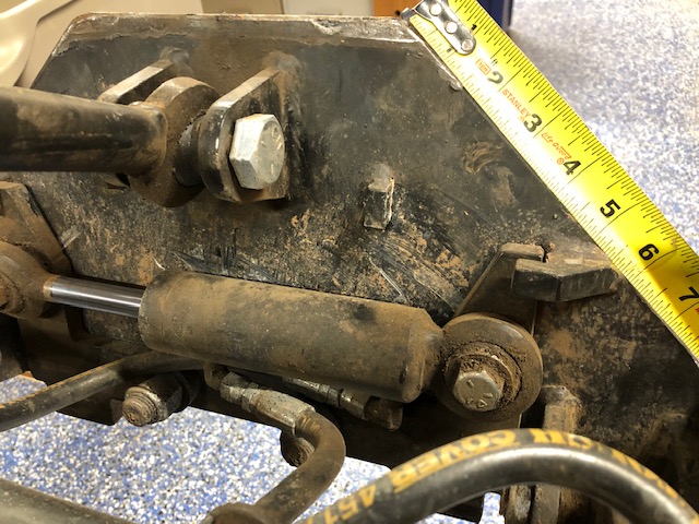

/ Quick Attach Not Coupling #26
sorry for the delay, had to take a business trip. Here's another attempt at posting a picture. My stop is set right at the edge of the QA plate while yours is inset a bit - maybe enough to cause the contact. Related to the cylinder bolt that makes contact with the QA plate, mine does that as well (you can see the contact arc in the photo.) IMG_1386.jpg

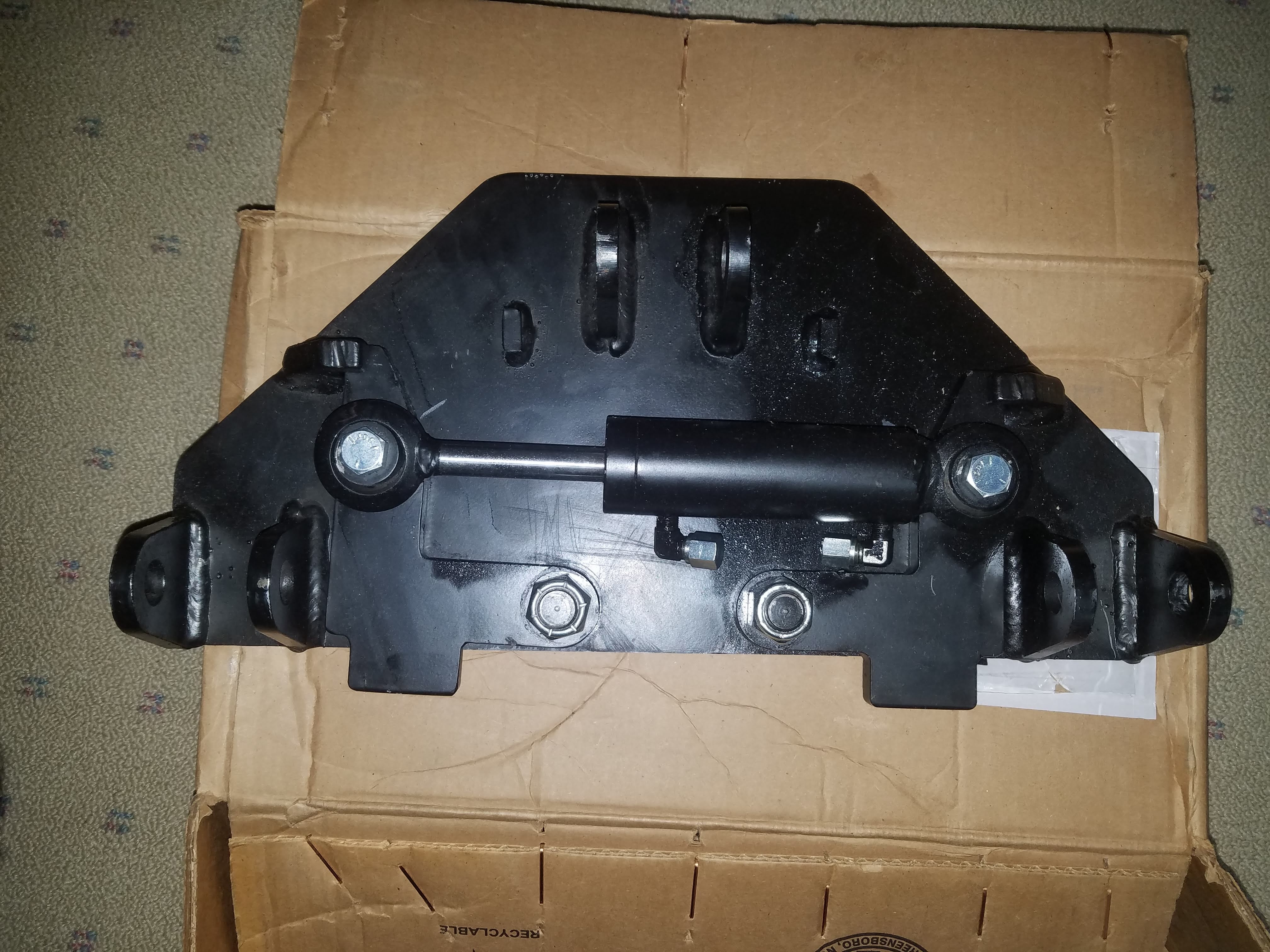

#27
I talked to Terry a few times and he agreed to send me the assembly - got it yesterday and still have to put it on when I find some time. I'll let you guys know what I figure out.
The current one 'works' after some heavy filing, though there are still gaps between the tabs and 'considerable' wiggle. I don't think the attachments are going to go anywhere, but they sure do seem to bounce around a lot.
/ Quick Attach Not Coupling #28
Glad they stepped up on the replacement. Keep it greased up well, and clean it as needed, especially the areas behind the sliding tabs. I spray that area out with degreaser after really heavy dirt use, dry it out with the leaf blower, and put some grease back there. Also spray those ball joints on each end of the cylinder with super lube each 8 hours of use, just like everything else. More frequently with heavy use.
