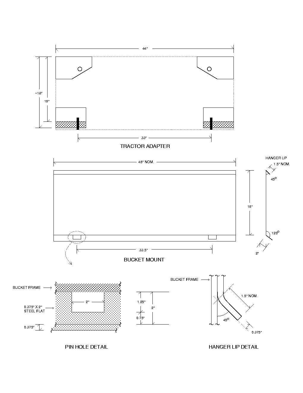

Here are the specs for the qa plate. I think I found these on the forum.
  • SSQA Specs.pdf
