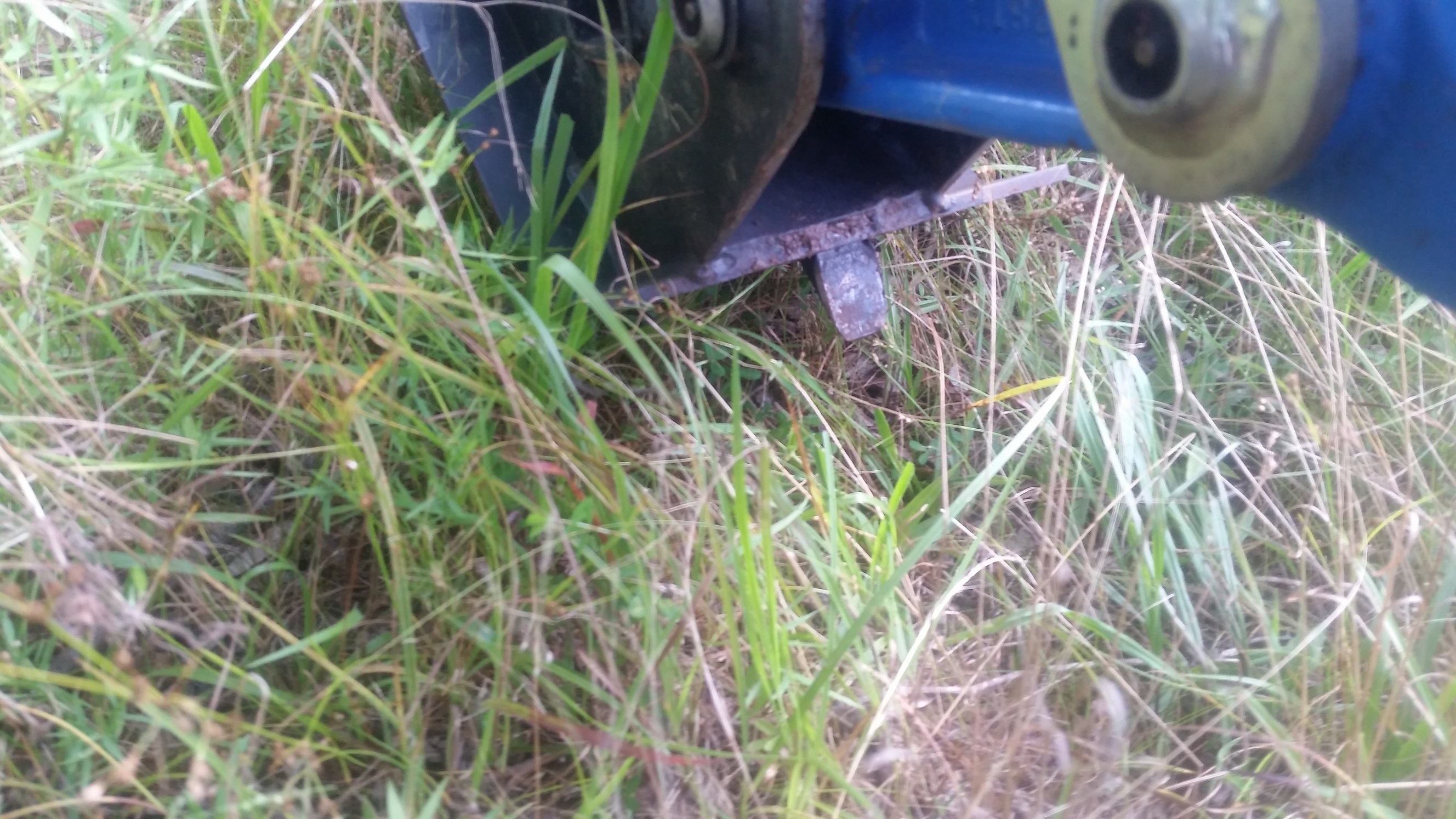

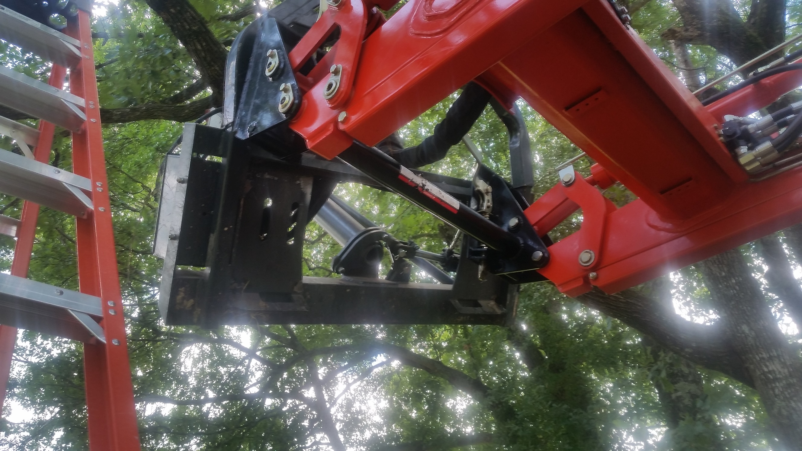

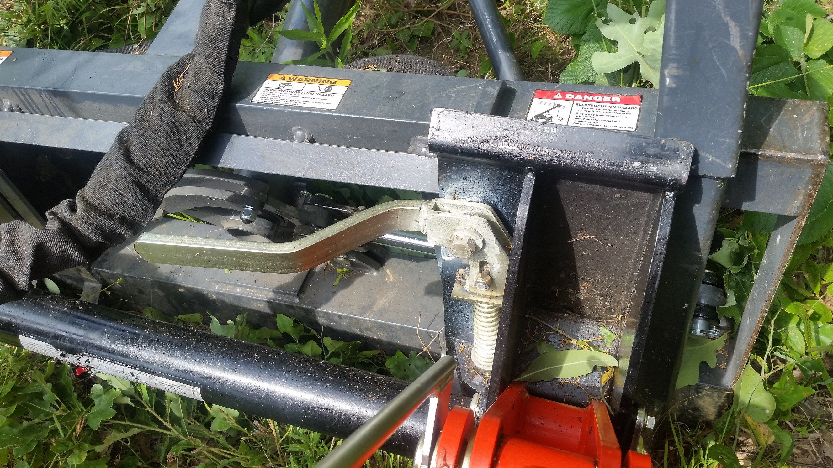

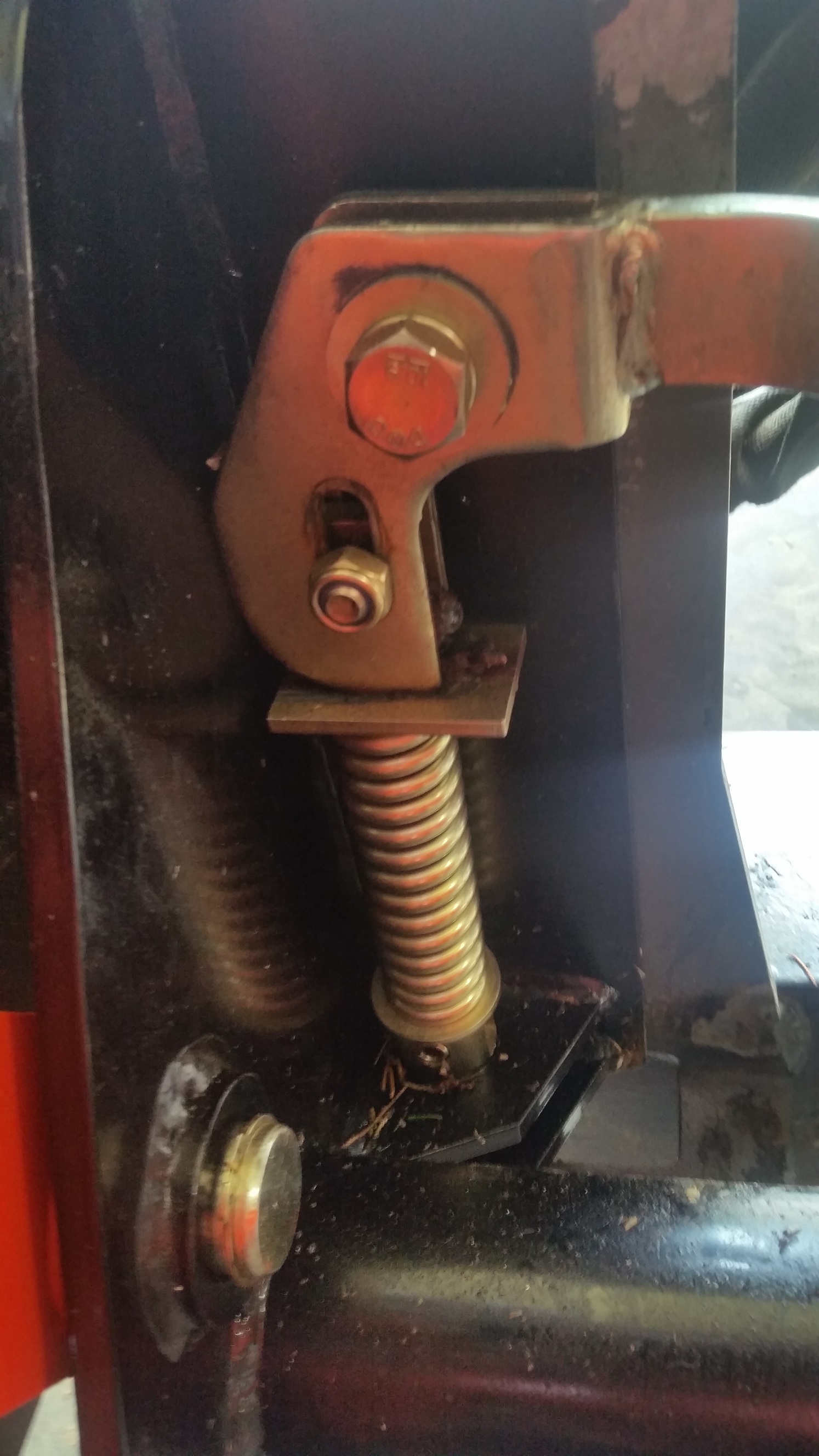

Here are some pictures of the quick attach, both with a tree shear attached and without:
With tree shear attachment
top view, fully engaged: 20200706_092338_engaged_top_view.jpg
top view, partially engaged: 20200706_092357_partially_engaged_top_view.jpg
top view, disengaged: 20200706_092408_disengaged_top_view.jpg
bottom view, engaged: 20200706_092951_engaged_bottom_view_with_implement.jpg
In comparison, here is my old tractor's quick attach engaged, no implement. (Sorry about the grass.) 20200706_143656_old_tractor_engaged_bottom_view_no_implement.jpg
No attachment present
bottom view, engaged: 20200706_143007_engaged_bottom_view_no_implement.jpg
Some pictures of the quick attach after the tree shear detached from the quick attach
cutting small tree at ground level: 20200706_112325_pulled_loose_tree_on_ground.jpg20200706_112325_pulled_loose_tree_on_ground.jpg
cutting limb well above ground: 20200706_134959_pulled_loose_tree_limb.jpg

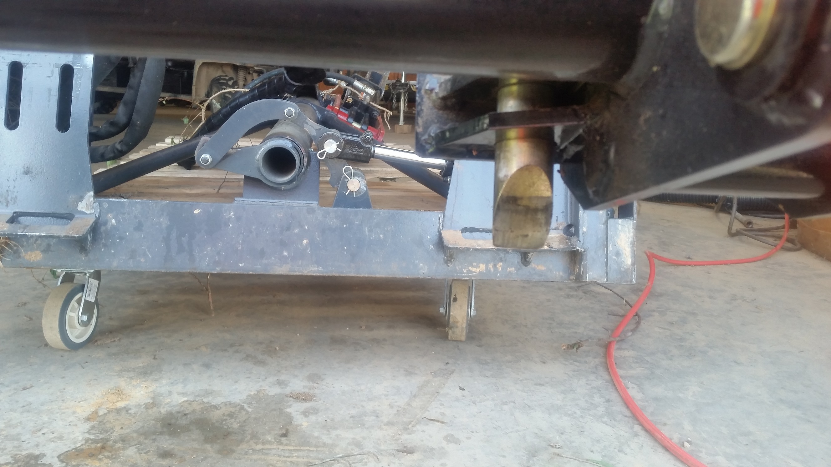

THE PIN IN PIC 4 DOSEN'T SEEM TO BE FULLY ENGAGED. THE ATTACHMENT IS UP AGAINST THE TAPER ON THE PIN. WITH ENOUGH PRESSURE THIS MIGHT FORCE THE PIN UP ALLOWING FOR DISENGAGEMENT. SLOT IN HANDLE WILL LET THE PIN MOVE UP ENOUGH TO COME OFF. SINCE THIS HAPPENS WITH DIFFERENT ATTACHMENTS, THERE NEED TO BE SOME ADJUSTMENT TO ALLOW THE PIN TO FULLY INGAGE AT THE BOTTOM. IMHO
/ Quick attach issues on an RX7320 #5
I agree. The Quick Attach pin is coming through the slot, but not nearly as far as mine. I suspect your latch is not locking fully into position, and its popping out as you use it. And your using the attachments mainly for pulling....which encourages the not fully locked attachment to pop out. Your photos show no damage that I could see.
I would attach a simple loader bucket, fully lock your QA latches, and then measure the length of the pins, exposed below the slot. This should be the proper length of exposed pin for each attachment you use. I would bet it's not the same for your grapple.

In your 4th picture with the pin just being half way or less into the slot,

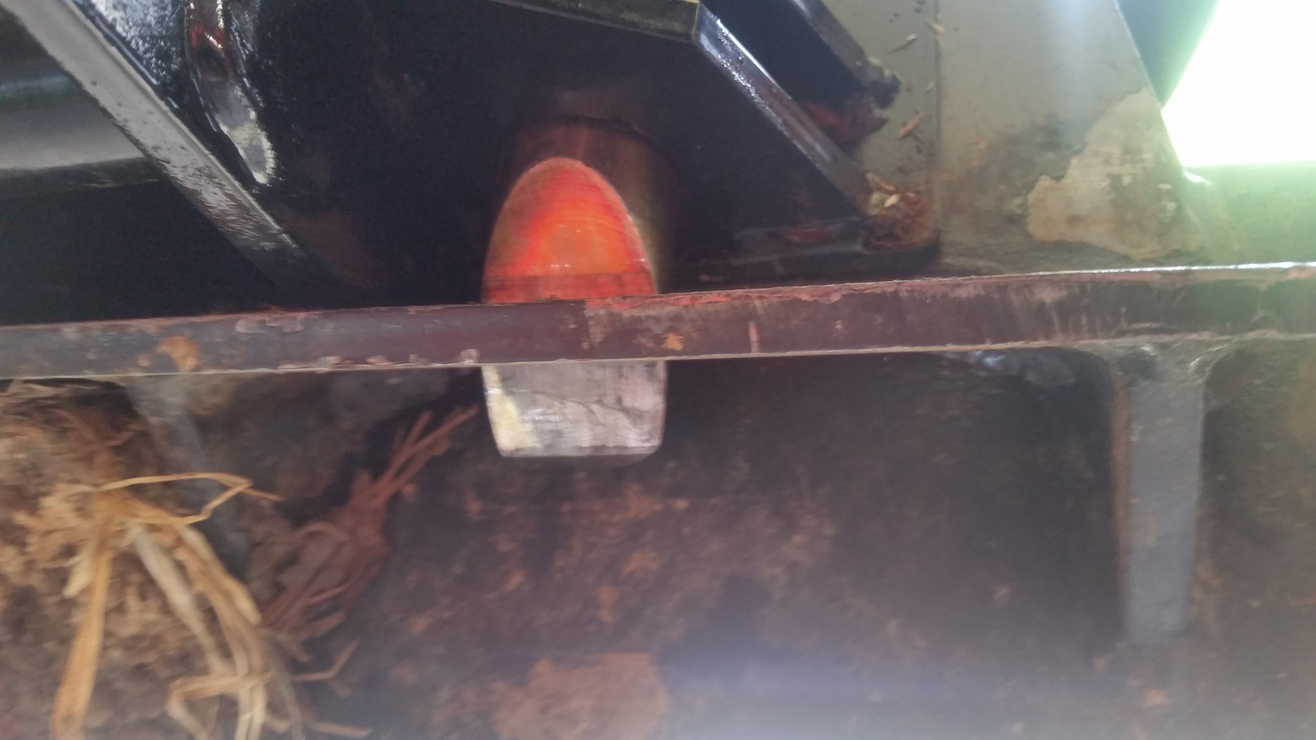

and then with I believe your 6th picture, the one with the implement in front of the SSQA.
I see possible explanations why you are pulling free;
You have a 70 hp tractor which has the capability of putting a lot of stress on what is actually a kind of light duty hitch system.
Looking at pic 4 you could add some flat stock to the top of the implement slot which would put more material higher on the tapered pin.
Also you could be flexing the upper implement mount, going in and adding gussets just inside of your mounting plates would eliminate any issue with the top separating.
Alternatively if the pin is being held up because the slot isn't deep enough and the pin will travel down lower or can be adjusted to drive lower.
In the 6th picture the implement bottom mount looks like it may have been flexing and could use some beefing up.
