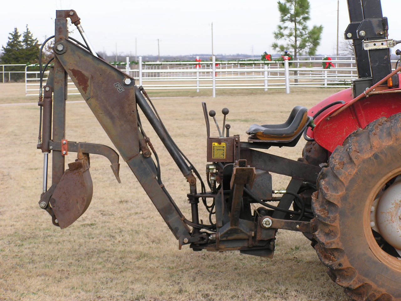

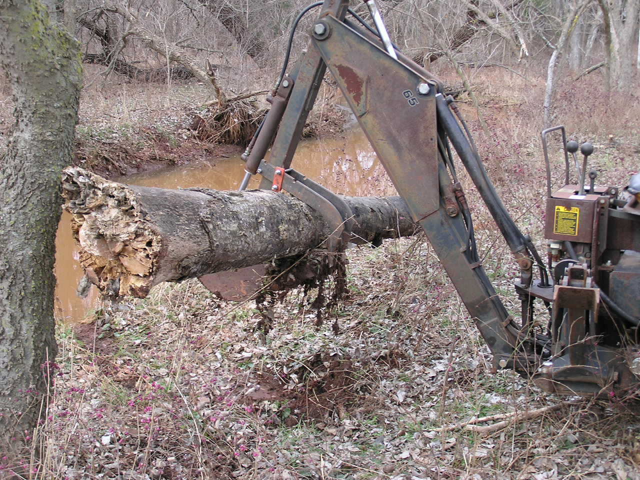

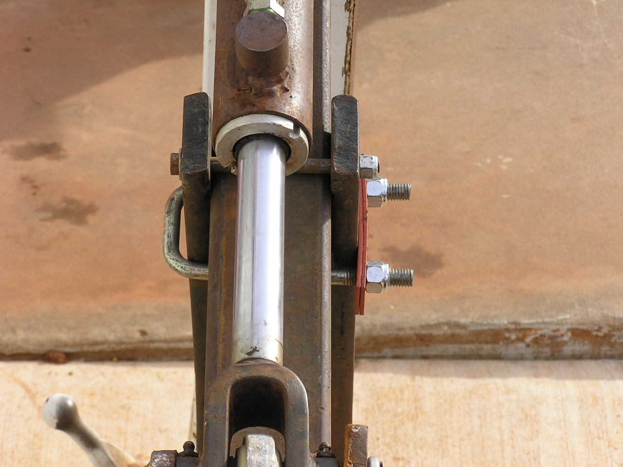

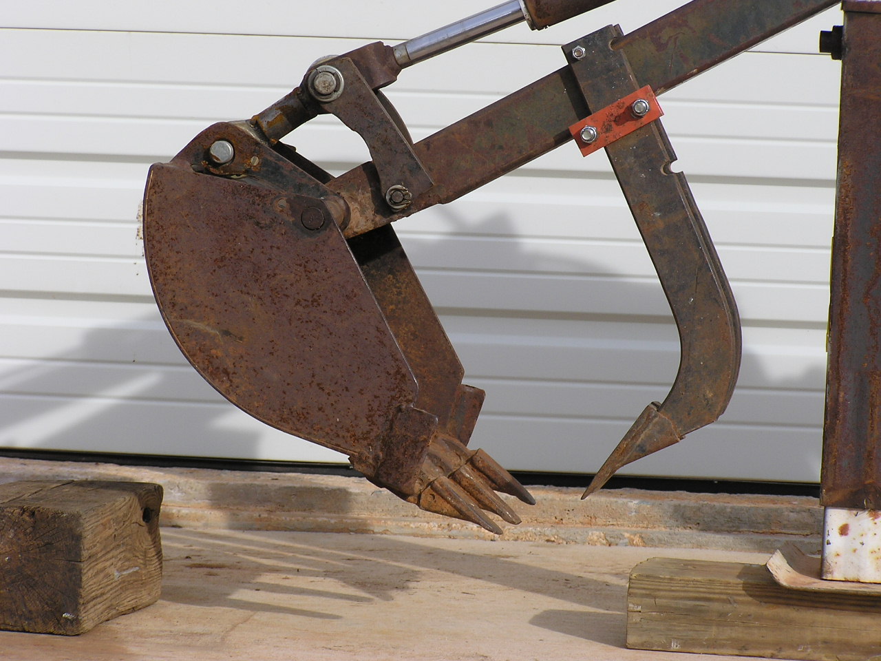

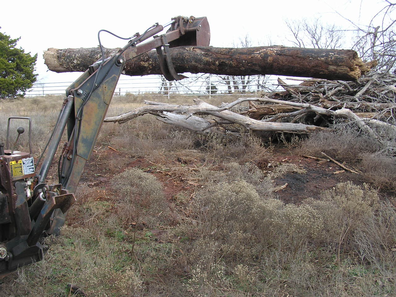

Another option if you have a trailer. Put a thumb on your backhoe, pick up the ties, load them on the trailer, haul it to the burn pit, unhook the trailer, put a chain on the tongue and dump it with the back hoe.
Even easier with a trailer ball on the bucket, and dump with the FEL.
I made a thumb for mine with two rippers.
