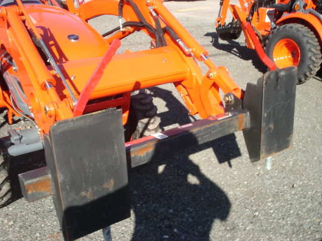

I'm considering getting the skidsteer plate to turn my ck35 fel into something that is a little quicker to change out buckets, etc. At the moment I do not have anything other than the bucket, but I'm going to be building a brush rake and other stuff pretty soon in the future. I figure if I can get switched over to some type of quick attach system then I'll build my new stuff for it instead of fitting it over the bucket.
Anyway, before I spend the money, are there any other systems/ideas out there that would be easy to adapt to my kioti, besides going the skidsteer route?

We carry the Skid Steer Adapter Brackets for the KL120/130 Loaders and the conversion plates for the buckets. It's a simple changeover on the loader side, and some welding on the bucket. Well worth the effort !!!!
The new KL130 Loaders (2009) are standard with the Skid Steer QA Bracket and Bucket.

The DK series bracket won't even come close to working.
I sell the quick tach (tractor side) for $549 and the bucket side for $159
