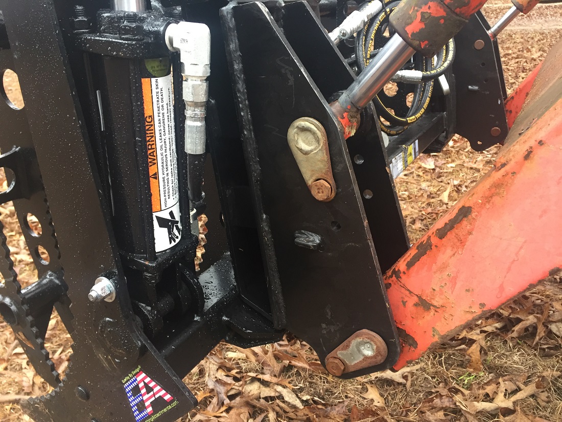

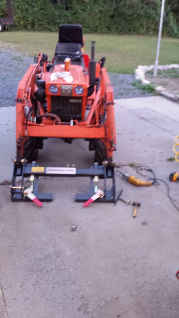

My quick assessment brings up two points of concern.
1. It looks like it will extend the center of gravity quite a bit, which will compromise all important lift capacity on a compact tractor.
2. Weight isn't listed and it looks somewhat heavy, which would be strike #2.
WR Long makes nice custom QA adapters and we sell a couple almost every day. They have more pin on loaders on file than any one company in existence and the quality is outstanding!
ATI makes some fairly lightweight adapters for compact tractors, many of which are well under 100 pounds to preserve lift. Prices vary based on loader model, but they're generally in the $800-$900 range.
Here is the page on our website: ATI Pin-on to universal quick attach adapter
Price for either will be better if you order with EA Pallet Forks or a Wicked Grapple, which is the single best attachment a tractor owner can invest in!
Travis

I switched mine out. I used the NH OEM parts. I agree with Ted about it putting the weight further out in front, that is a bad thing. Also you should not need all that adjustment. SSQA is an industry standard. Quality manufacturers will follow it so everything works together. Some off brands advertise SSQA but are not really so to spec that's when modifications or adjustments have to be made so it fits on the hitch plate.
Here is the thread about switching mine out.
