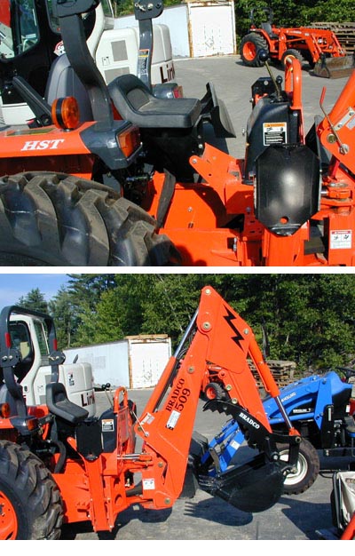

Bradco now has a mount for the L30s too. Attached is a picture of a Bradco 509 mounted on an L4630. Looks like a nice rig.
For all of you lusting after a cab model with Backhoe, I think this new Bradco mount will work on a cab. I took closeup pictures of this mount and of the rear end of an L5030 HSTC and I think the hoe mounts clear the cab mounts, and I think the seat is far enough back to clear as well.

I just noticed that the comparison in the Kubota literature is between the BH90 and the Bradco 408, where the BH90 does look better. But the Bradco 509 has significantly stronger digging force than the BH90. Based on this and the unavailability of the BH90, I think I will go with a Bradco 509 if I get a hoe. I'm quoted here about $7000 for the BH90 installed and about $7300 for the 509.
I'm also thinking I could fit under a nonfolding ROPs on the Bradco seat in your pictures.

Saw the Bradco 509 on a 3130 recently.
Didn't like the way it mounted on the new axle frames Bradco made for the L '30 Series; thought it protruded much too far to the rear of the tractor. On the old L '10 Series, the Bradco fit so close and tight you had to flip up the tractor seat to get it out of the way of the hoe seat. On the L 30 Series tractors, Kubota put a crossarm between the base of the vertical ROPs arms just above where the toolbox is. This crossarm is smack dab where Bradco's seat would go on Bradco's old L 10 Series axle frames. Bradco's solution was just to project the frames about two feet further rearward so their seat would be aft of the ROPs crossarm. Looks like much too much overhang and leverage to me.
The picture of the BH 90 in the 30 Series brochure shows the seat and operator tight up against the tractor. I do not know how Kubota overcomes the crossarm interference because I haven't seen a BH 90 yet.
So, my current backhoe preference has swung back to the BH90 on the theory that, even though Bradco may have a stronger and more aftermarketable hoe, Kubota's 9 foot hoe probably has the best fit and attachment design because they specifically designed it for the L 30 Series.
