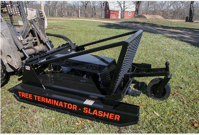

If you don't mind me asking, which brand of rotary cutter do you have?
