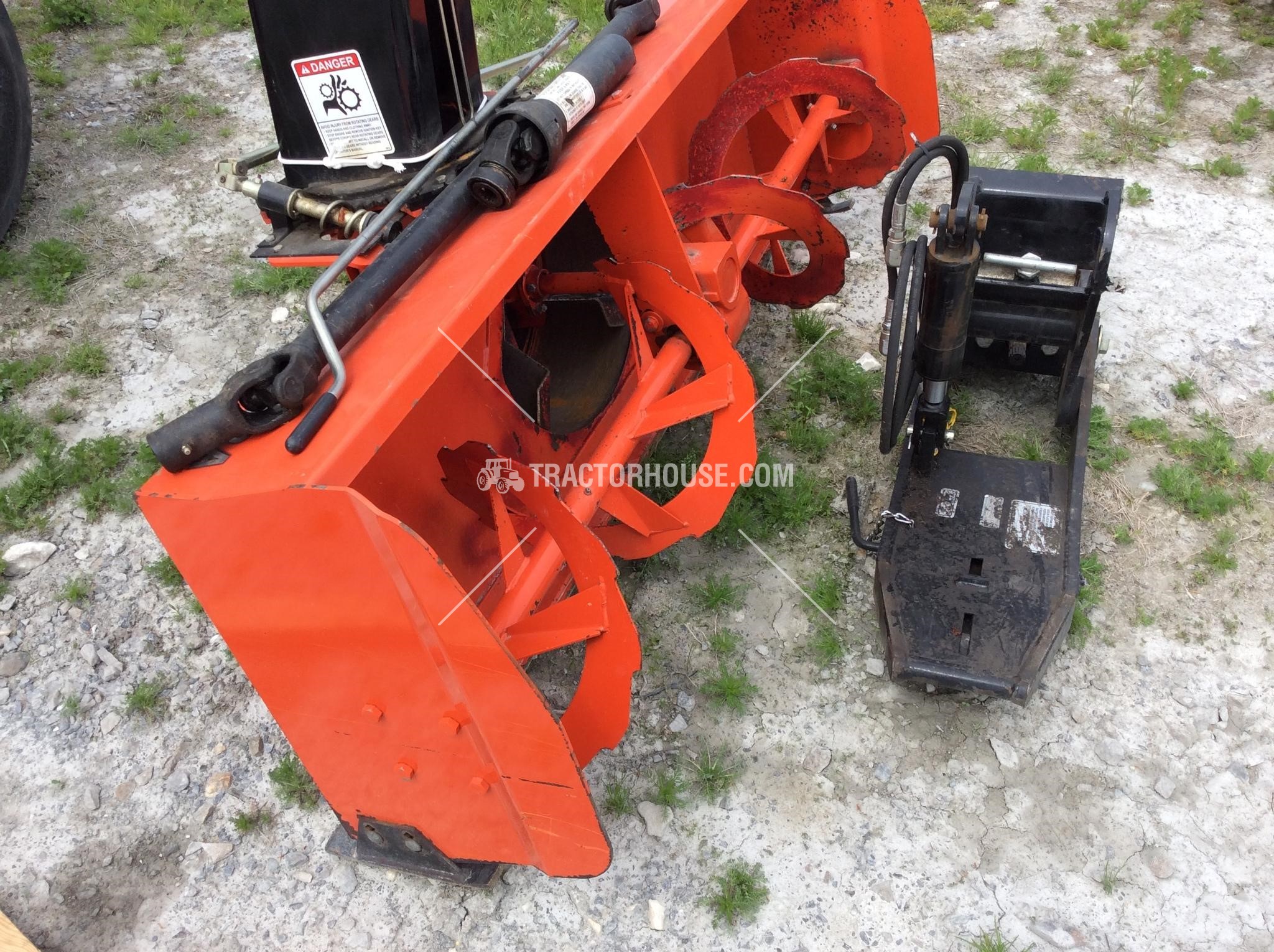

Looking at a Kubota B3030 and wondering what the feedback is on this model?
It comes with a 63" snowblower. Can someone tell me if it has a hydraulic rotation kit
that is listed on the Kubota site?
Any idea as to resale value on this blower?Has been used and has some rust and some

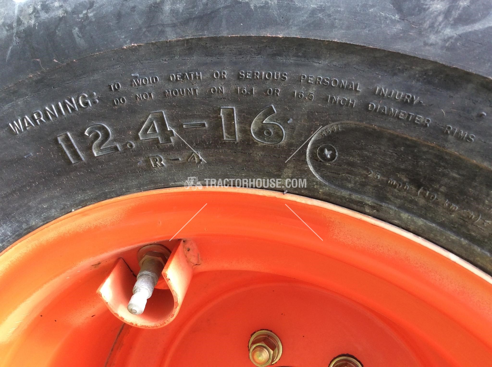

Here is a photo of the side wall of the rear tire. What is your opinion of the tire condition-checked, damaged?

Good solid Kubota tractor, how many hours? The snow blower in the picture you posted is a hand crank unit as you can see the hand crank on top od blower. The tires look ok to me, hydro kit can be bought to make it hydro rotation but it will be expensive if you don't install yourself.

Am I correct in assuming that it will simply move up and down the way this blower is outfitted-no side to side movement?

Yes the hydro lifts the snow blower up and down, the long hand crank will turn the snow shoot left & Right. And yes it's my understanding that any 30 horse tractors and above are tier 4, Def,dpf. Others will say that they have no issues with them but others will say they had many issues. I use to own 1 ton Diesel pickups all of the big 3, now I own a 2016 2500HD Denali Gas too many issues with them 1 ton Diesel trucks too, but each to their own, good luck tractor hunting.

Yeah, I was going to put one on my Kubota snow blower 10 years ago and the dealer wanted around $600.00 back then.
