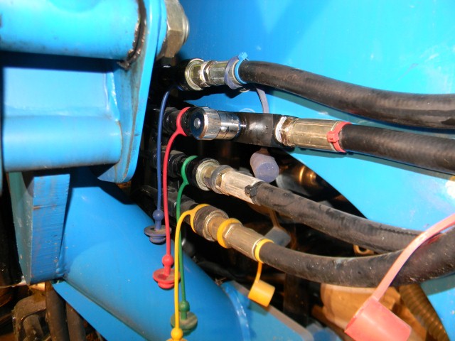

Sure, the "bucket flop" issue happens as you dump the bucket. At maybe 2/3 of full cylinder stroke to dump the bucket, it will "free fall". At that point it isn't being pushed by the hydraulics. It will just sit at maybe 80% of full dump and rock back and forth a bit. After a few seconds the hydraulics will catch up and then force it to full dump. That's my version anyway --------
   / question regarding loader control valve on my g3033 #22
On mine it seems like I get to about 90% then stops. A few seconds late it will move again and hit the bucket stops. Seems to happen more when the oil is cold. More pronounced as the hydraulic oil warms up. May try the flow valve too.
   / question regarding loader control valve on my g3033 #23
In my situation it gets worse and more annoying the faster that you try to work while at the same time trying to be precise. I just spent a couple of days cleaning brush and weeds from a homeowners lot and then loading the cleared brush into a 40 foot roll off for disposal. As I loaded the roll off, I would also compact with the loader as I loaded. I was trying to work quickly and precisely ---- the bucket flopping around didn't help. The longer I worked the more frustrated I became and the worse the problem seemed. Sooooo, I installed my flow control yesterday. The slow dump speed may frustrate me more than the flop ---- but, I don't think so. I can control the start of the dump; I can't really control the flopping. We'll see -------------
   / question regarding loader control valve on my g3033 #24

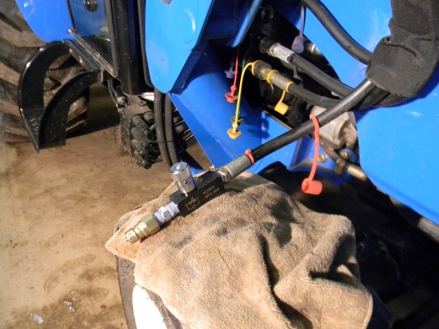

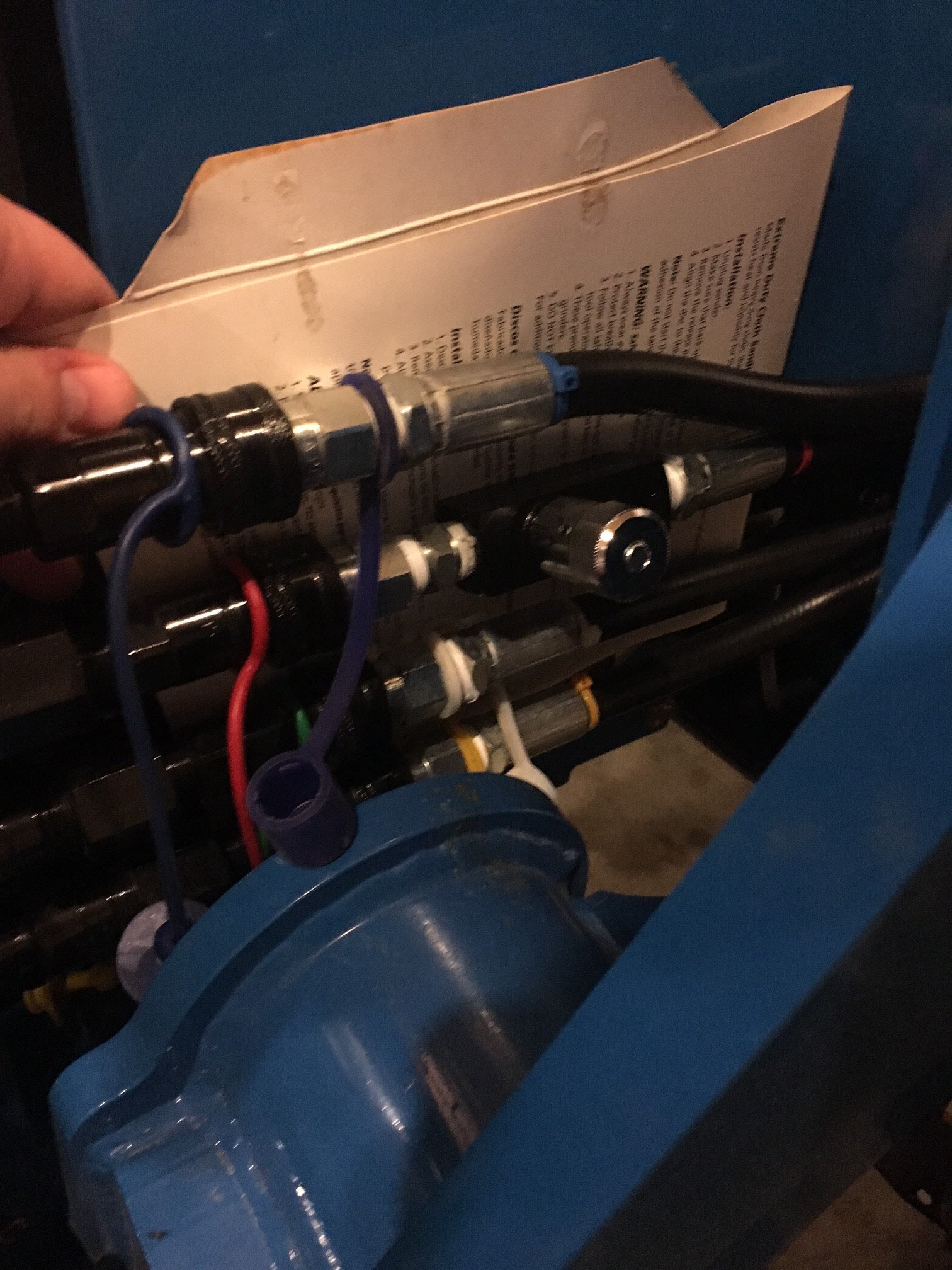

Just got it setup. Definitely an improvement with no noticeable flop. Here is a picture. I didn't realize that the flow valve is free flow in the curl position so there is no impact on curl speed.... Bonus!
MOJoe11,
Thanks for the info on this. I installed mine today, adjusted the flow, locked the set screw and it seems to have eliminated the bucket flop.

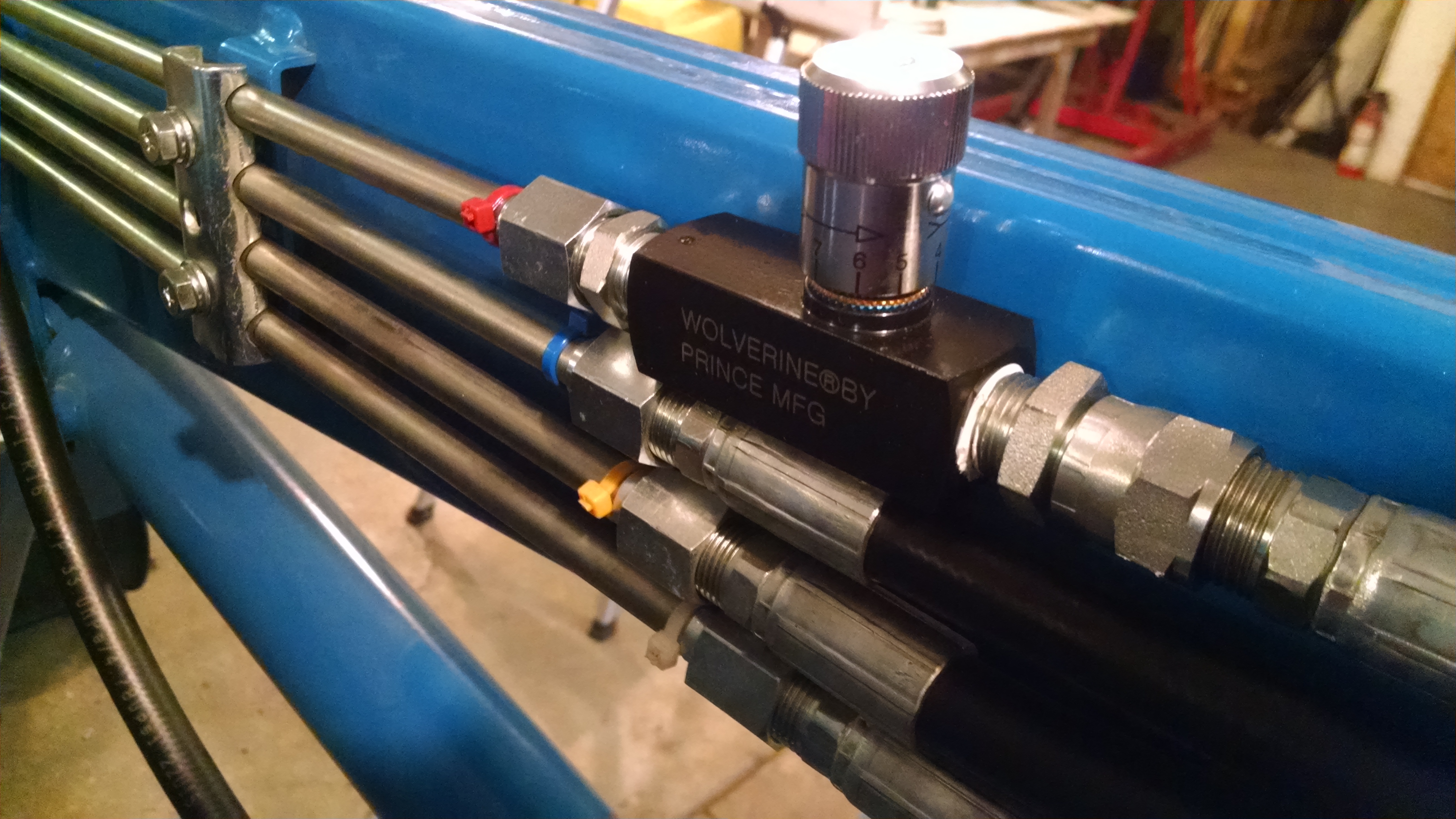

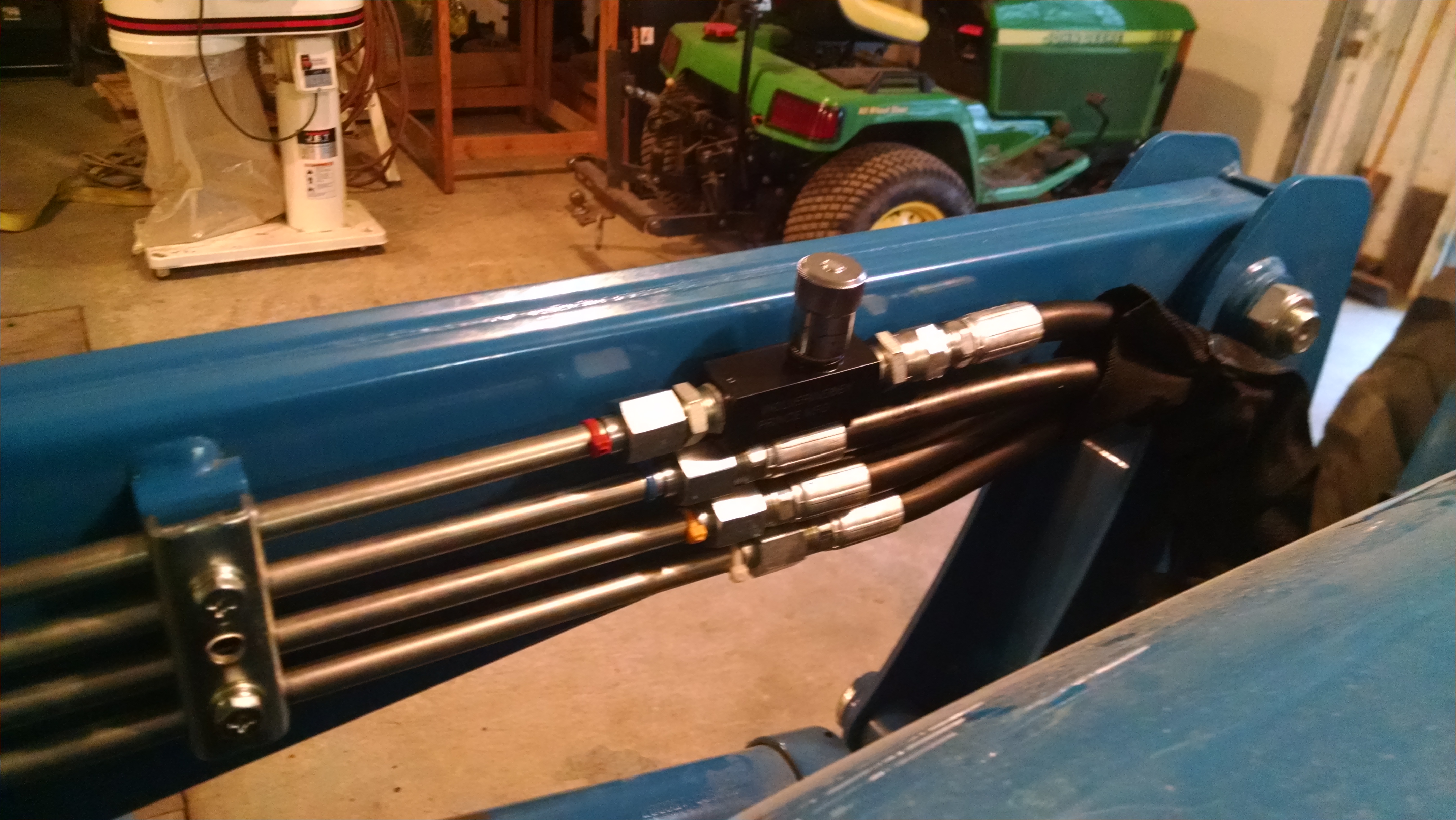

I too modified the bucket circuit with the flow control valve modification. However, I mounted it on the loader arm so it is more accessible when switching from the light bucket to heavy grapple. You will end up with a slightly slower bucket dump to control the flop.
Here are the pix:
Thanks for all the great info and contributions to this thread!
