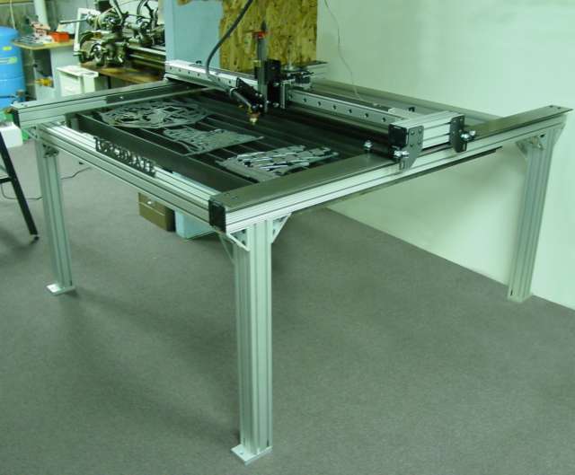

J J
Are building your own computerized Plasma cutter from scratch??
/ Question on plasma cutter #11
J J
No, I had ordered this computer cutting table about a year ago. It has to be put together and when finished it will look similar to the one below. All I have to do is add the plasma cutter and learn about G-CODE, and I have a spare computer. When finished, I should be able to copy a pattern, clean it up, and convert it to code and tell the machine to cut it. My Lincoln Pro-Cut 55 will cut up to 3/4 in, but as you go larger, there is a slight bevel. Laser is better and gives a more vertical cut.
The other pictures are the kind of things I would like to do. plus of course to build my own attachments.
I can also set my table up as a 4 ft table or an 8 ft table.
