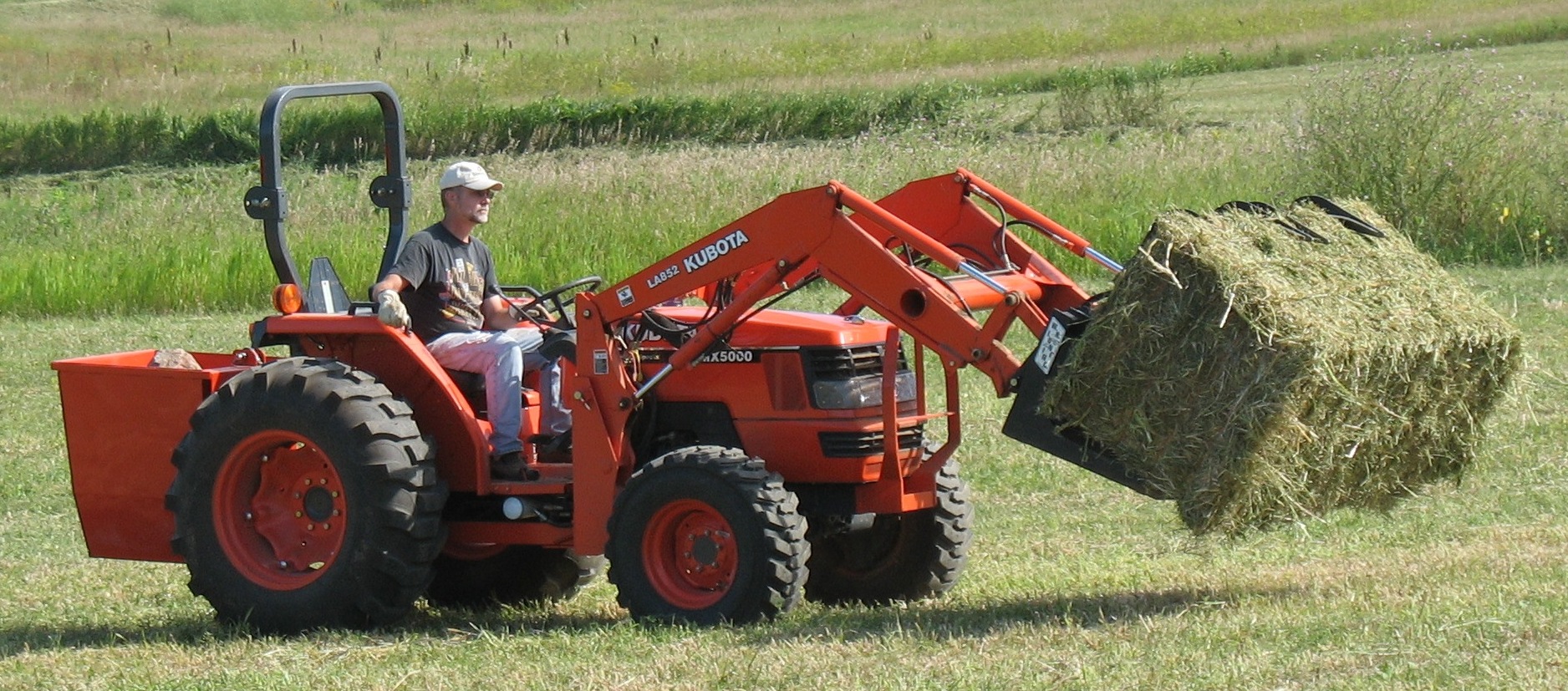

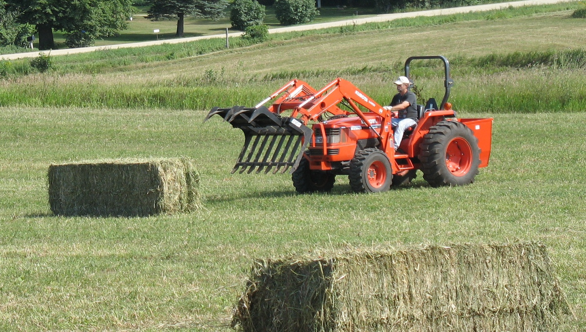

I am a small operation.
I buy the large bales and handle them with a L5030HSTC. Hay spike on the front to move them, then bucket with grapple jaw to "bite" a chunk off and then feed. Much easier to feed from the AC cab when its 100+ in the summer, and hip deep snow in the winter.

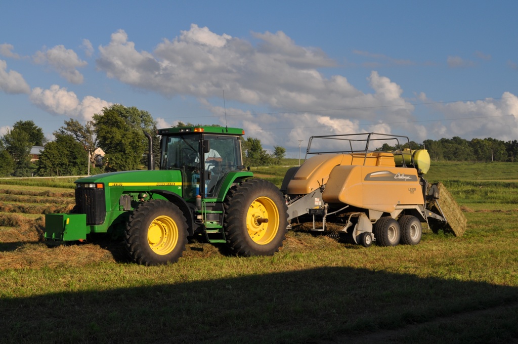

Here is what the guy uses to bale my hay. Tractor is 180hp JD8200. Glad this crop turned out OK. I lost the entire first crop because we only had 7 dry days in the month of June :mad:.

What is the tank on the back of the baler for? I've seen them going down the road, but never in operation.

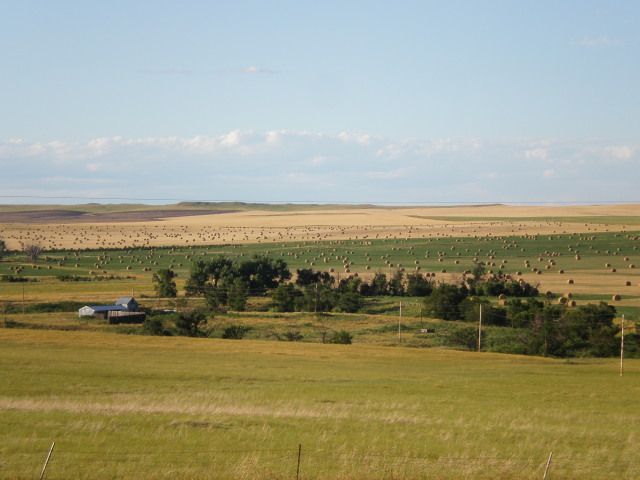

Maybe you don't feed or store all that much hay. Or, maybe you have more storage space than most people. I stole this pic from another website. How would you store this much hay?

Sorry, forgot picture.

I wanna see that shed. :D No doubt the big squares stack much better, though big rounds stack pretty well if stacked properly. I just don't know of anyone with enough room to store that much hay. The economics have to play a part as well. The difference in equipment to make large rounds is enormously different than that needed for large squares. Maybe they're more geared towards horse people, who aren't feeding nearly the hay that cattle farmers are.

The tank holds an acid solution that can be applied when hay has to much moisture. The solution is supposed to stop mold and decomposition.

Guy down the road apiece has quite few hay sheds. The hay in that pic would not fill one of them.
