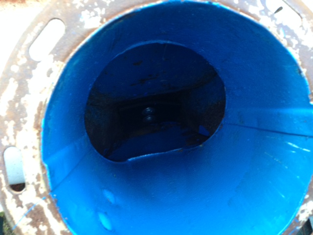

My chute was kind of rusty last year, kept plugging.....I sanded and painted the inside this summer, made a world of difference....hasn't plugged up this year yet.
