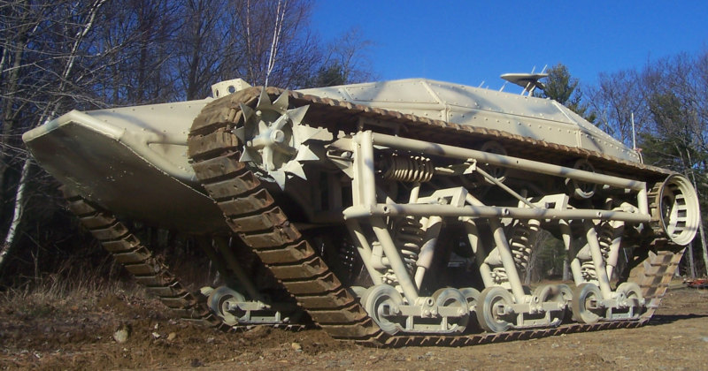

Jet500, drive sprockets on the front means that you'd have to put idlers on the back: When you need a lot of traction, the upper part of the track is tensioned, which also un-tensions the idlers. In other words, it gets hard to keep track tension.
Its better to put the drive sprockets at the back, so the tensioned distance from drive sprocket to where the track touches the ground, is minimal, and the unstretched part running over the top, is maximal.

ever consider a "Half track" would save a lot of problems in design,
one could make turning brakes on it as well to help in tight turns, like on a tractor,
