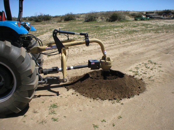

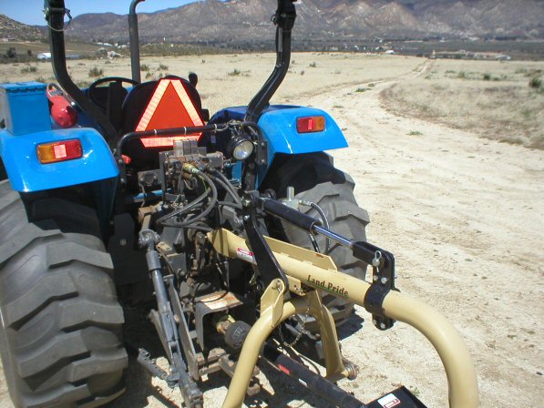

The cylinder extends exerting pressure down on the boom thus putting pressure down on the auger. As a safety feature so as to prevent any damage to the tractor or the PHD the down pressure kit is a one way hydraulic only and has a bleed off valve allowing hydraulic fluid to bleed off back to the tank any time that the 3pt hitch is raised or that excess fluid is being applied to the cylinder as is the case as you use the down pressure hydraulic while digging. The other thing that this valve allows for is that you can apply constant pressure to the hydraulic while digging giving you a nice steady down pressure. Doing this allows you to not have to be constantly readjusting the hydraulic as the auger goes deeper into the ground. You just pull the control lever that feeds the down pressure hydraulic and all excess fluid bypasses and returns to the tank while all the time exerting a constant down pressure. The way that the linkage is designed, the hydraulic is collapsed as the PHD is raised, the bypass valve is what allows this to happen.
I hope that this is a fair explanation of how a down pressure hydraulic kit works on a PHD. ;)

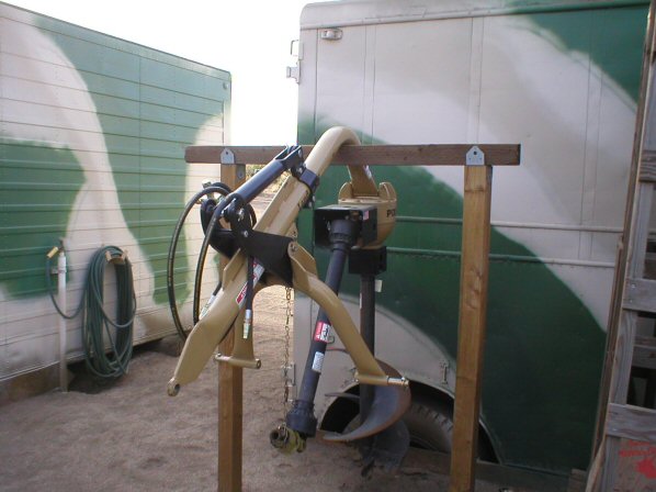

MtnViewRanch
Can you show a picture of your setup.
/ question about single acting cyllinders #8
MtnViewRanch
No problem, although I should probably should take some new pictures showing just how it works.
Here is a link to Land Pride that shows a good drawing of it

So that pressure relief line has to dump into the sump, can't return thru the remote coupling?
JB.
/ question about single acting cyllinders #10
No, because hyd fluid flows both ways depending on the lever position, and you might pressurized the back side of the relief valve. Relief fluid should always go to tank/reservoir with no back pressure.
Since you are using a remote two way spool valve, only one hose from work port A is connected to the cyl. The other outlet on the spool valve is not used. The one hose used for pressure can not be used for relief, and you can not use the other remote port for the relief.
