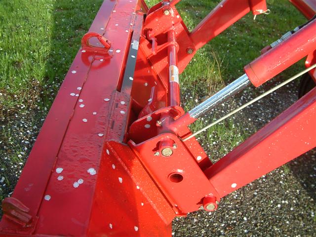

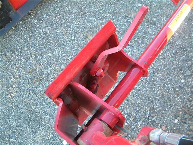

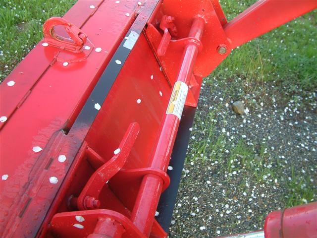

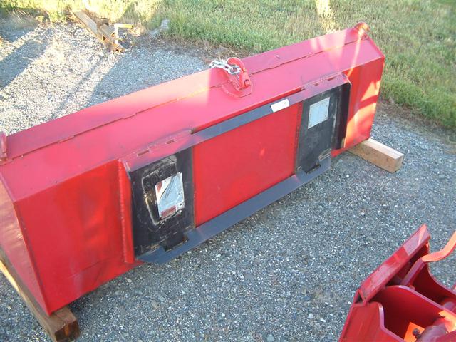

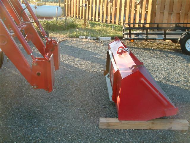

Here are some photos to give you an idea how the skid steer QA attaches to my Mahindra 5525. Mahindra provides the adapter that attaches to the FEL arms and accommodates the standard size QA mating adapter like the one welded to the backside of the FEL bucket. You can see how the adapter is designed so it conforms to the standard skid steer QA dimensions.
DSCF0110 (Small).JPG DSCF0112 (Small).JPG DSCF0113 (Small).JPG DSCF0181 (Small).JPG DSCF0182 (Small).JPG

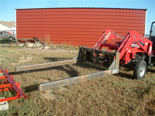

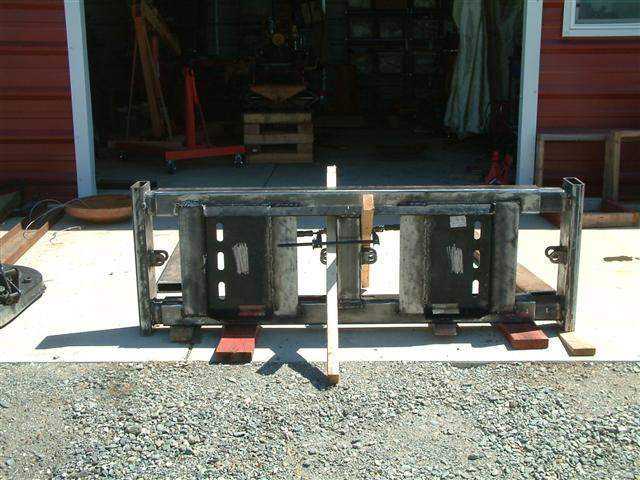

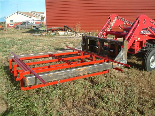

When I built a custom bale accumulator/squeeze last year, I found a standard size QA weld plate on eBay for about $80 plus shipping and welded it to the frame of the squeeze. Couldn't be easier.
