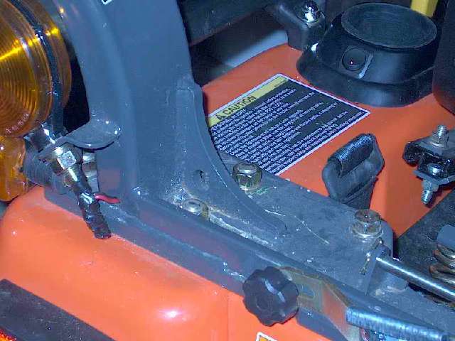

Rich,
You could put a switch where the cupholder is (see attachment).

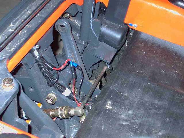

/ Question about installing aux lighting. #5
And then run your lights off of the aux. wire under the seat (see attached).
Also, the headlamps are only 24 watts a piece, per the manual.
Not a bad idea.Where did you get the power supply from?
The part I would like to avoid is running the wires up to the dash.I know it's not difficult, I'm just being lazy /forums/images/graemlins/grin.gif
Nice idea though,Did you use a weatherproof switch?
/ Question about installing aux lighting. #8
Under your seat is a red wire (I believe it also has a black stripe), which is used for auxillary electric stuff (i.e. lights). It's tucked in that black plastic tubing, so you'll have to do a little diggin to find it.
The switch is just a garden variety one from Radio Shack (not weatherproof). I've had it drenched with melted snow in two seasons without any problems.
NYYankees fan beat me to it!

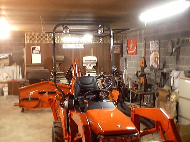

/ Question about installing aux lighting. #10
All good advice but I took a different route. I added 2 ea 35watt sealed Beam lights to the ROPS and ran the wire all the way to the dash where I used a pass-through splice to splice it into the headlite wire right at the switch. I wired in a separate 15amp fuse to this circuit also. I didn't want to splice into the tail lights as I wasn't sure of the current carrying capacity nor if any thing else was spliced into that circuit.
The twin 35watt lights put out enough illumination for me and the load to the dynamo/electrical system is very acceptable.
According to my BX23 manual, the ratings of the factory lighting is:
Headlights = 24W
Taillights = 3W
Total watts = 27W
Total stck lighting current draw = 27/12 = 2.5 amps
Adding two 55watts lights:
2 ea 55watt lights = 110watts
current draw = 110/12 = 9.16 amps
Added together, the total lighting current draw = 9.16 + 2.5 = 11.6 amps.
While twin 55watt lights will work, they in conjunction w/the stock lights get mighty close to the rated output of the dynamo which is 14 to 15 amps. They'll probably work OK but you may want to run the engine awhile after useing them to recharge the battery more.
Oh and btw, I've seen halogen ligts at Norhern w/a large magnet on the base. Supposedly it's strong enough to hold teh light assembly to any metal surface at any angle. They may be worth checking out.
